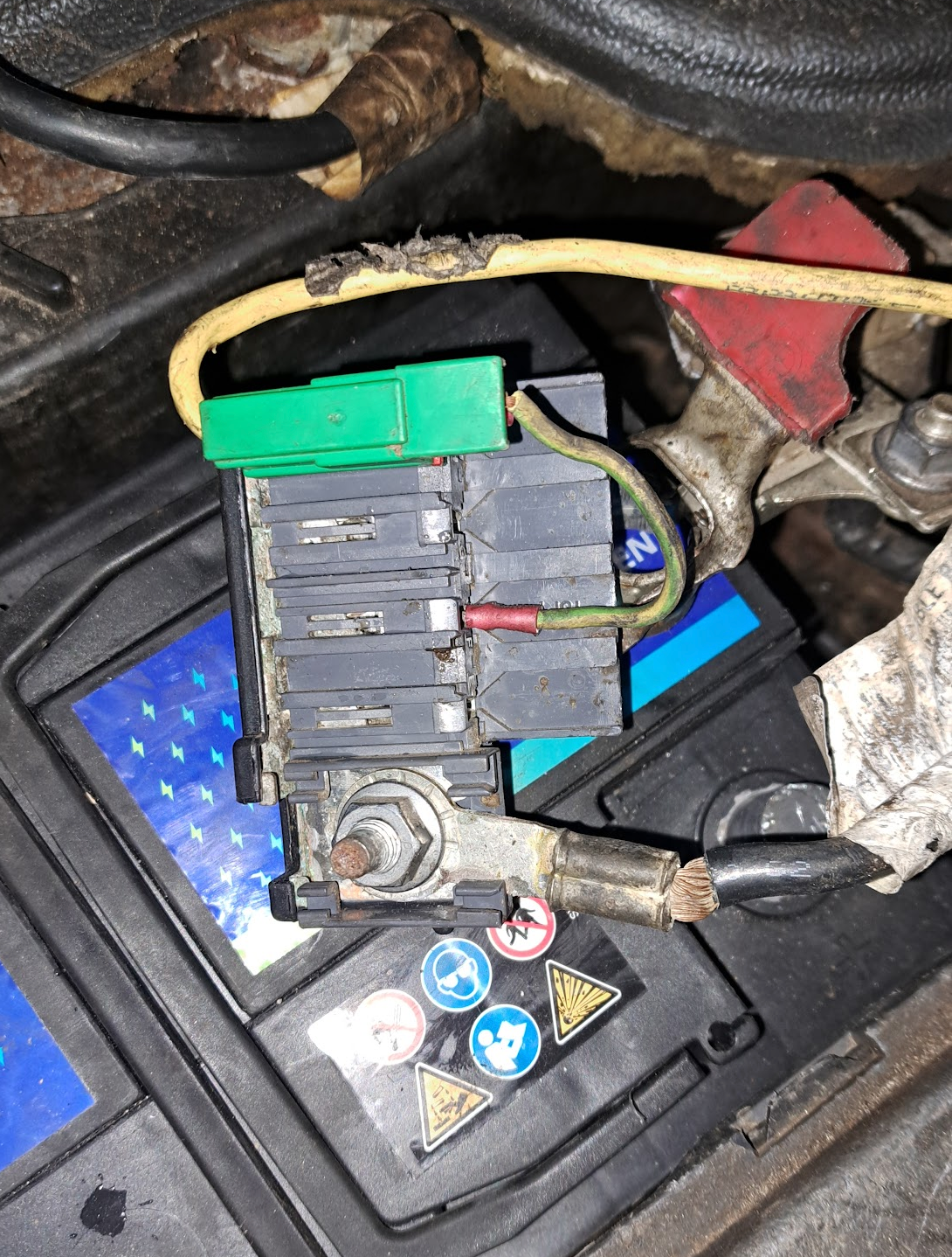

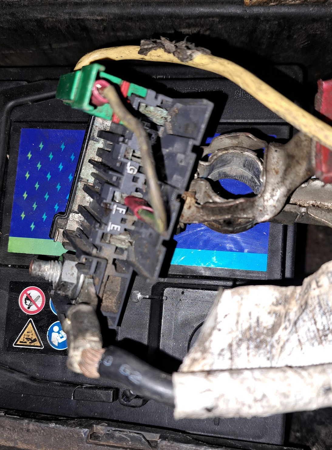

In other news, can someone explain me, what's this? That small patch wire doesn't look OEM, also the contacts look a bit green.
I understood that car enters economy mode after standing 20..30s in ignition. As I understand from other threads, the correct timing of this should be about 30 minutes not seconds so we may have a power leak.
Also I now know that the "beep test" fails, however I don't know, maybe the economy mode cancels the door beep too?

Re: Expert 2007, 2.0 HDI, not starting after engine swap
Your images are not viewable in the UK, they are presumably on Imgur.
You can upload your pictures directly to the forum.
A guide to that here
