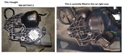

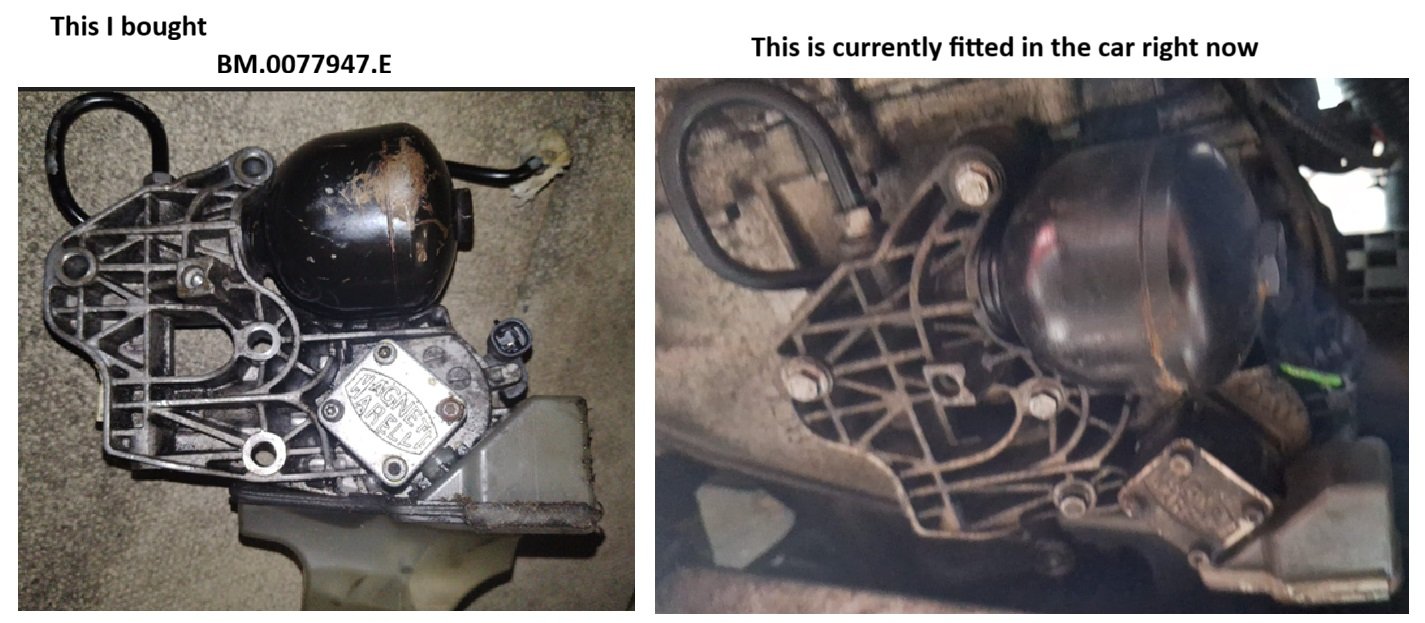

I have a Peugeot 3008 1.6 HDi Diesel 2015 and Gearbox Fault” flash for a second, sudden shift to N while braking. I’m getting these fault codes when scan with diagbox:
P0949 — “Clutch Programming Not Finished or Done”
P0868 — “Transmission Fluid Pressure Low”
P0944 — “Hydraulic Pressure Unit Loss of Pressure”
The problem started after the clutch was changed 1 month ago and the mechanic used brake fluid instead of LDS and he did programing with Snap-on. He told me to now buy pump/actuator as this is need to replace so i bought it (please see attached) but now he is saying that it's not compatible because it can not fit. You bought the one which might be fit on the gear box but in your car this fit under the gearbox.

That’s a bit confusing for me. I’ve spent hours trying to find the correct oil for the gear pump with part number BM.0077947.E (the one I bought) or the correct part number 1608730380 (which I should have bought). From what I found, these gear-shifting actuators use the orange LDS hydraulic oil (PSA S712710), so I bought the Total oil that meets PSA S712710.Paul-R wrote: 22 Nov 2025, 12:08 The correct oil is available on Ebay for half that price.

Ah, I understand now. Thank you for the tip about the clutch slave. I’ll pass all this information on to the mechanic.RichardW wrote: 22 Nov 2025, 15:44 DOT 4 will not have done it any good! Any part that is involved in the actuator oil circuit will need replacing - including the clutch slave inside the bell housing, so the box is going to have to come out again.
