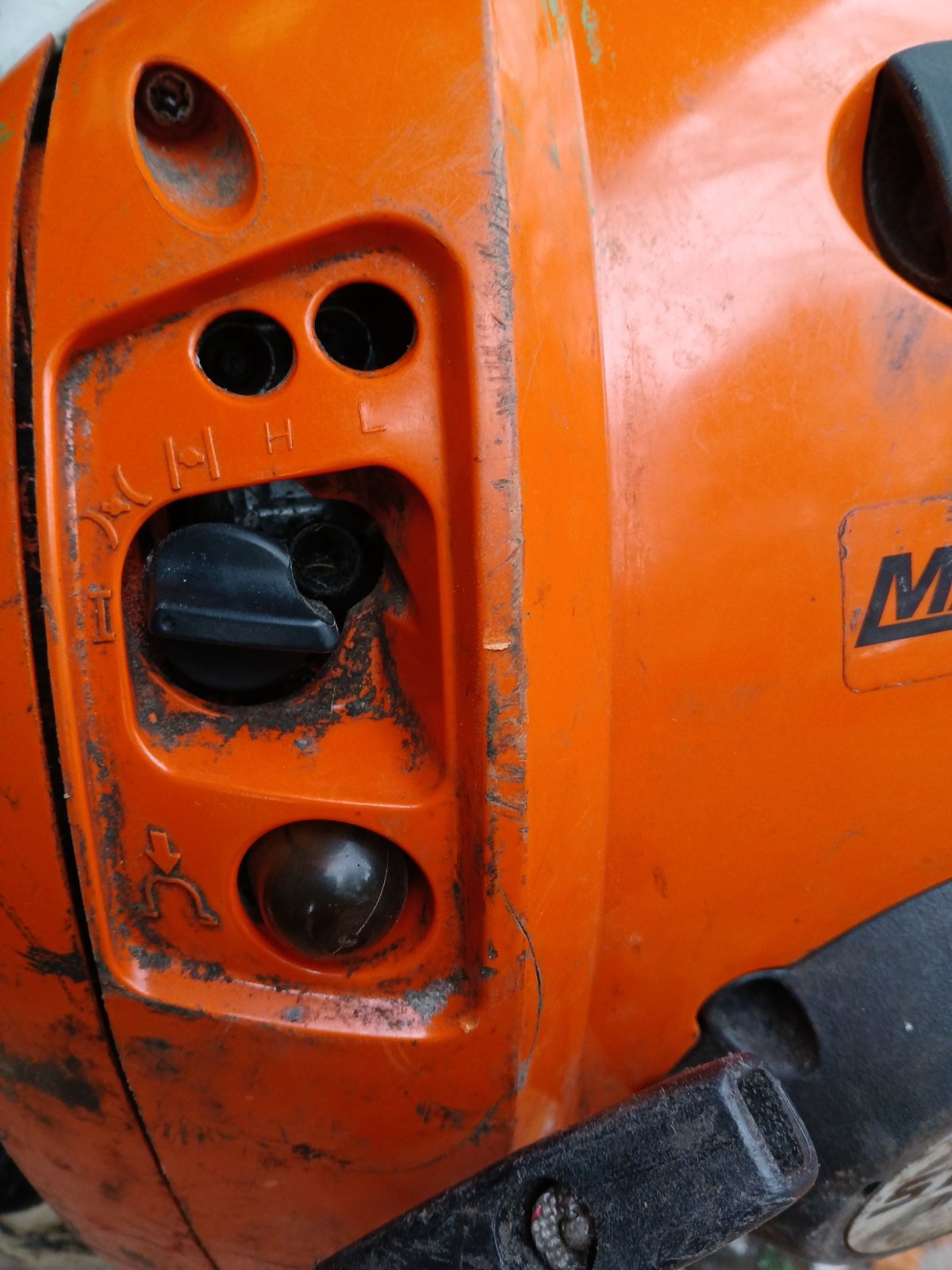

It's currently leaf blowing season and my Stihl backpack blower is doing sterling service as usual..... but it started to show signs of needing a minor tune-up one morning. It'd be lazy to pick up from tickover - so the low speed screw needed adjusting.
Low speed screw is in the hole on the right - own work
Stihl - in their desire to get customers to take everything back to the main dealer for any tweak or fix - designed the heads of the carb adjustment screws so you need a special tool to twiddle them. The head of the screws look like a very fine Torx head screwdriver. I've got a set of proper drivers to adjust these and similar carbs.... I just didn't have them with me that morning. So........ 8-)

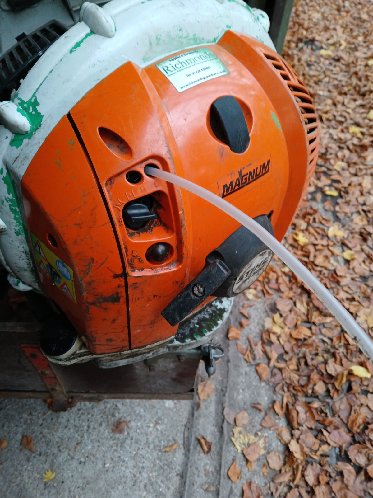

A handy bit of tubing fits over the screw - own work
Fit a bit of tube tightly over the screw and use that to twiddle the low speed screw :-D

bobins wrote: 21 Nov 2025, 18:23 Fit a bit of tube tightly over the screw and use that to twiddle the low speed screw :-D
Nice one! I use the same method for extracting and replacing the main jet in AX carbs :)
Also good for extracting small filament bulbs from switch bodies back in the days before LEDs made the task redundant...

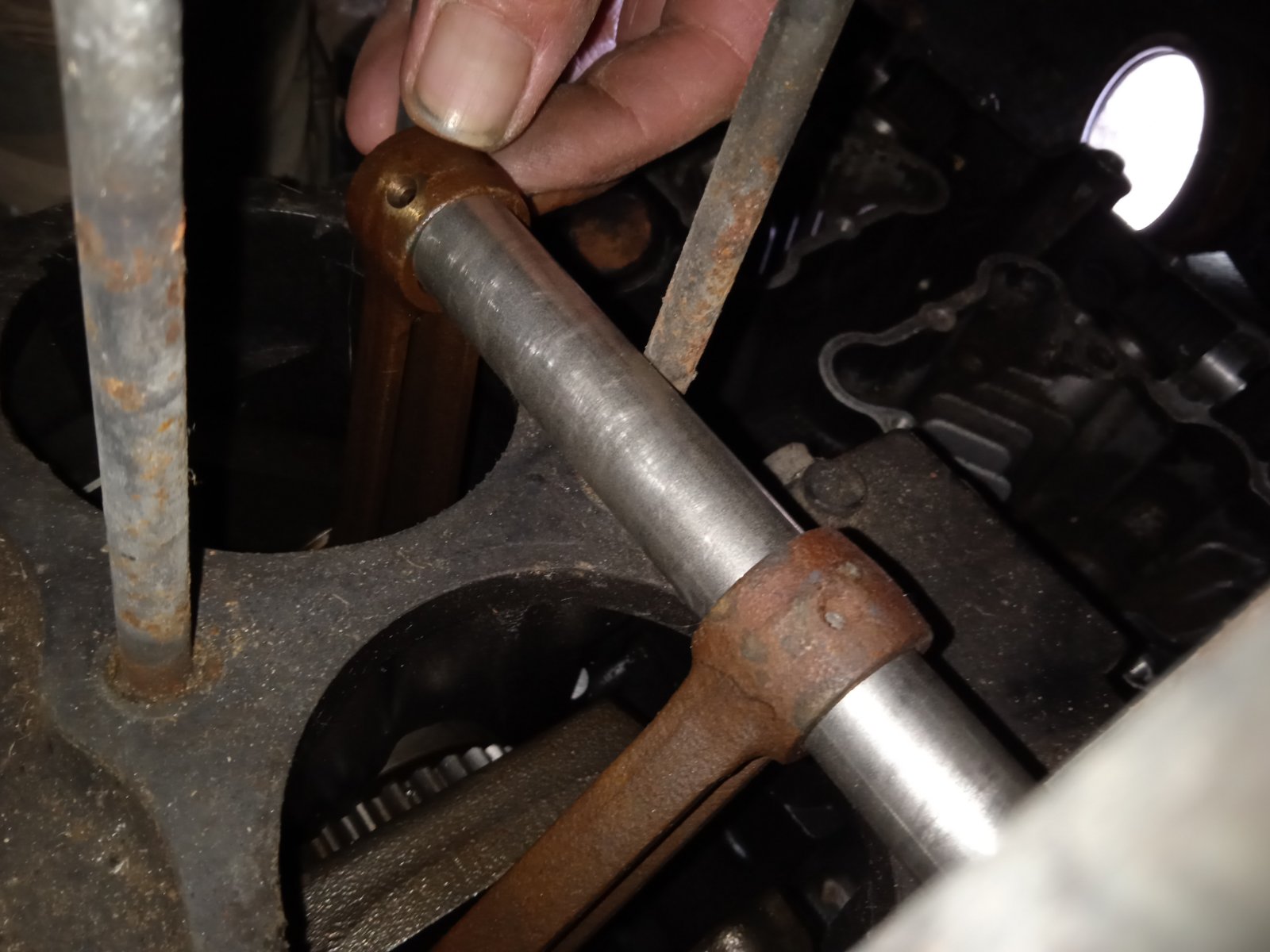

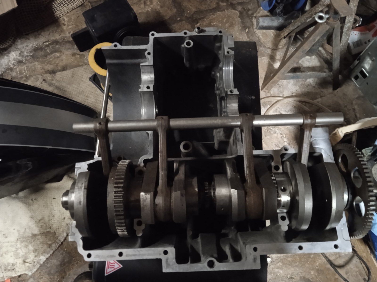

Re: Toolbag Tales-Homemade and improvised tools
Unread post by moizeau »
No, I've got 2 cranks for the Gpz11 engine rebuild and just want to confirm they're not twisted (which they are known to) and choose the best one.
The H9 but is the spec. +0/-0.043mm so all should be good.
Well that was 22€ well spent. The above picture is the crank from a part spare engine that came with the bike with an unknown history. This is the crank from the bike engine that had eaten a cam shell and siezed.
Imagine how full the swearbox would've been if I'd just rebuilt the engine, with all that time and money thrown into it.

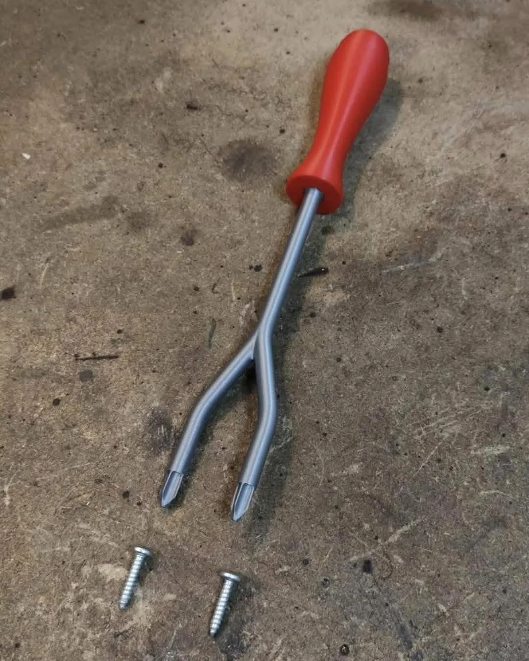

Posts: 54850
x 8234
Epic fail! Actually not, it's a special screwdriver for inaccessible screws ;)
