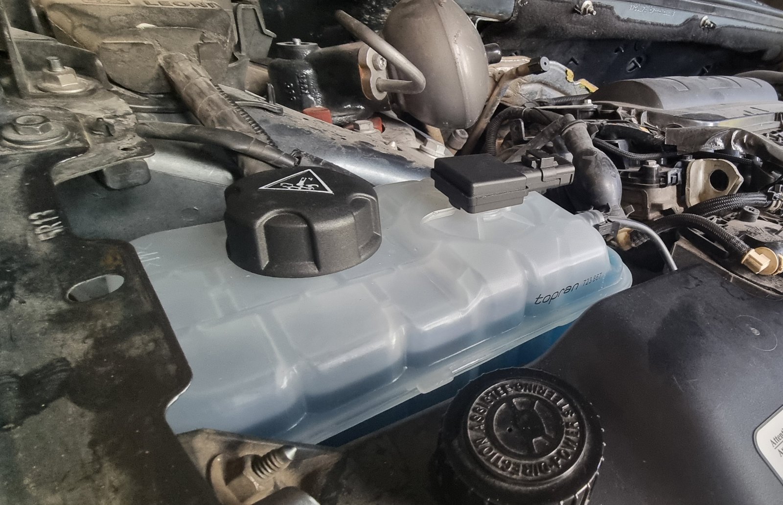

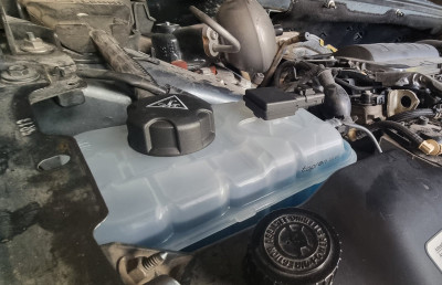

As an (late) update to this post, the C5 is now perfected and a coolant leak will not get me off guard again. It has now what the engineers should have kept from previous version :mrgreen:
Don't ask me for installation details, as it was a friend installing it. All i know is that it works like it was from factory, even warning in the display (it seems thet the ecu was ready to have that sensor fitted ! Duck you citroen)
All the 7 spheres were put to original pressures too :)
