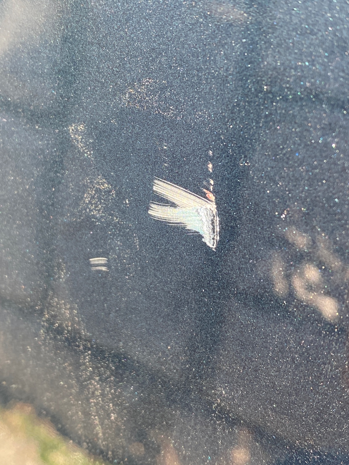

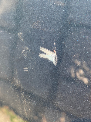

Someone on Sunday slammed his door into my car in the supermarket parking lot. I really dont know how can be someone this much relax and irresponsible

That's not an oops, it's a quick let's get out of here, they knew what they had done.

100% they aware of that. You know what, if they’d left a note on the windshield with a phone number, honestly I wouldn’t have been angry — I might not even have called. We’re all human and it can happen to any of us. The man opened his door and put a proper dent in my car door, then made off. Now I’m looking for a dashcam that can record 360?degree footage. I’d be grateful for any recommendations.

I think people who do this often do it on purpose. I always take care to park as far away as possible hoping others will not park next to us but even on an empty car park I have had a car park next to us.
I have used the touch up paints so a mark will not rust but these days the brushes in them do not have enough bristles to do a decent job.

Some (a lot?) might polish out with T-cut.

I asked already to local detailing shop. He said that French cars especially citroen has very thin layer of paint and gave me an offer € 675 for full detailing and ceramic shield

Yes you are right about the paint thicknesses on Citroën, my old x7 had good paint, currently car is as thin as thin gets, and it chips easy.
I use a ceramic coating, nothing special, currently using a hybrid polish/wax, even a £20 bottle off ebay lasted quite well. Yes there are expensive coatings out there, but I can't see the point as I redo mine every other wash (couple of months) and not the once a year they advertise.

IMHO not a lot of that will polish out, the thickness of modern clear-coat is just not there to allow it. Touch up paints will look horrid as it is a metallic and will need to be built up in many layers to get to a correct thickness to "level" the defect before applying new clear over the defect.....live with horrid or paint the whole door

Actually I have a road map. I will follow step by step this video:Stickyfinger wrote: 28 Oct 2025, 17:47 IMHO not a lot of that will polish out, the thickness of modern clear-coat is just not there to allow it. Touch up paints will look horrid as it is a metallic and will need to be built up in many layers to get to a correct thickness to "level" the defect before applying new clear over the defect.....live with horrid or paint the whole door
I’m quite handy with this kind of stuff.

I have one of those paint pens (they are used for calligraphy) and can highly recommend them for that type of "filling" as well as full thickness stone chips etc, getting the paint thickness correct is the key...I find decanted aerosol paint is both to thin (it floods) and to volatile/drys in the tip/cup.....DO NOT try it with a brush is my advice.
Another tip....a cup of thinners, wash out the pen after each and every fill...and a hard clean surface to "start" it before applying to the car...

Good luck, and video, but he was working on an Audi, and they have better/thicker paint, be carefull.
