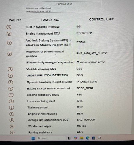

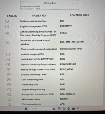

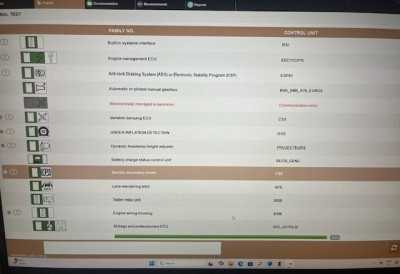

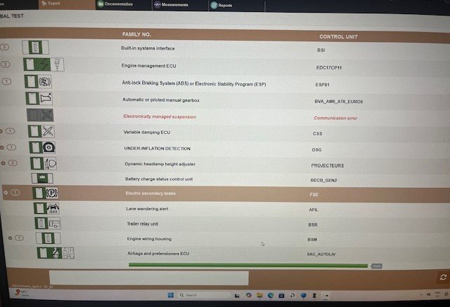

I connected Diagbox, and things got more interesting. I can connect to all systems except the hydraulic unit. I get a “Communication error” for the Electronically Managed Suspension.

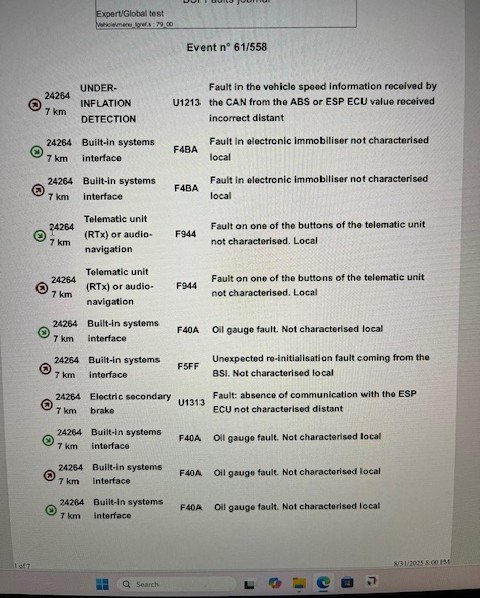

Some Diagbox screenshots are attached.
Thanks for any advice!
EDIT: Forgot the screens.

That is an extensive fault list. I cannot help wondering if there is a proportion of historic problems among them which may be confusing the current position. I'd suggest you clear all the faults and then run a global scan to be sure that you are only looking at current problems. :)
