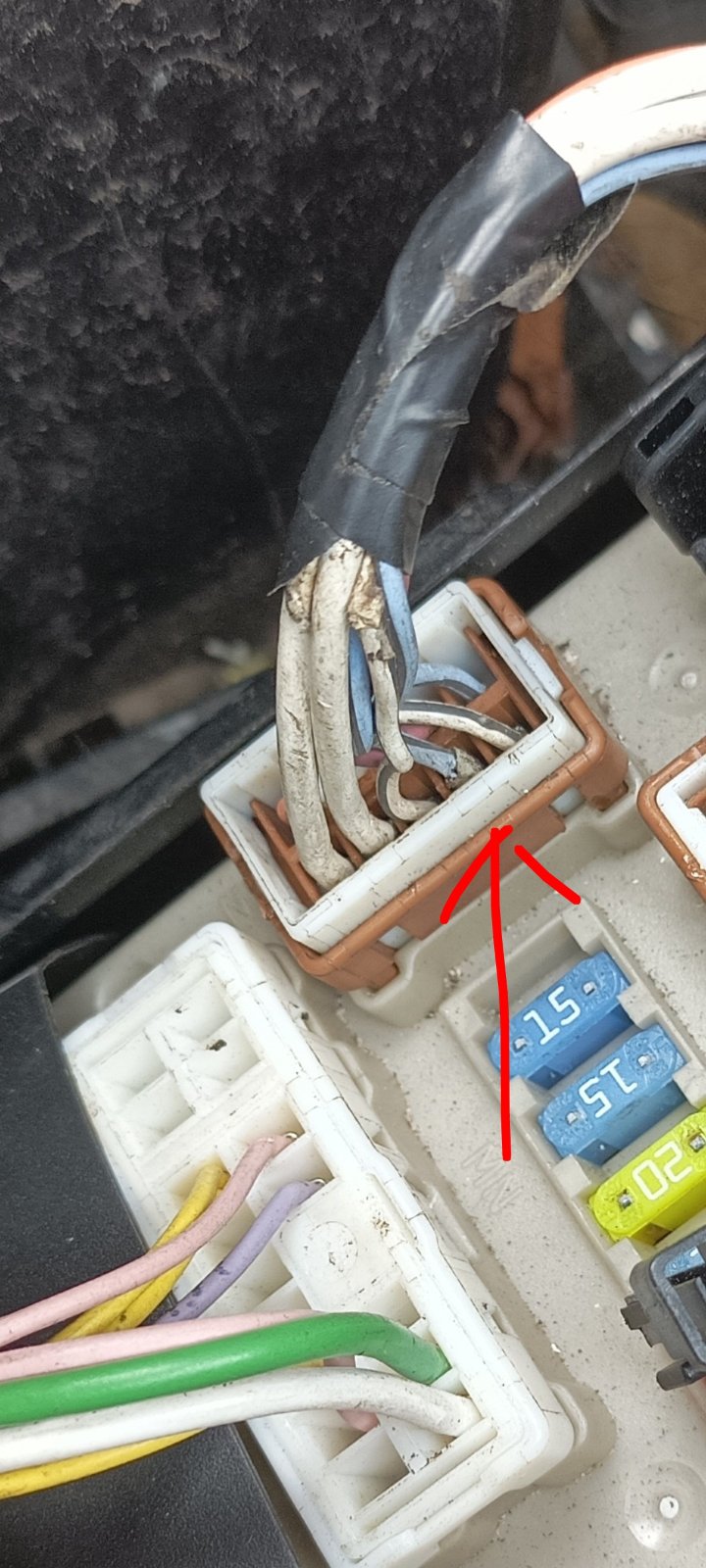

Hi all,
Back with a new issue with the Clio..
This time the sidelight bulb is not working on left hand side. The bulb was blown so I replaced the bulb but this didn't solve the issue.
Checked for voltage across the plug and there is none. There is continuity to earth on one side.
Checked fuse F6 and it's ok and has continuity. I will change this tomorrow just to be sure but the number plate and left hand tail light is working so I don't suspect the fuse.
Any ideas?

Check the connectors where the feed to the side light comes from the loom. :)

It turned out to be the pin in the connector plug to the fuse box was slightly raised and not making contact.
