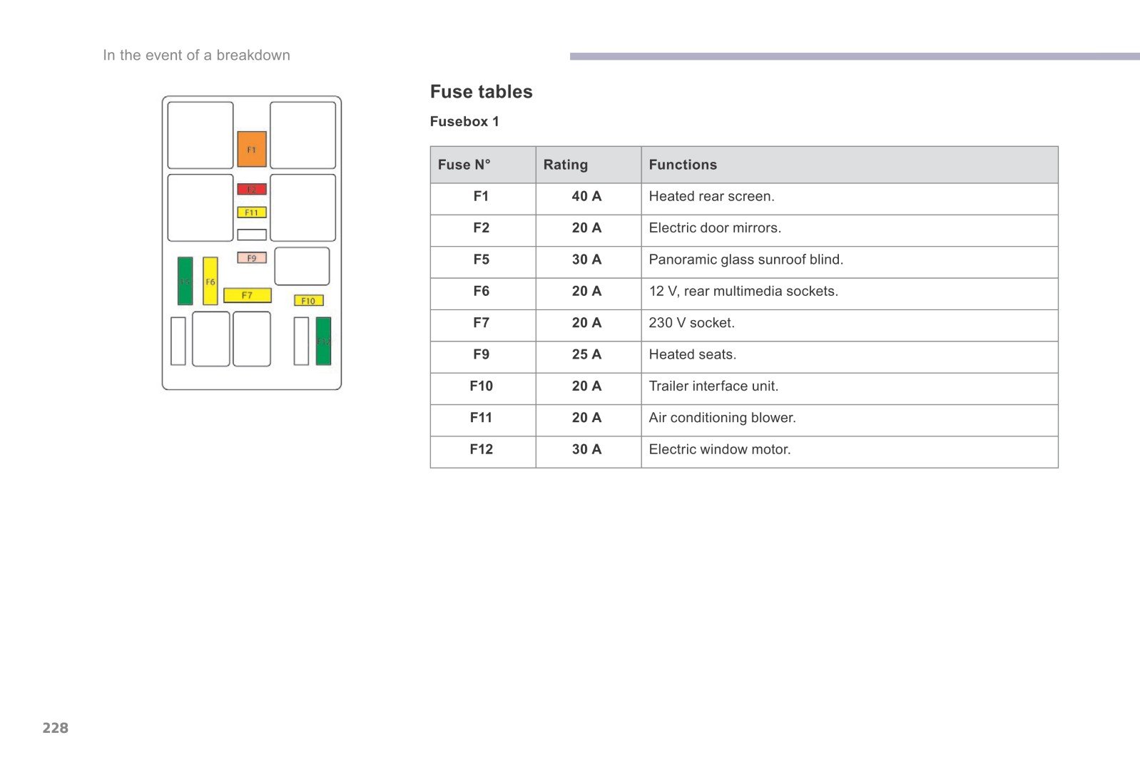

I have found some pages in the manual about fuseboxes and F2 20A is identified in a list for Fusebox 1 (see image)

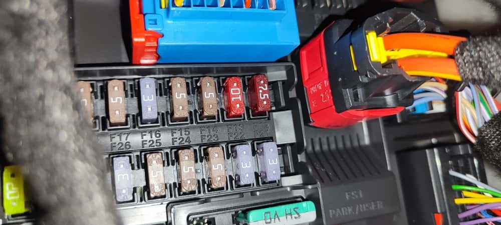

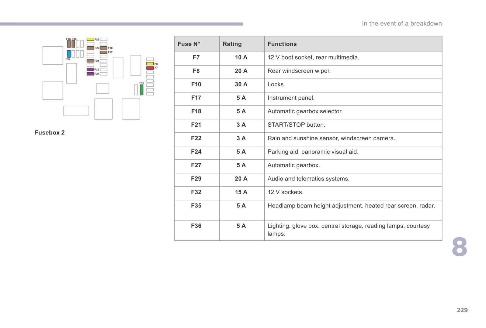

This is fusebox 2 I have a UK right hand drive so there is a fusebox in the glove compartment.
I can see the F numbers so this is fusebox 2 Any one know where I find fusebox 1 in the UK car? It is supposed to be in the same place as FB2 but it is a tight space with a tonne of cabling.

I think it is a fuse as everything is functioning just the mirrors stopped the other day that is why I want to check the fuse, if I can find it!
The start stops works under the correct conditions without a problem.

According to this the second box is underneath the first one: https://car-box.info/citroen/spacetoure ... html#sect2

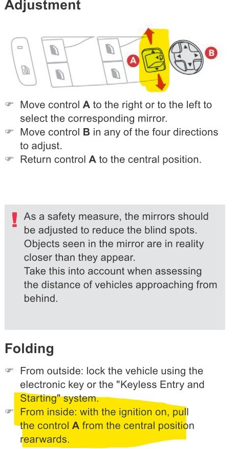

I found the solution, doh! I hunted through the manual and found the section that says you can control the wing mirrors from inside the car when the engine is running. You simply pull downwards on the mirror adjustment switch and the wing mirrors open and close.
