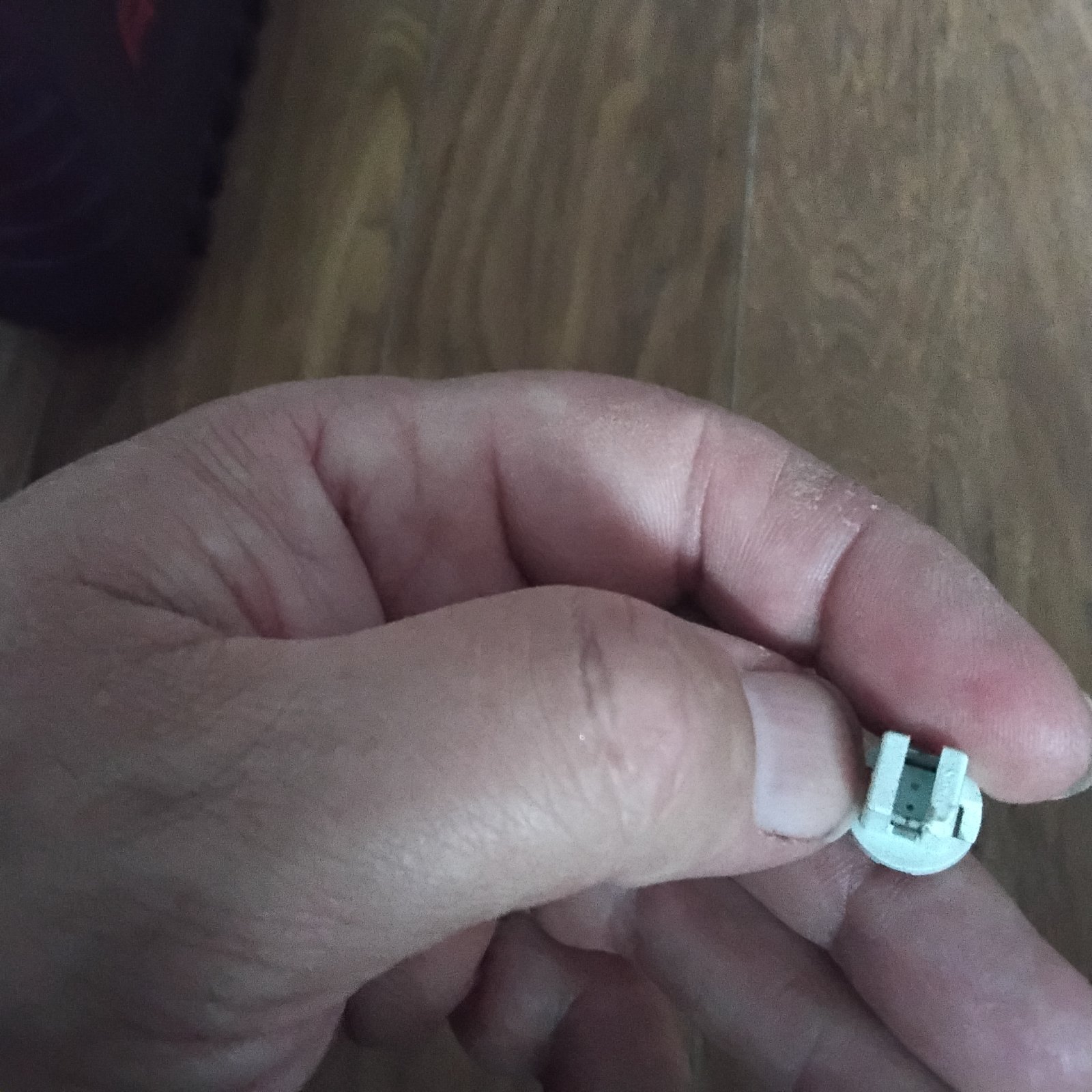

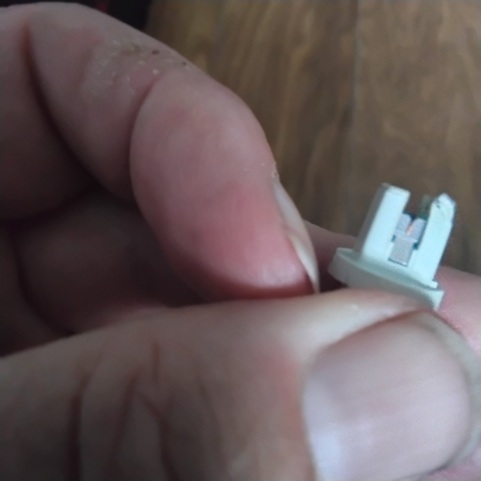

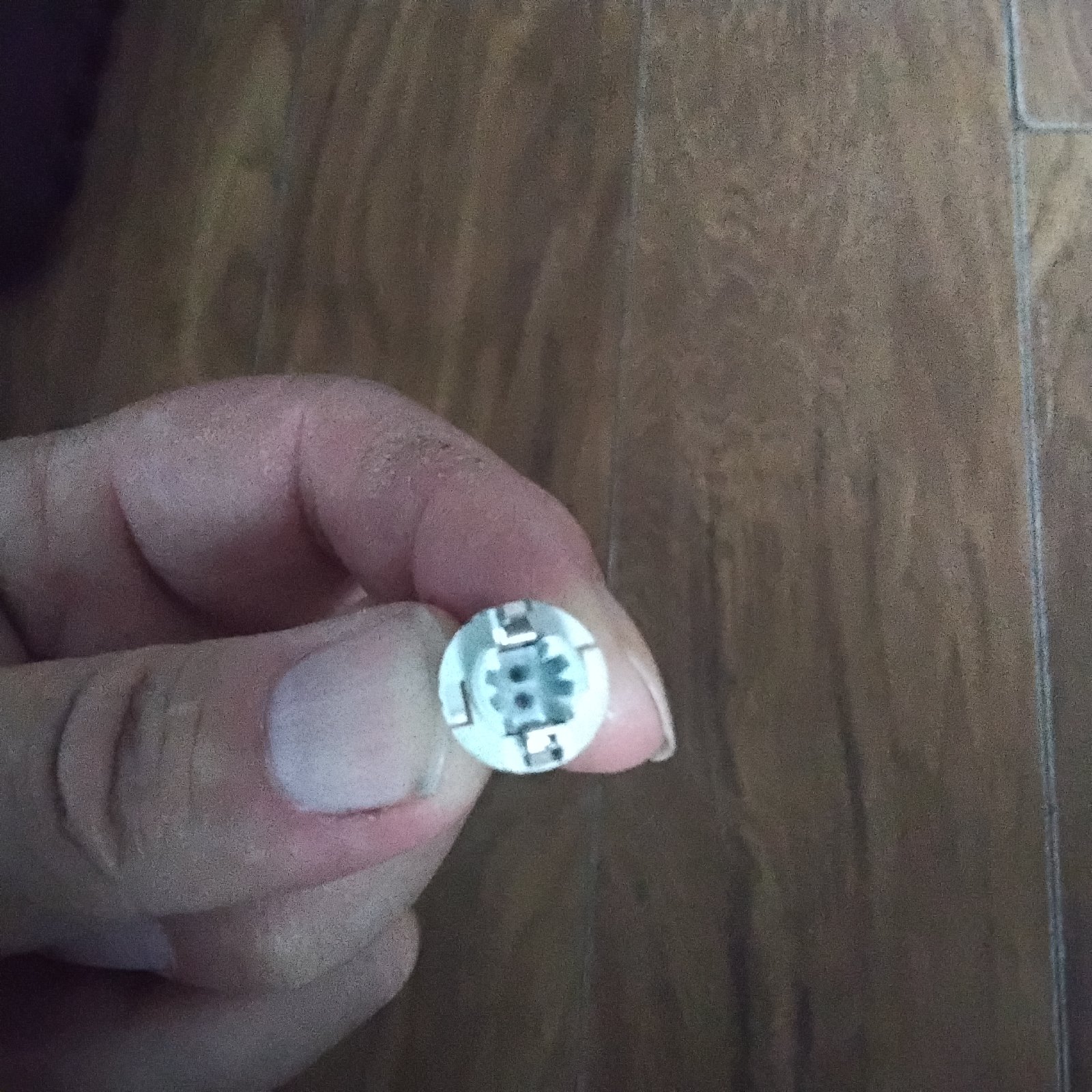

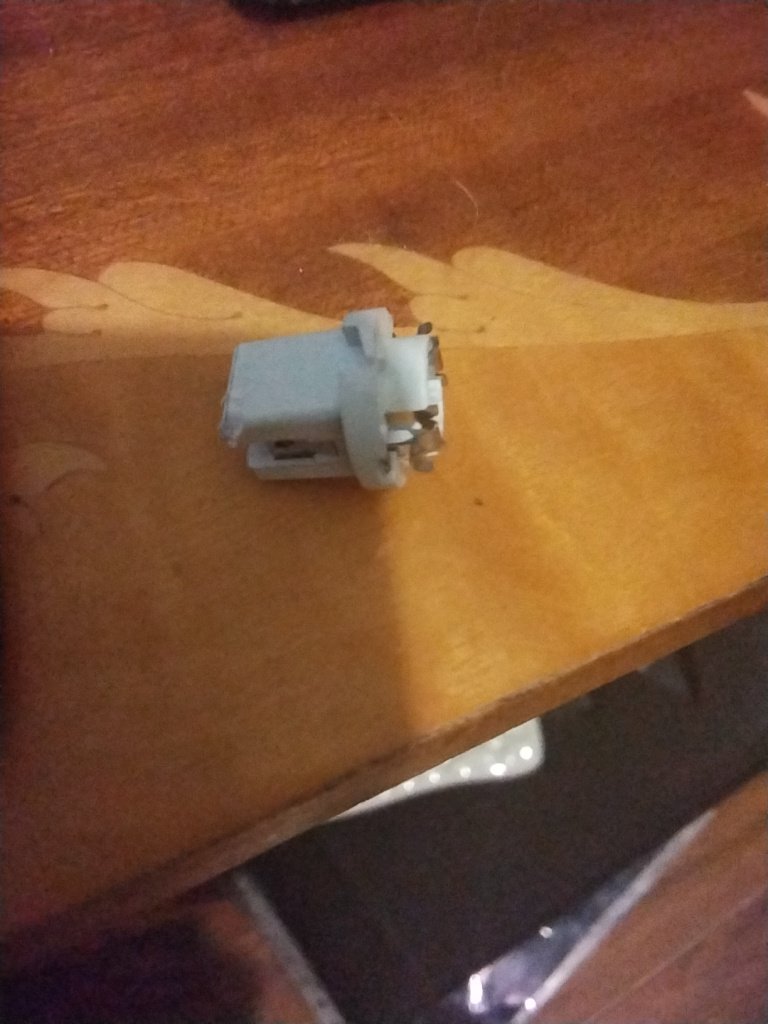

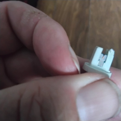

So now the nights are creeping back in my little 207 has one bulb out . The heater panel right had side isnt lit . Here's a picture of the housing . Turns out I've only black cap not the white , anyone got any ideas to its part name or numbers.

Looks like the same bulbs as fitted to all PSA cars dating back to at least my 1987 BX. Push fit bulbs with 2 wires exposed?

Mick, it's for the peugeot 207 2012, heater control panel, the bulb is fitted and is spot soldered in place so you can buy the buld so the wires goes through holes then out the back then over that shiny metal terminal then there Soldered on to them I think there b5 or something like that .

Sure thing mick, many times in the past I've had that way it's the right fit moment with certain bulbs only then to discover the little pins are one centered the other off centered. Ive sourced some on a well known site they are a little different as in led rather than bulb but the housing is the same, fiver for six was worth a punt , I will up date whe they arrive.

I thought that those bulbs were replaceable. I didn’t think that the complete unit had to be replaced.
My experience was that my ‘local’ Peugeot dealer was closed for the weekend but I needed some of those bulbs. There’s a car accessories shop across the road from the dealer and they were open, so I went and asked if they had anything to replace the bulb unit.
The young man found the correct replacement and I was about to purchase however many of them I needed. An older man came to the counter and saw what I was looking at. He said that he was certain that the bulbs were replaceable. I was surprised, but let him check the dead one. Sure enough, it came out fairly easily and he had replacement bulbs in stock. So I purchased the bulbs without the holders. And they have been fine. Even I couldn’t get it wrong.

I thought mine was a swap out type but closer inspection the wire from the bulb is spot soldered to the terminals and where you need to solder is so tight id end up melting the housing
