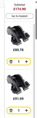

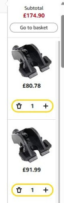

My driver's side washer jet seemed blocked and was just giving a dribble last night which I assumed to be running out of fluid. On checking the bottle it was half full so this morning I took the washers apart having first removed the under bonnet insulation and discovered the driver's side was very blocked and the passenger side slightly blocked . No problem I thought I'll just fit two new nozzles:
Having stood up again following the feather incident I decided that cleaning was the way to go, I put both nozzles into a bath of white vinegar for a couple of hours and then rinsed them clean before spraying Jizer through each one to check the spray pattern. The passenger side was perfect and the driver's side 90% so I swapped them over and refitted them to the car with all new piping to overcome the age deterioration. Under test they work admirably, the swapped passenger one even giving a full spray under the higher pressure than my Jizer can. Just got to wait for the new trim clips for the insulation, most of which broke from age brittleness, and the car will be back to full health!!
