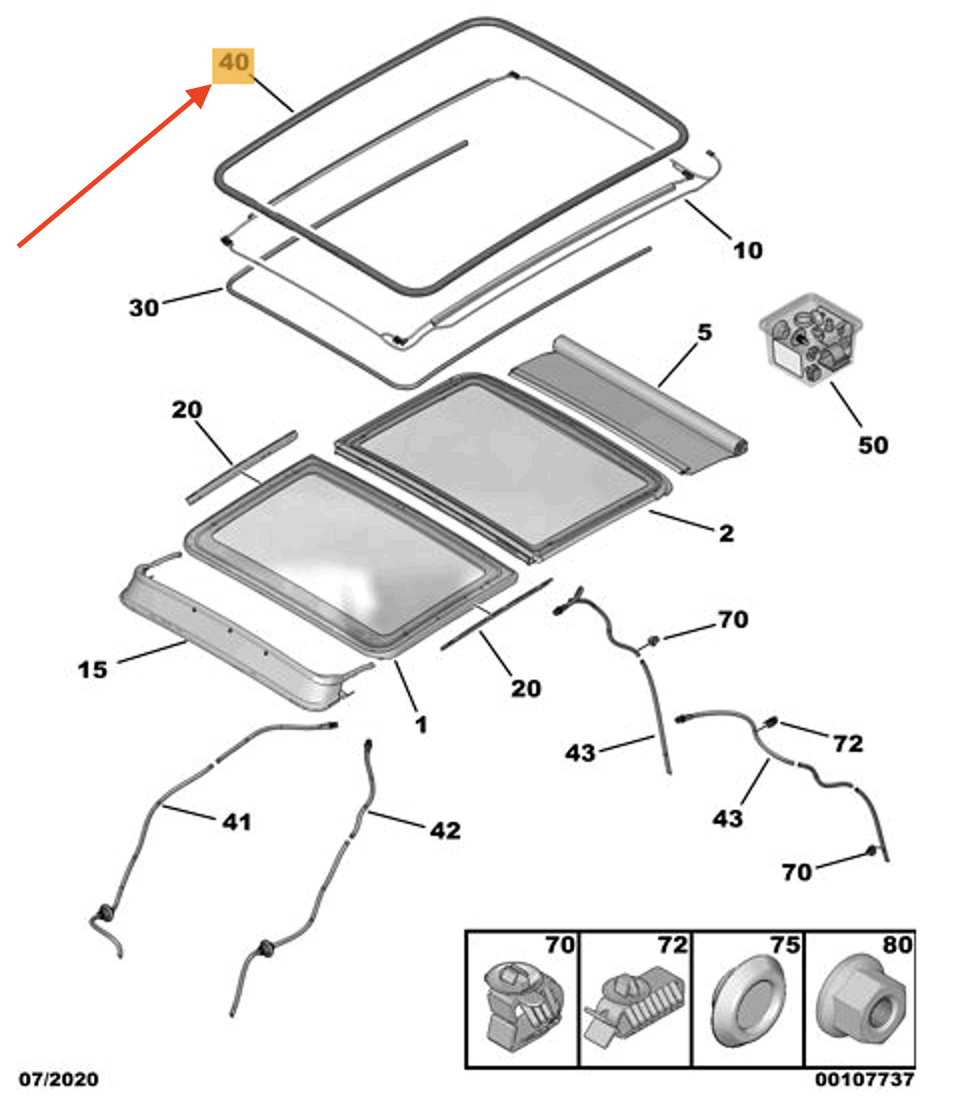

I have had rust forming around the outer seal and got the rust repaired and some sealant has been put inside the seal. Because the job hasn't been done properly, water is seeping through the seal and getting inside the cabin. I am currently looking to get a new seal but it's on back order with the dealer. I have been looking for the part online, I have asked a couple of breakers but I can't seem to find one.
The question is: is this sunroof (seal) the same of on other vehicles with the same sunroof, like the 3008, 408 or even some citroens?
Part number for the 5008 is 9814485180.

I did manage to buy a new seal from the dealer as it came back in stock. Even with the new seal, it still leaked.
What I have done to fix it was to apply some clear silicone grease inside the seal around the front passenger corner. It's rained several times since, and no leaks, fingers crossed.
Just to add, the seal does have some white sealant inside, once disturbed it will create a gap and leak.
