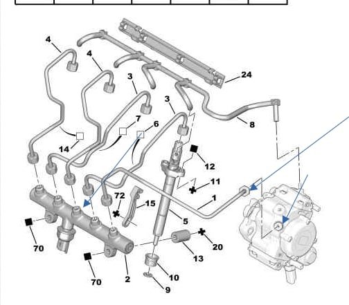

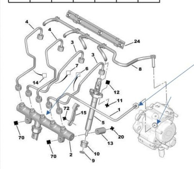

I’ve been chasing a fuel-related issue on my C5 X7 2.0 HDi for the last few months, and I’m hoping someone here might have some ideas.
I keep getting the following fault codes on and off:
P0094 (small fuel leak)
P0087 (fuel pressure too low)
P0183 (fuel temp sensor high input)
Sometimes it’s just P0094, sometimes P0094 + P0183, and on rare occasions P0181 pops up too (only happened twice though).
My family member has the same C5 X7 with the same engine, and his runs perfectly. So we’ve been swapping parts from his car to mine to try and narrow things down.
So far I’ve replaced:
Fuel filter housing
Fuel lines to/from the HP pump
Injector return line
After changing the lines to and from the HP pump, it actually seemed to improve a bit — but the issue is still there.
Symptoms
Before changing those lines, the car would go into limp mode every time I accelerated harder than half throttle going uphill.
It was super consistent — usually happened around 2,000 RPM in 5th or 6th gear.
Only once did it happen in 2nd gear, full throttle uphill.
It seems to be related to RPM and gear load, because it’ll also go into limp mode when overtaking under 3,000 RPM and in 5th or 6th gear, even on flat roads.
After replacing the HP pump lines (just today), it’s less frequent, but still triggers the same codes if I test it a few times going uphill.
Starting Issue (Air in Fuel Lines?)
I think there might be air getting into the system, because if I park the car facing uphill — even on a small incline — it won’t start unless I prime the fuel a few times.
If it’s a steep hill, it won’t start at all, even after priming.
I’ll test again soon to see if that’s still the case now that the HP pump lines have been changed.
Looking for Ideas
Any suggestions on what else I could check or replace to finally sort this out?
Maybe something I’ve missed in the fuel system?
citroen C5 X7 2.0 hdi p0094, p0087, p0183
