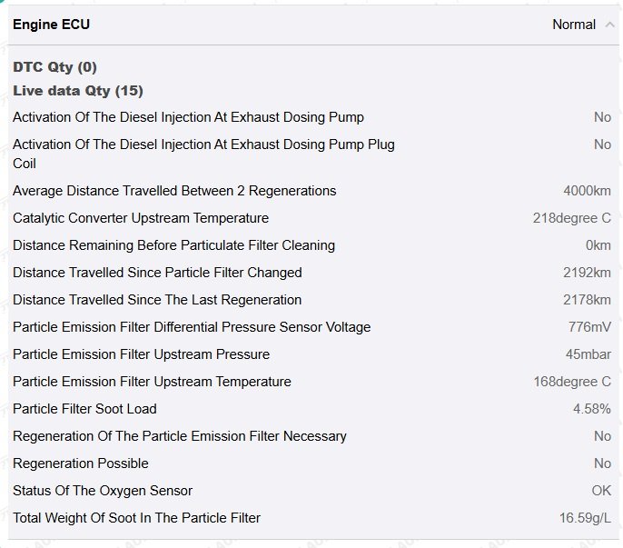

Tried to perform " Forced regeneration of the particle filter, vehicle stationary"
immedialty come back with "Activation done - problem occurred during the operation - conditions of execution not satisfied"
Plugged got the diags - see image..
So maybe the values for dpf change are correct. I went on the MOT history and could see that the mileage at the MOT was about when the ecu reported dpf change.
Now here's the thing - it's never performed a regen since dpf went in. Something is stopping it...

..I should also say I ragged it down the motorway with the diag running and recorded a max temp of around 300C on the exhaust - nothing close to 600C. It' def got a block - the pressure was up around 300mbar - nnot yet in limp mode, but it's in the post I think

It could also be that matey boy had the DPF fitted a good whil eback, and it did regen, but being aftermarket, it burnt its self up, and wont respond to further regens even when the guy who did the MOT reset the DPF change flag.
