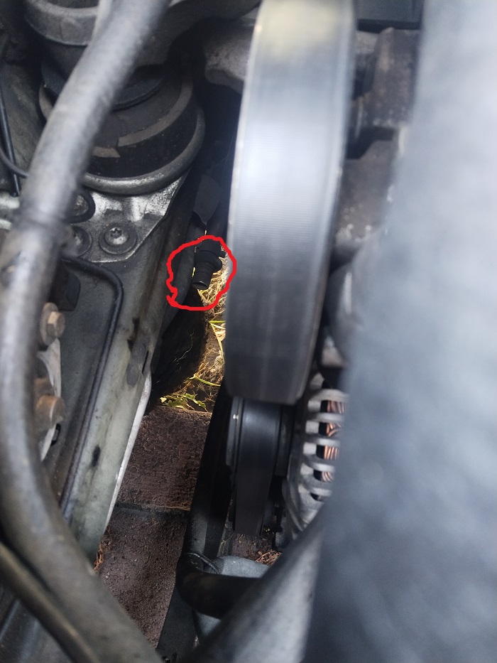

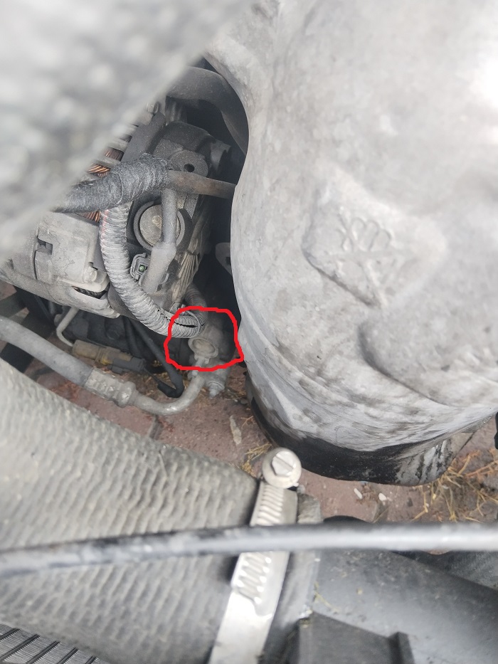

Hello, an air conditioning pipe that goes into the holes I marked in the picture broke. What is the part number or full name of this air conditioning pipe? What is its name? I was going to order it online, but I couldn't find it because I didn't know the name or part number.

What year is the car and which engine is in your car? :)

mickthemaverick wrote: 29 Sep 2025, 16:21 What year is the car and which engine is in your car? :)
2007 model Citroen C5 II 1.6 HDI DV6 engine

This is all I can find so hopefully you can work out which pipe it is and get it sorted!

mickthemaverick wrote: 29 Sep 2025, 17:07 This is all I can find so hopefully you can work out which pipe it is and get it sorted!
C5 II - 0601 06 640840A - FREON TUBE - FIXING.pdf
Pipe number 4 hose, thank you for your help
