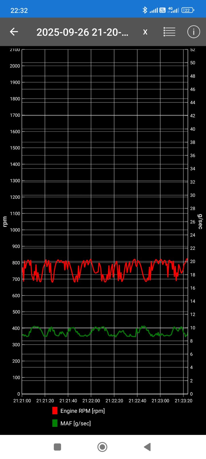

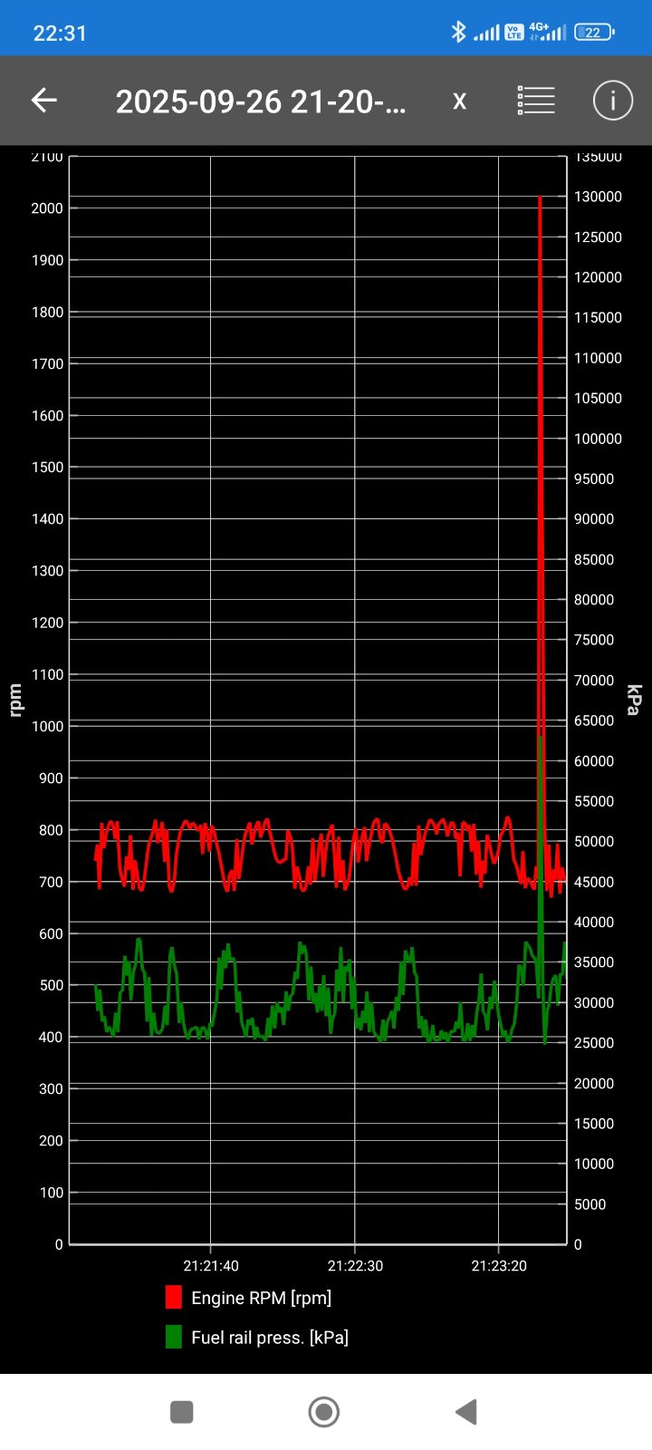

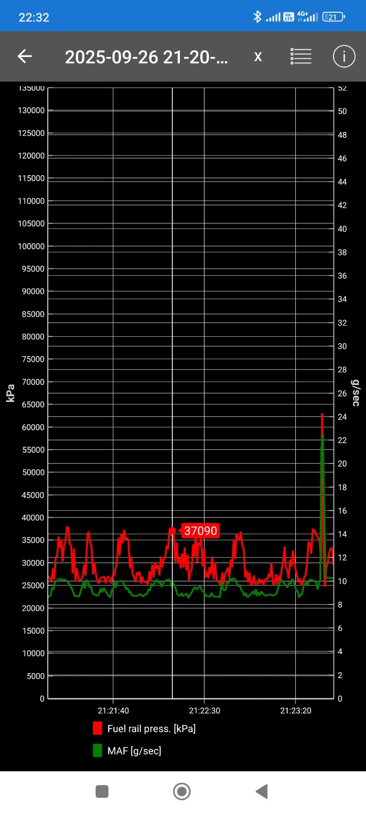

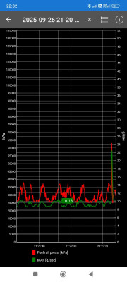

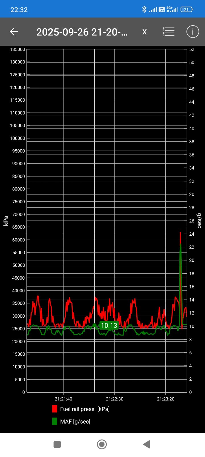

Live data during hunting:
Idle RPM: ~684 to 760
Fuel rail pressure swings between 26,000–38,000 kPa
MAF around 5–6 g/s (sometimes lower when it hunts)
This is live data while engine is hunting

That swing in fuel pressure strikes me as odd. With the engine at idle I'd expect a much lower swing so I'd be looking at the injectors to see if one is not performing correctly and causing erratic fluctuations in the fuel rail pressure. :)

What Mick said.
Look at the live data for the njector correction values and see if anything looks odd there, eg, wildly different or fluctuatnig values on one injector.

I tried to unplug the egr today, i felt the car a bit more powerful, i did measure the injectors they were a bit weak but equal in fuel delivery, i shared this picture for live data i got while engine was hunting, this problem is getting me crazy i tried almost everything
