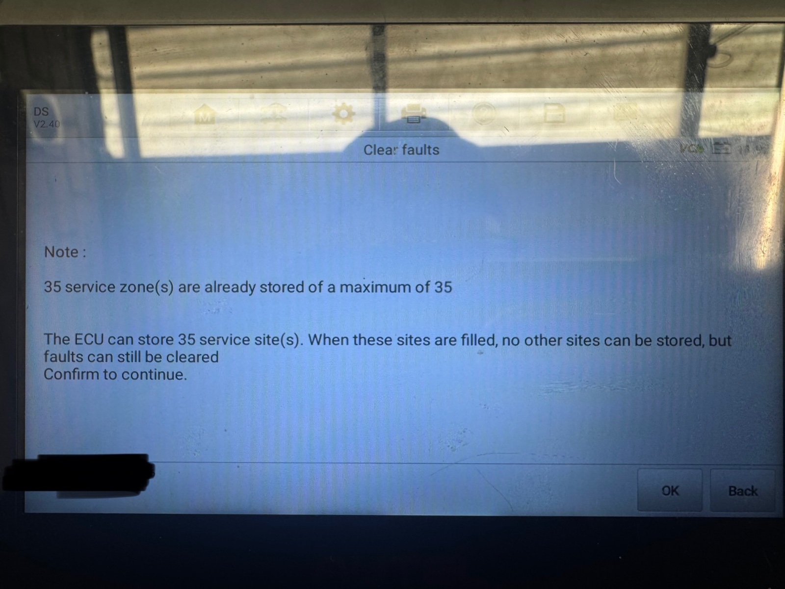

Had a lot of diagnostics done on my DS3 recently and mechanic is now getting this message on his reader and can’t go any further. Anyone seen this before?
Note: 35 service zone(s) are already stored of a maximum of 35.
The ECU can store 35 service site(s). When these sites are filled, no other sites can be stored, but faults can still be cleared.
Limited service slots?
- Posts: 21385
- x 8165
Re: Limited service slots?
Yes I remember seeing that on my XM I think it was. I just ignored it and carried on using the lexia in the normal way. I think the memory can be cleared but I don't know how!
