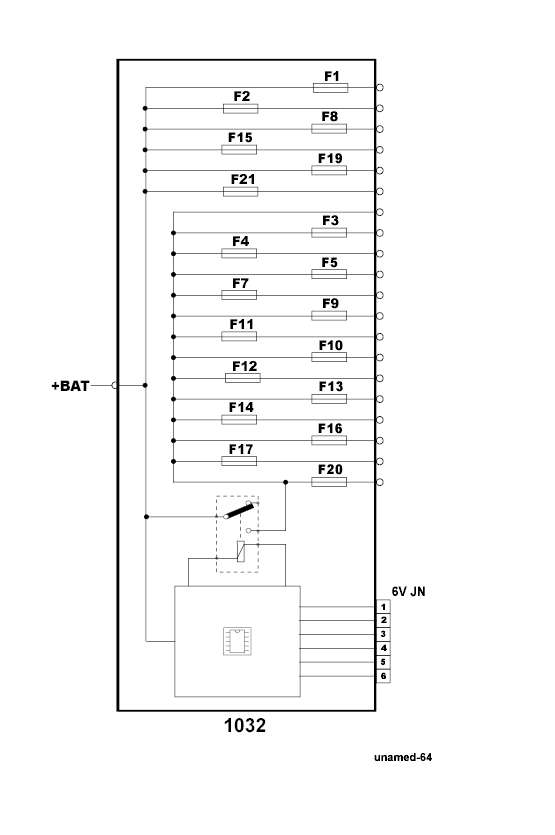

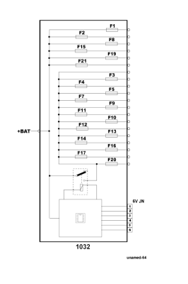

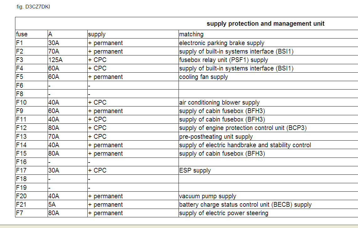

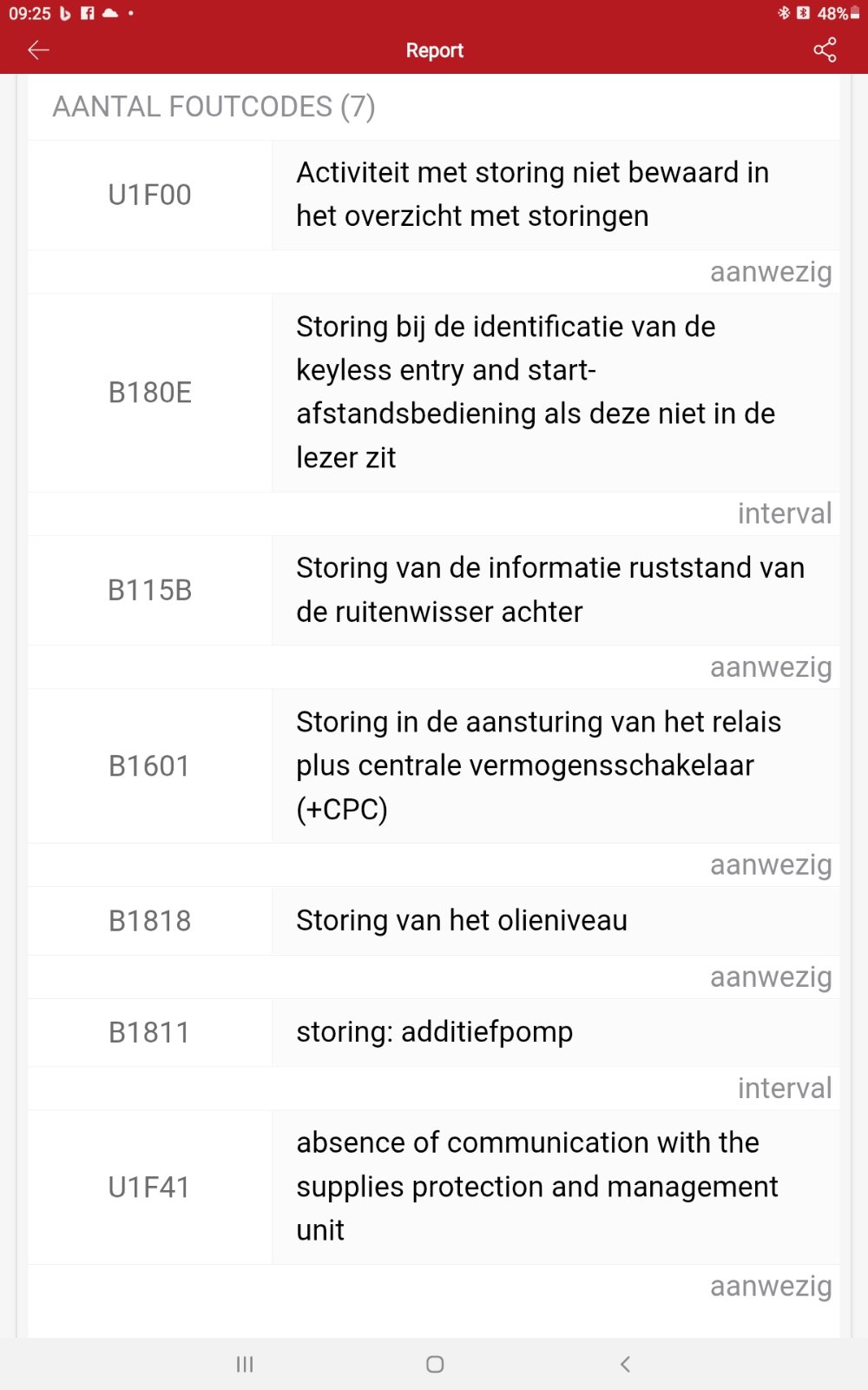

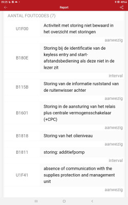

When i get this vehicle running i'm sure to use that spray. I've scanned the car again and now i've got a whole lot of dtc's and the one's in de BSI are most significant
I've added the scanresults concerning the BSI and i think the p1601 and U1F41 are most likely to cause all kinds of trouble
Appart from this there are some more faultcodes in other systems but i think they all derive from the ones in the BSI I have also added a wiring diagram of
the power supply management where i think the the fault comes from but i get confused when i see that the permanent powerd fuses and the cpc powered fuses are not
the same in both diagrams Maybe someone with some more experience can shed light on that. Both diagrams come from the same document called SEDRE
Does anyone know anything about this issue (the faultcodes or the diagrams ) I would be gratefull
theresults are in dutch, the P1601 speaks of malfunction of operation of the central powerswitch relais (+CPC)
U1F41 is in english
The rest is of less inportance i think but you can look them up if you want
Does anyone know what the central power swith relais and where it is located?
thanks peyvey
U1F41 is in english
thanks peyvey
