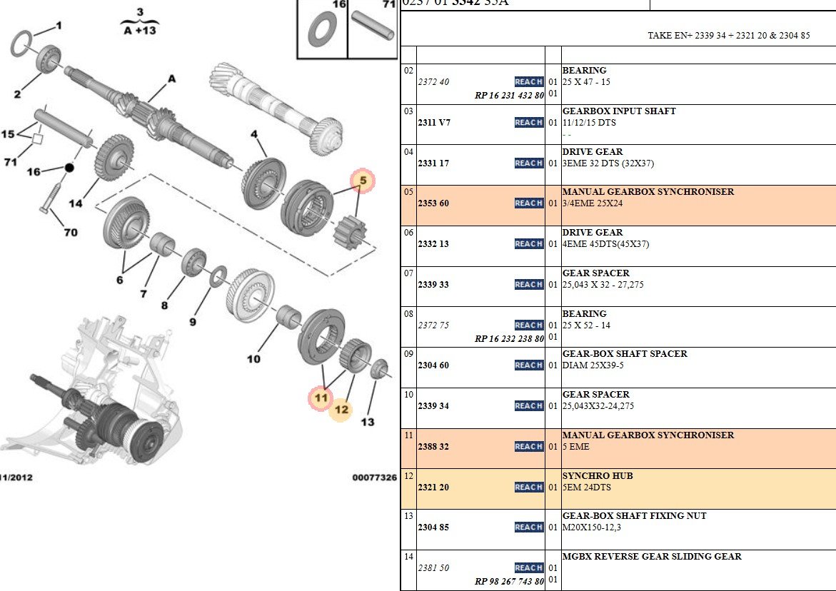

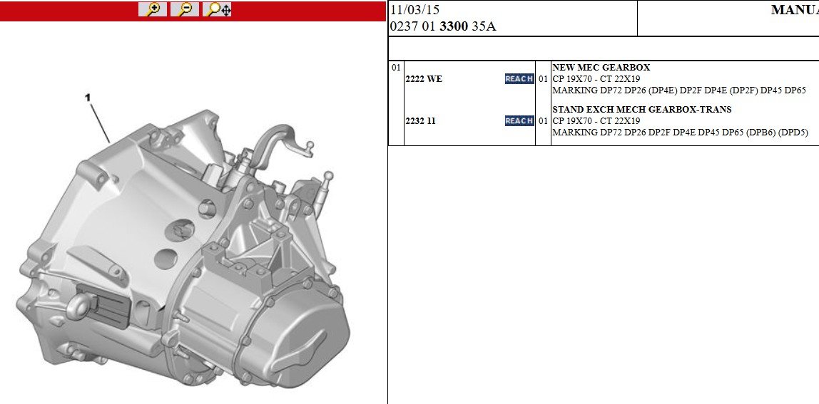

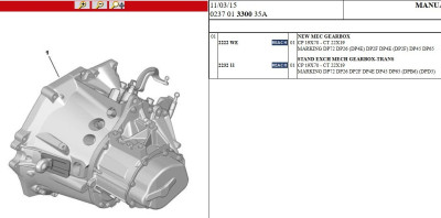

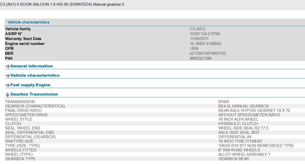

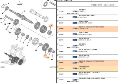

I would be trying a different dealer

Thank you, most useful to know
Also good to see the VIN does actually exist, perhaps dealer only can see relatively new cars
