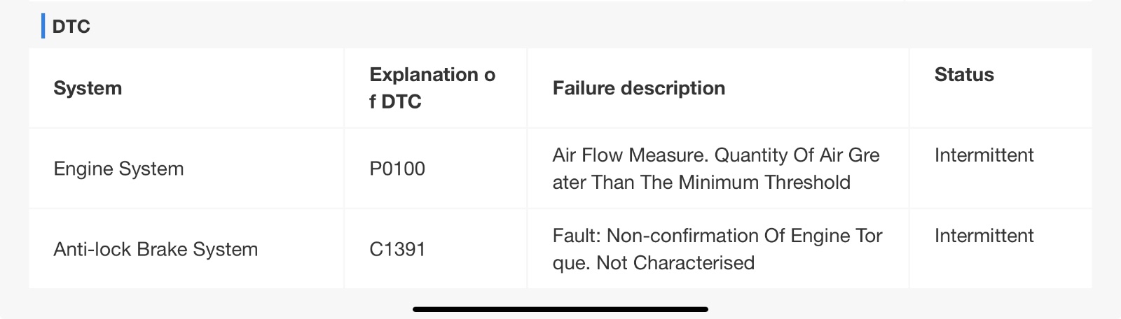

The Dogmobile has started to misbehave when using anything more than a modest amount of throttle.
On anything over around 30% there is a sound like rushing air from what sounds like the front right of the car, followed by ABS/ESP warning, tyre pressure warning and MAF fault.

P0100 & C1391

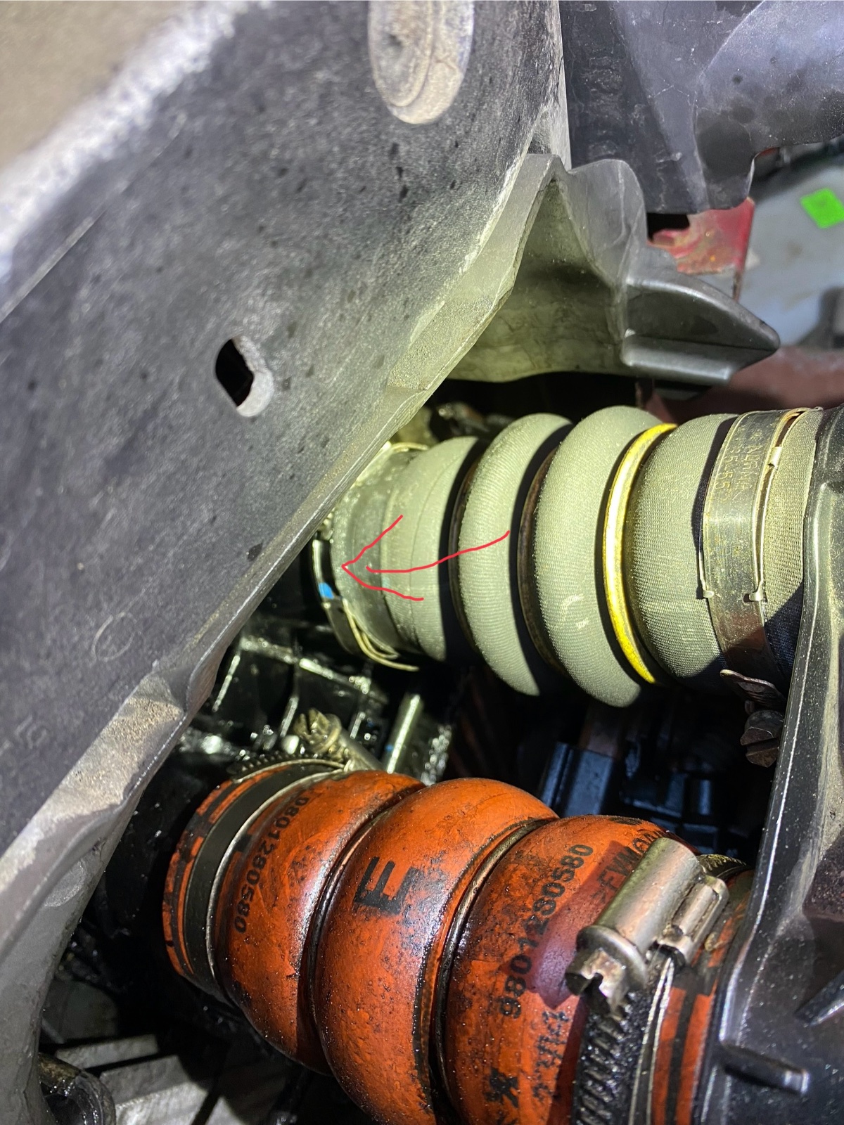

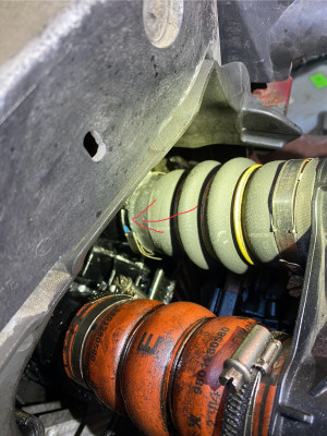

Re: P0100 & C1391 - SOLVED
Okay guys,
Turned out to be one of the clips holding one of the hoses to the intercooler had partially slipped off the end of the hose, allowing it to break the seal under pressure.
Easy fix in 5 minutes, so thanks for the suggestions guys, much appreciated.
Still not sure why this caused the C1391 DTC, but seems to have cleared along with the P0100.

Re: P0100 & C1391
Nice find!
When it trips the fault in the engine ECU it interrupts the data flow to the ABS ECU, causing all sorts of mayhem and lights to come on. Many people have been misled and chased random ABS/brake faults when in fact the fault lies with the engine. Including me before I knew better!!!
