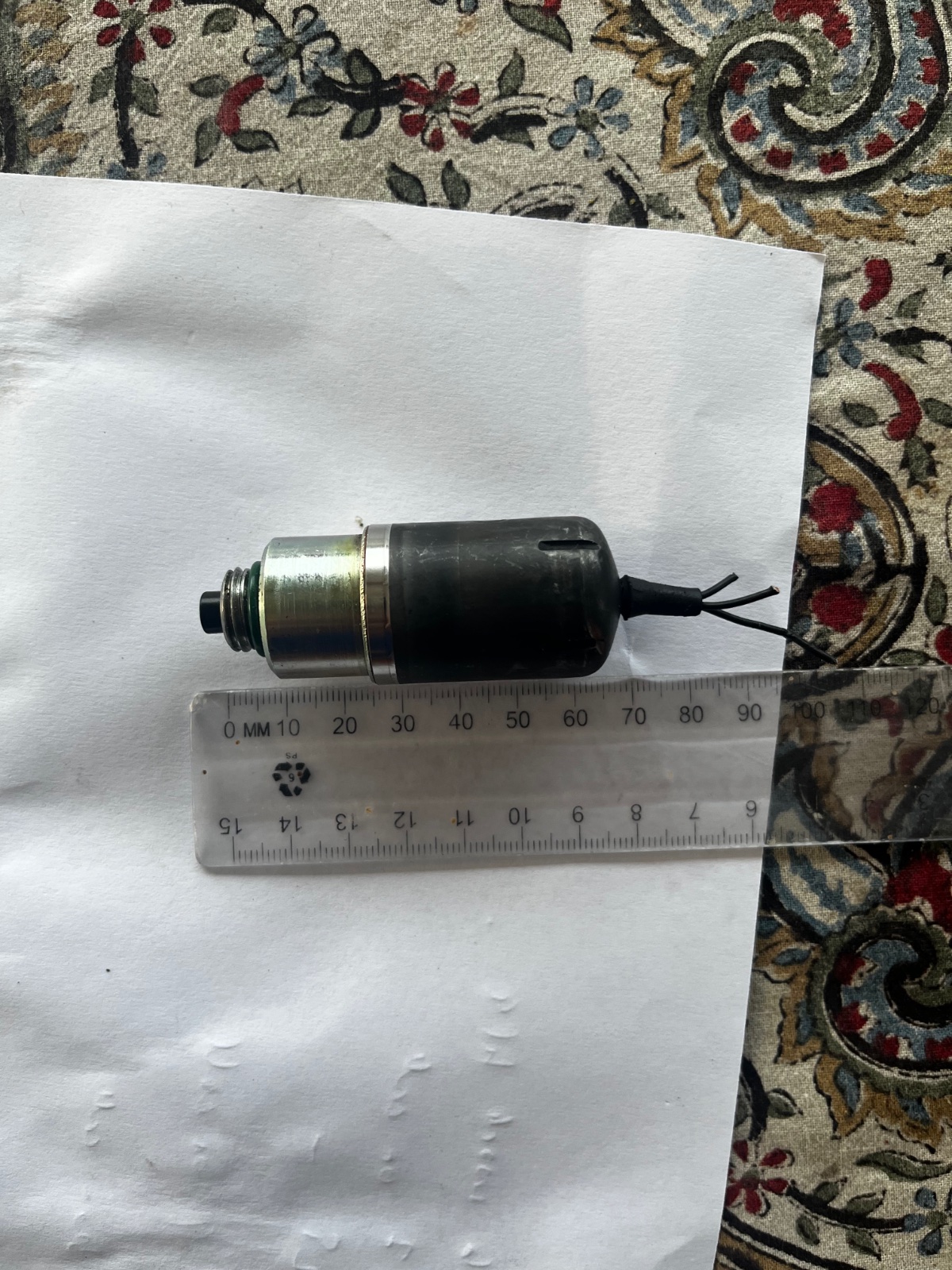

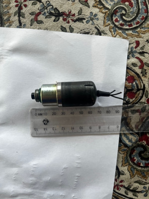

Hey was wondering if you guys could help. My car just wouldn’t start one day and it’s been in the garage about a month. I’m trying to source this part, but can’t find a matching one (with 3 wires) anywhere, so even knowing what it’s called could be a massive help. I also had a spare key made a few months ago was wondering if this could be a potential cause aswell? I have a picture attached, thanks in advance! :-D

This is a coded stop solenoid, a second hand one wont work as they are coded to the car unless you get matching keys & ECU etc.
A brand new one would likely write the car off.
Option 2 would be to replace it with an old style non coded stop solenoid & just wire it up with an ignition 12v

Something like this > https://ebay.us/m/SO1KQ6
Would need to check compatibility & threads etc
