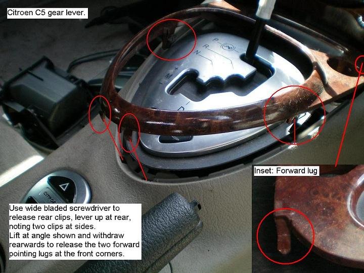

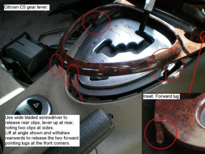

gear selector lights on my auto mk1 c5 not working all lights work apart from them i looked but cant find a answer any ideas

Not certain about this but assuming you mean the gear indication lights beside the lever I suspect the earth connection to the backing plate may be corroded. I had that on mine and a good clean sorted it out. :)

ok i give it a try any ideas how to disamble with momuim fuss

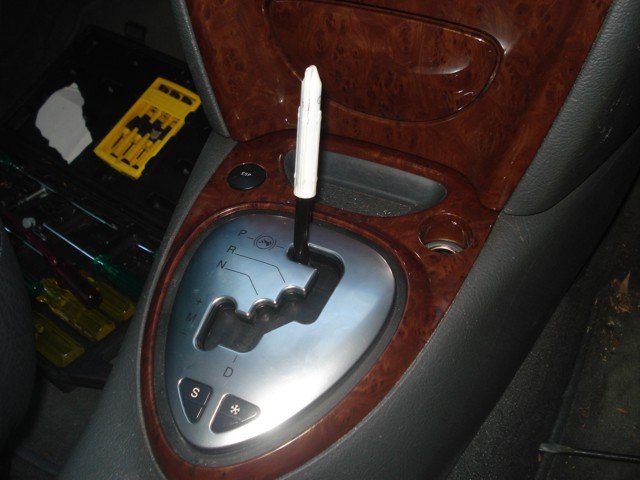

but does the selector light up to show when you move the stick

Apart from the illumination on the Snow & Sport buttons i dont think gear position symbols are meant to illuminate??

No, there are no lights to the gear selector.
The only lights are for the snow and sport buttons.
