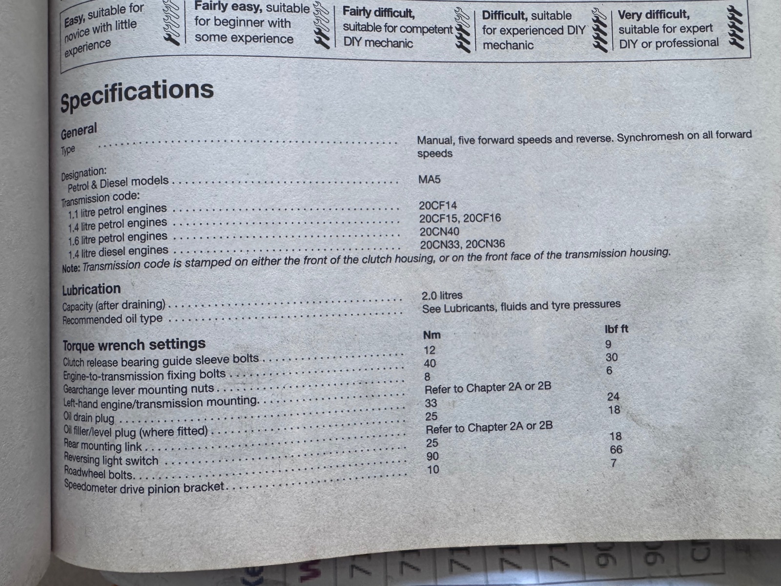

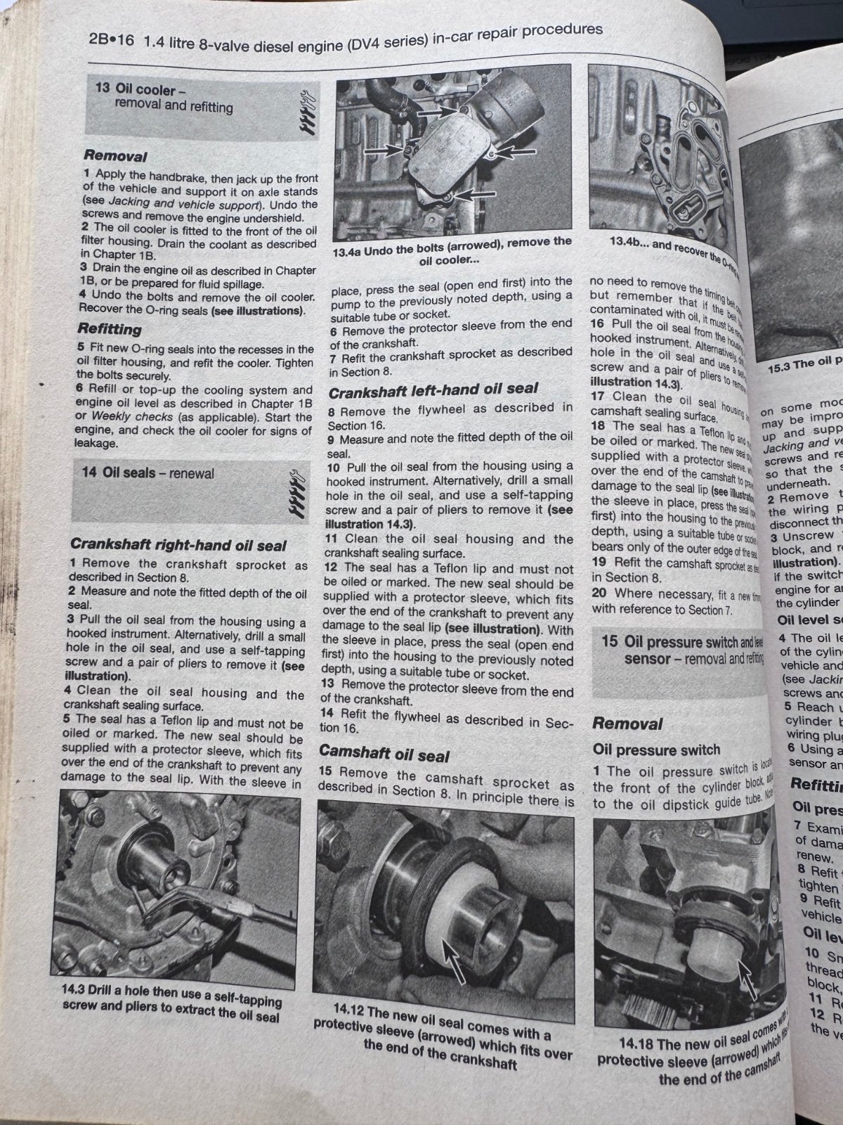

wurlycorner
- Posts: 2177
- Joined: 30 Oct 2012, 22:37
- x 271
Re: Citroen C2 1.4HDI - Clutch Change
A few relevant pages from what you mention above.
EDIT: The engine pages below are from the PETROL engine section of Haynes. See later post for the Diesel engine pages.
Really do recommend buying a copy for yourself.

wurlycorner
- Posts: 2177
- x 271
Sorry - I was doing that on my phone and posted the pages from the petrol engine section (you'll see that at the top of the pages).
These are from the Diesel engine section.
Mechanics in non-dealer garages won't access the official PSA service information, but will refer to something like 'Autodata' for specs and information when needed.
That information should reflect the correct manufacturer torque specs - but they will only do that for 'critical' bolts (e.g. cylinder head bolts). Otherwise yes - they usually won't bother and just use generic torque specs, 'experience', or 'FT'.
