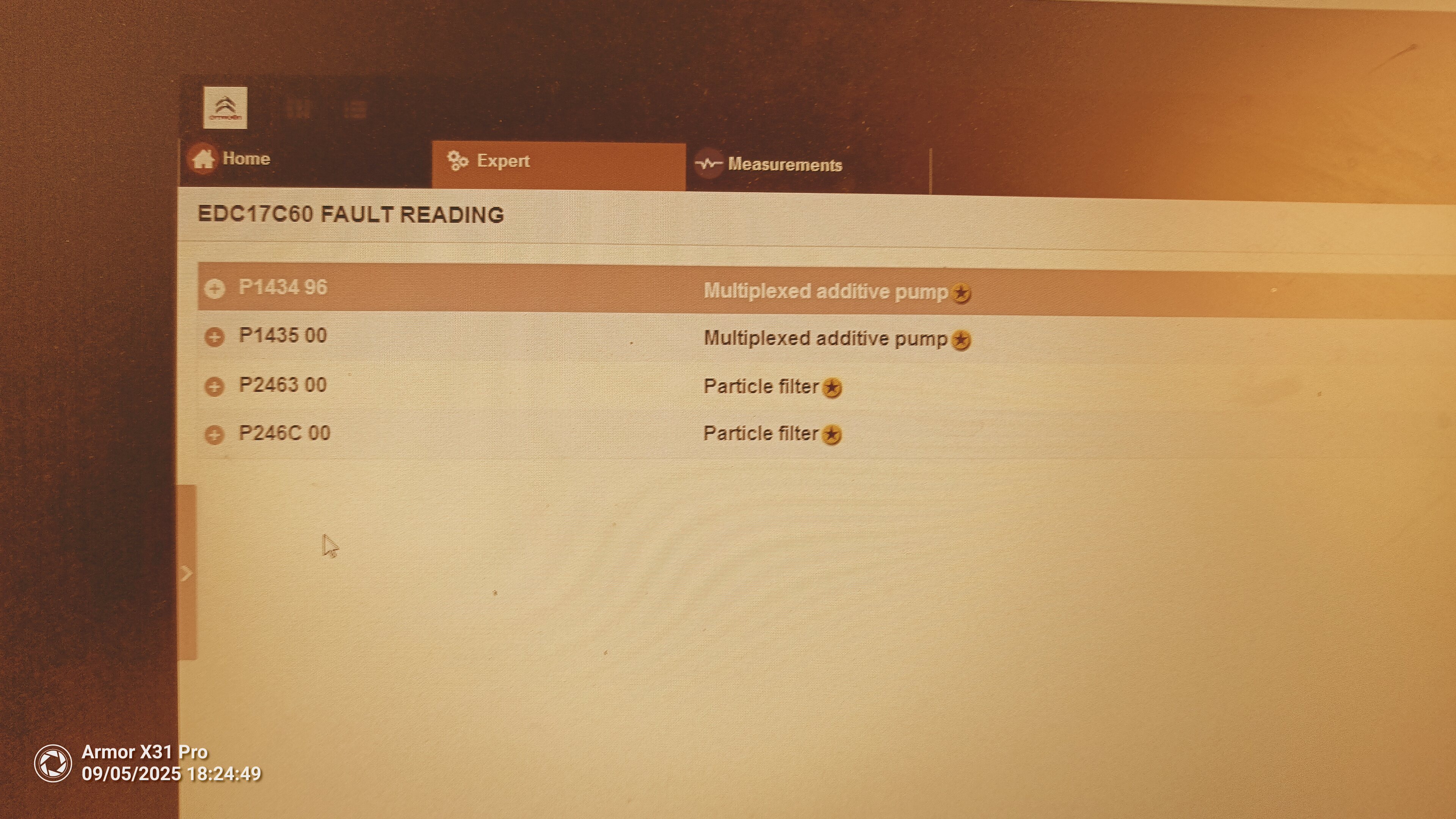

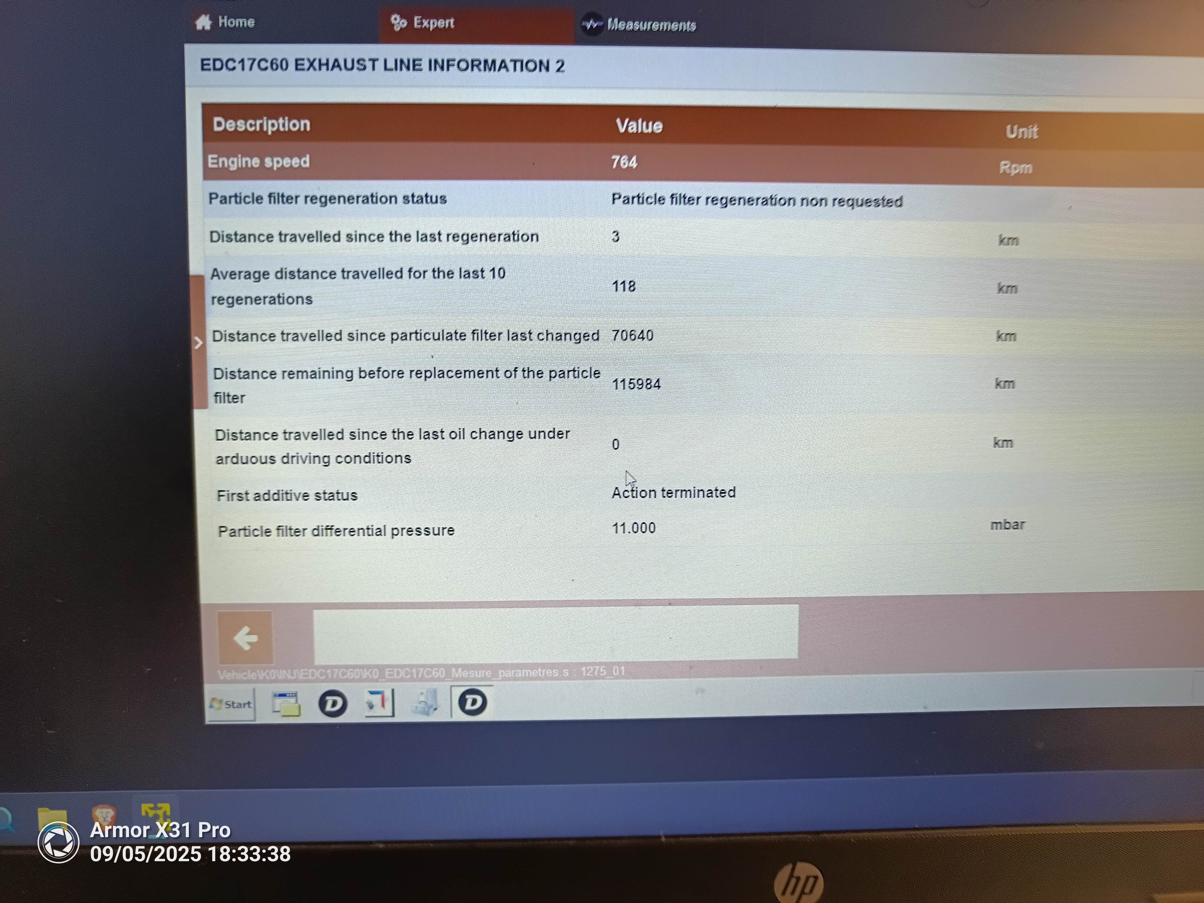

So onto the problem, the codes I'm getting are these.

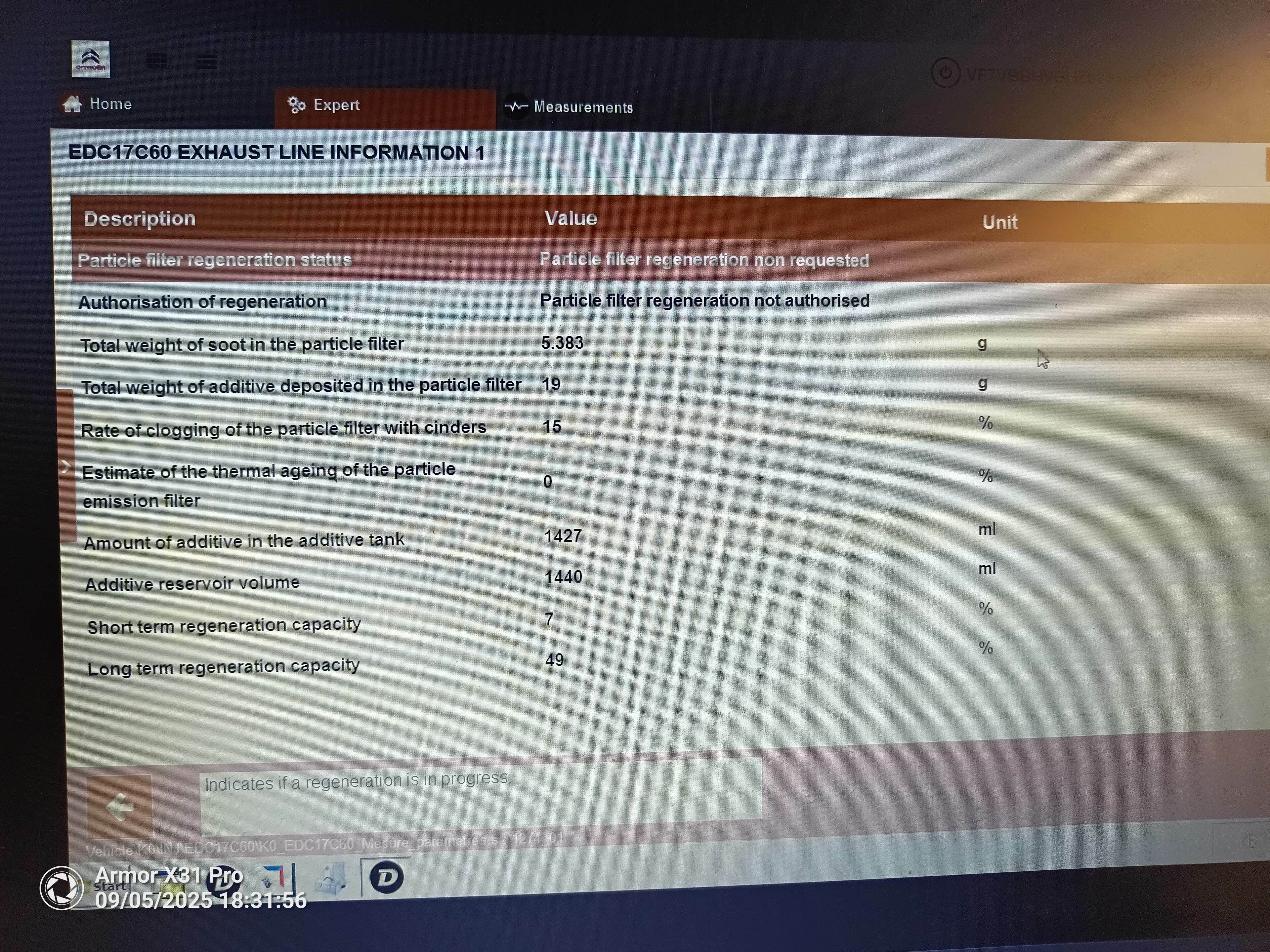

I've definitely told the vehicle its had a new DPF, how does it determine its clogged other than the differential pressure sensor, there aren't any other sensors on it as far as I'm aware and the readings at idle are
As for it being illegal to delete it I cant see that, that would mean that it would also be illegal to drive with an empty pat fluid tank but there isn't even a level indicator on it, people could drive round for years with a none functioning system, its not like checking a bulb or washer fluid.
Anyway according to Jimmy O'reiley its not even really needed.

3000 revs (shows 2200 but slightly delayed data)

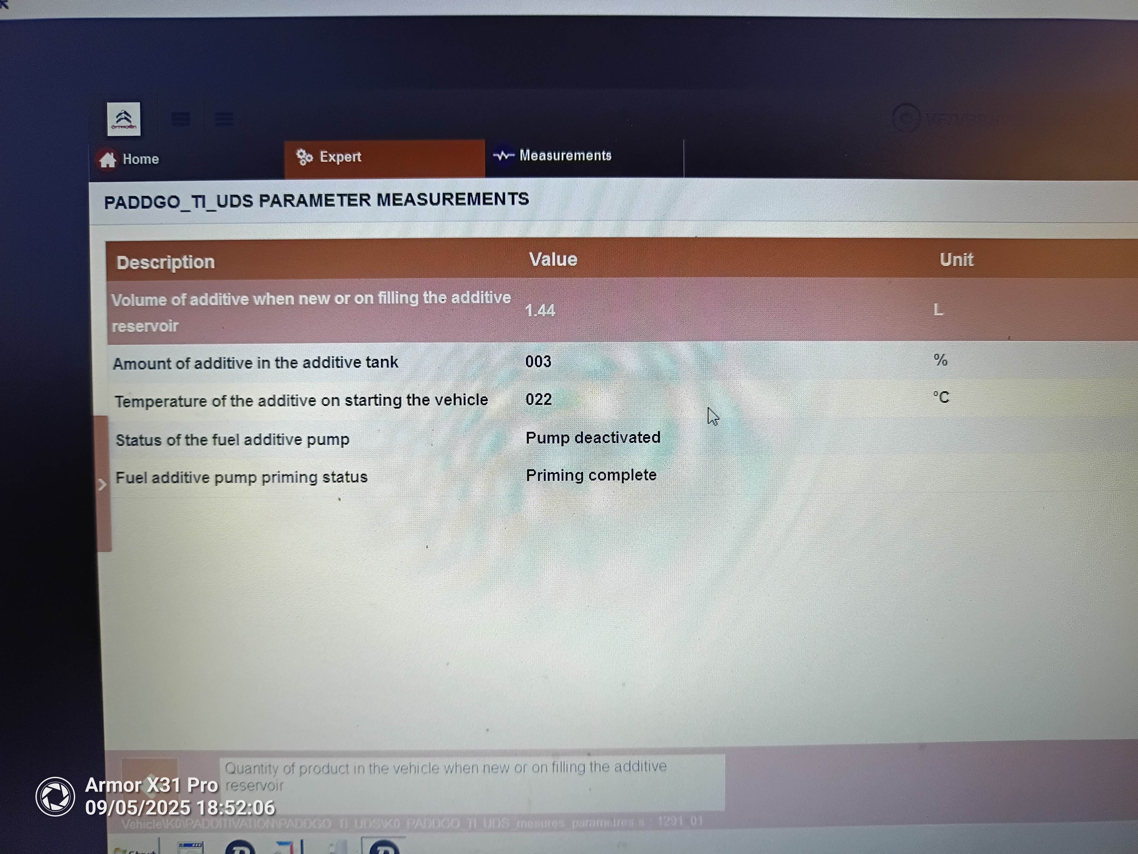

This is the bizarre thing though, on one page it shows the reservoir is nearly full
Yet in the pump section it shows its empty and for the life of me I cant find where you reset that.

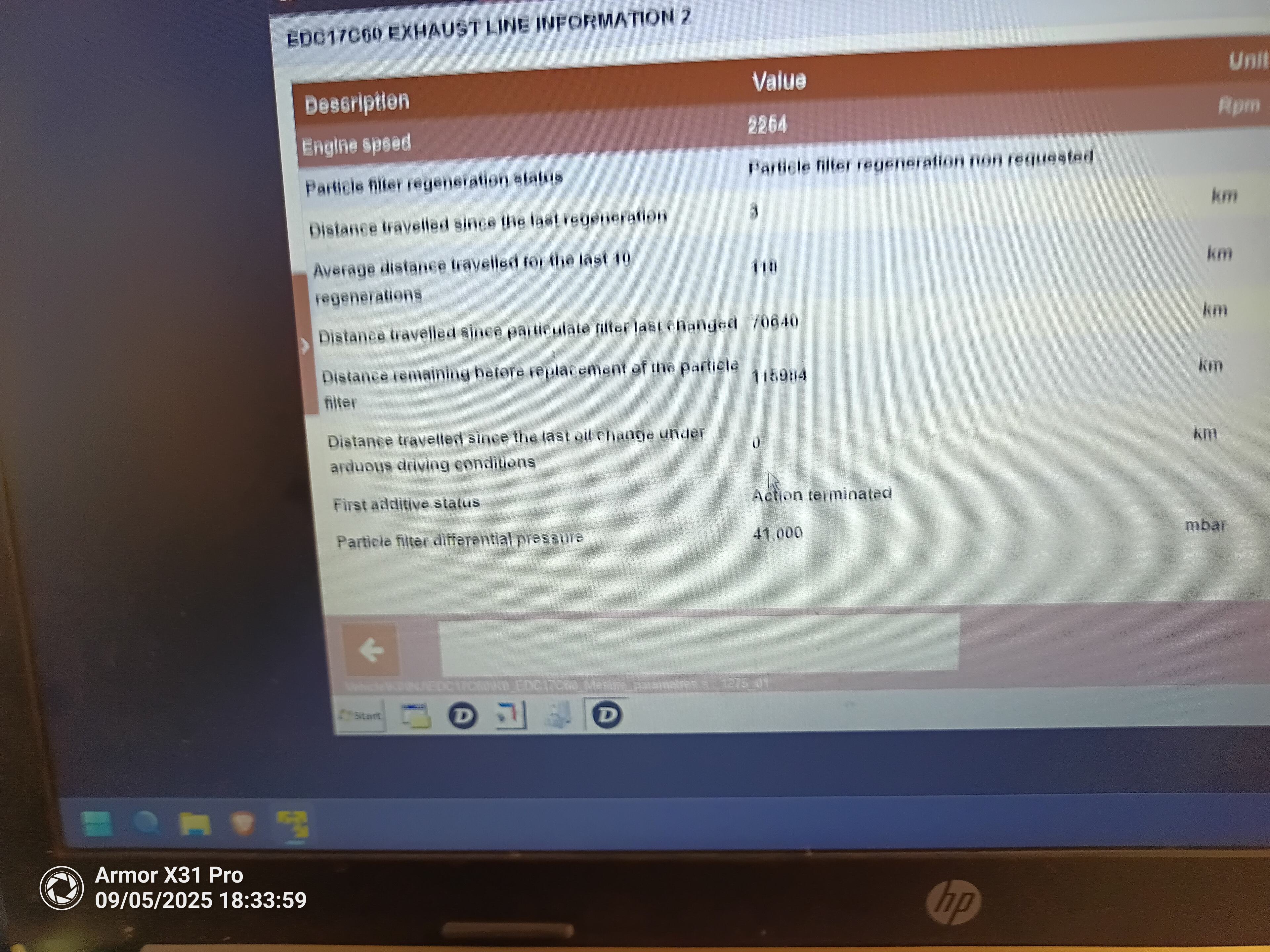

Just noticed as well, its says its done 70k Km since the DPF was replaced yet I told it it had had anew one earlier today, is that something else you have to update in 10 different places as well.

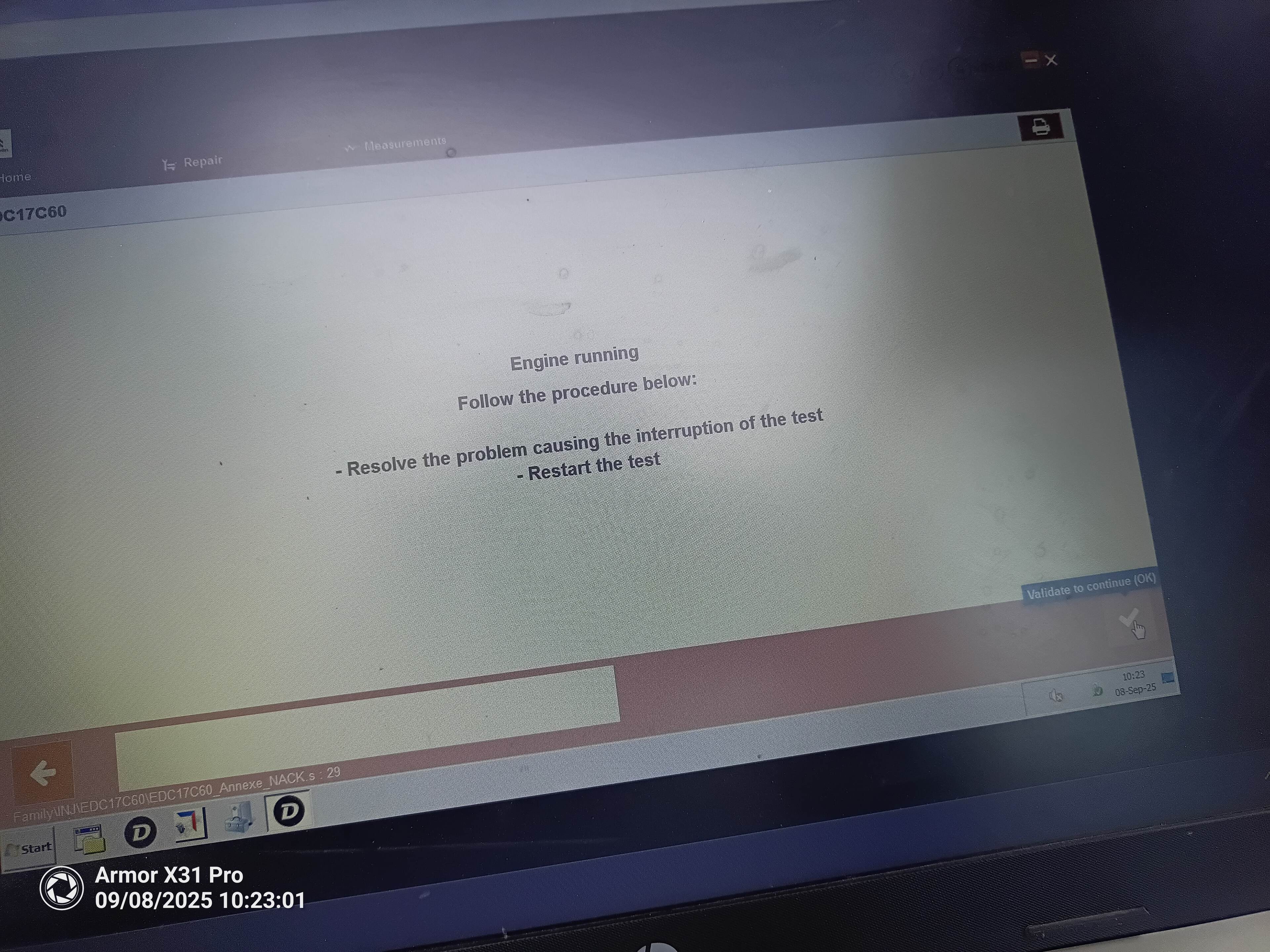

Slight update, I took the DPF off, left it sat in Wynns off car cleaner for the night and flushed it through this morning, back on the car and strangely at first the pressure differential was way higher than it was before, about 230mb compared to 40 before at 3k revs. However it soon came down to about 20 @ 3k and 2mb @ idle, obviously it was still full of water and cleaner. So thats the DPF blockage sorted but try as I might I cant get to tell it its had a new DPF, I thought I managed it the other day but obviously not.
I go into the repair menu and select new DPF, it tells me to start the engine, which I do (I 've tried it cold and hot) and the this page comes up -
What does that actually mean?

Have you tried just doing it with the ignition on without running?
Its been awhile since i done this with Diagbox but i cant ever remember asking me to have engine running.

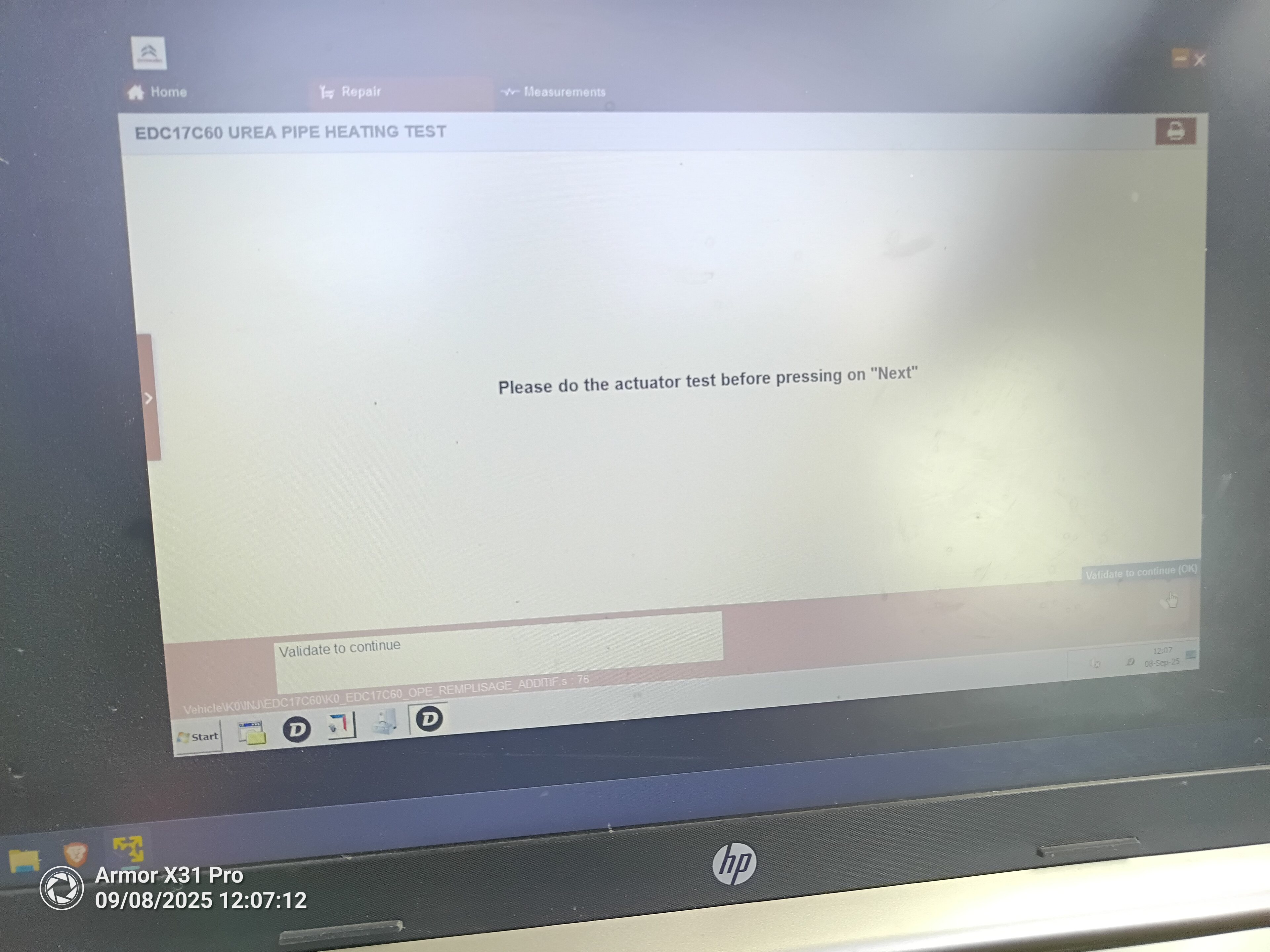

I've tried everything, at least its out of limp mode now but I still have the PAT reset problem, I actually managed to reset the PAT fluid in one menu but it still shows an empty tank on the pump page and still has the additive error, there is another place to reset the fluid but again when I go forward from that page it then brings this one up :-
As you can see the title above changes to the UREA PIPE HEATING TEST despite being in a totally different section the page before, could be a software bug or maybe I need to test that sensor before I reset the fluid, who knows, ran out of time today.
I actually removed the pat fluid tank and there was plenty of fluid in it already, maybe half full, I managed to get about another half a litre in it before it was totally full, so not sure what's going on with that one, maybe the pump is actually faulty. Its certainly a strange system this diagbox V9. My other concern is because there is a PAT fluid error it might not re-gen and just clog up again although the data page said it last did a regen 3 km ago.
