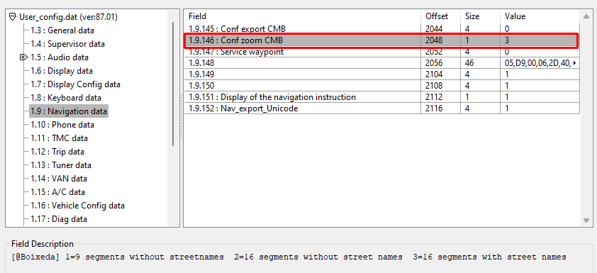

The solution: with a massive thanks to mira308 (MiraScripts developer) ...
Make sure the parameter 1.9.146. in the user_config file is set to either 2 or 3 (in my case, it was 0). This will result in sending the nav details to the matrix screen once again. The option 2 won't show the street names (only Zone not mapped text, but everything else will be displayed), the option 3 is 100% complete (with street names)
