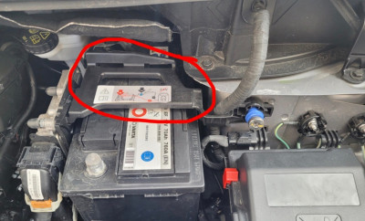

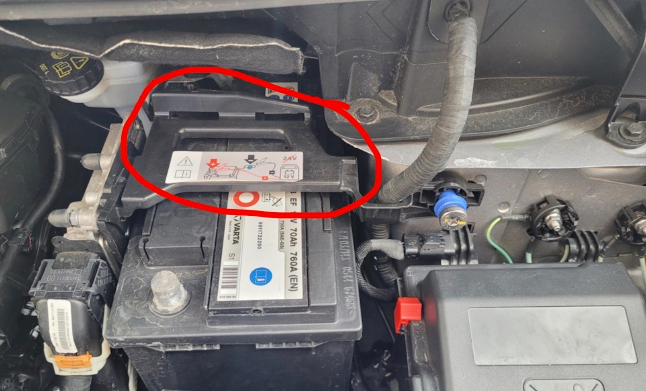

The issue I’m facing now is that the battery is very difficult to remove because of this plastic bracket (photo attached, not mine but all permissions to share were granted). It blocks access, and in order to disconnect the negative terminal I need to get it out of the way. I don’t want to touch the positive terminal because of the risk.
Could you please tell me if this bracket can be removed, and if yes how to do it safely?
Thanks a lot in advance!
Thanks a lot for the BSI reset advice and for the guide you shared, really helpful!

Re: Citroën C5 Aircross 2019 – Black Multimedia Screen After Battery Discharge
I'd hope (perhaps foolishly) that the owners manual would tell you how to remove the battery - worth checking.
My (somewhat limited!) experience with modern Citroens has been that they do sometimes design them so that batteries are able to be changed without resorting to any tools - it's like that on both my C5 Mk1's and on the C2 I had (though not the X7 where the battery is in the boot...).
With that in mind and looking at the photo you've helpfully provided, it looks like the bracket runs over to a fastener on the right hand side (where the bolt has a blue surround - seems to also double as the 'negative' stud).
One of the black parts there looks like it *might* be a quick release 'wing nut'? So worth checking if the black part there can be rotated by 90 degrees or something - and that releases the bracket?

Thanks for the detailed explanation, makes perfect sense. In my case, to remove the positive terminal I only needed to lift the small cover and the terminal came away together with it.
To make sure the terminal didn’t touch the car body or any ground points, I put a pair of synthetic winter gloves over it (but non-conductive material should work) and actually used two gloves just to be extra safe.
Best,
Rundanis1

Yes those ‘quick release’ terminals where you lift a lever to release the clamping force are what is on the three modern Citroens I mention above. I really like them, compared to the bolt/nut to tighten type.
That’s part of the ‘no tools required’ to change battery design.
