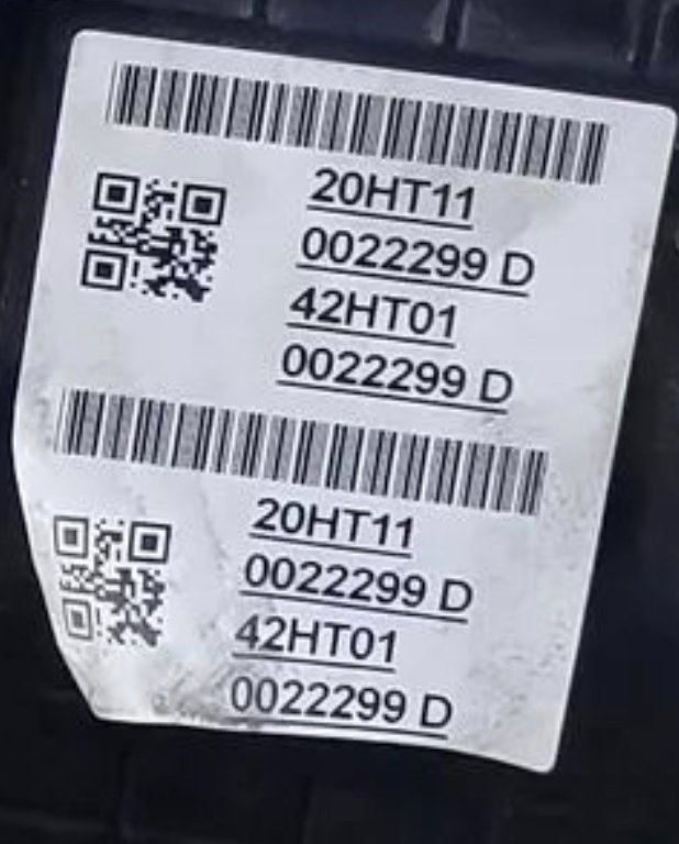

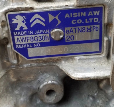

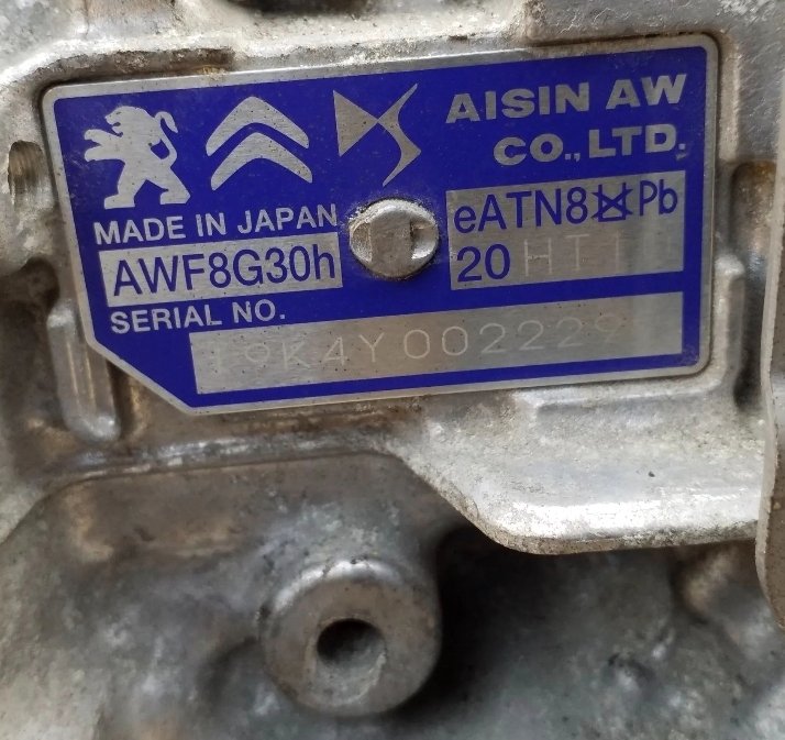

Found it!
It's written on a sticker on the plastic pan on the front of the gearbox and also on a blue serie number plate on the left side of the gearbox.
Sample pictures below for 20HT11, mine was also a HT11!

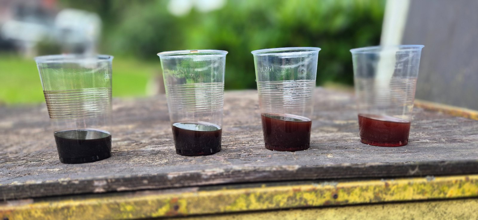

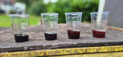

I flushes 3 times, emptied and filled it and went through the gears in Sports mode with the save electricity set to full to force it to start the engine and use the gearbox.
Took all in all around 4 hours including the test-drive afterwards.
Here is a sample from allt the changes(first to the left) not really totally clear in the end but much better then before.
It shifts better but I could be biased after working for 4 hours 😃

Hello , is there a way to learn which number of gearbox i have without lifting up the car ?
trollkarlen
Posts: 81
Joined: 15 Nov 2023, 02:24
x 4
Re: Oil change eatn8 gearbox
Unread post by trollkarlen »
The first image is on the front of the gearbox on the plastic cover. That you can see from the hood. Maybe need a mirror or your phone.
