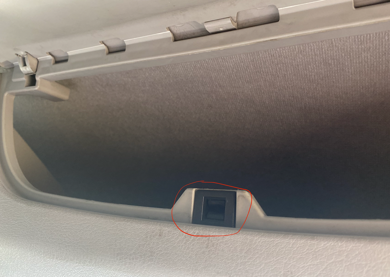

I'm hoping someone might be able to help me with something, I've just got a fantastic Citroen Dispatch/Jumpy van which was made in 2015. The van has got overhead storage but I've noticed one of the cabins doesn't shut. While looking at the other one I've noticed a small black clip that is missing? Wondering if anyone else has had to get hold of this part of might have a good location for these kind of spares? I've tried on eBay but struggling to come up with probably the right name for this.

For the benefit of us non Dispatch owners could you post a picture of the clip you have got and the flap that has it missing and you may get some informative replies then :)

Ah yes apologies included attached, this shows the cabinet with the clip included.

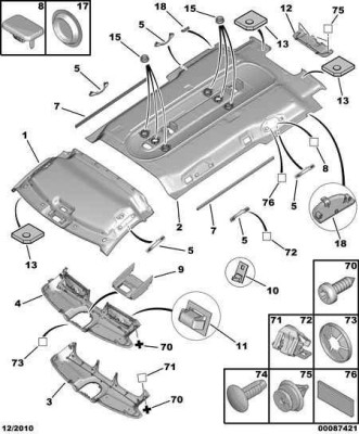

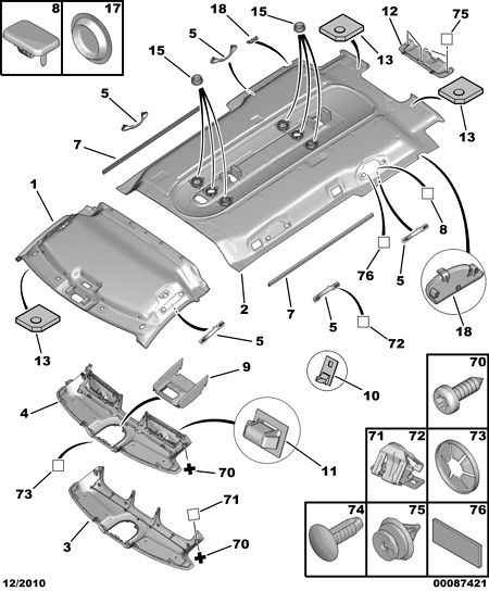

Is it #11 in this diagram? The Citroen part number is 8331QT
Sometimes this type of thing is surprisingly cheap from the dealer, but sometimes you have to buy a bag of 10 which pushes the price up.
