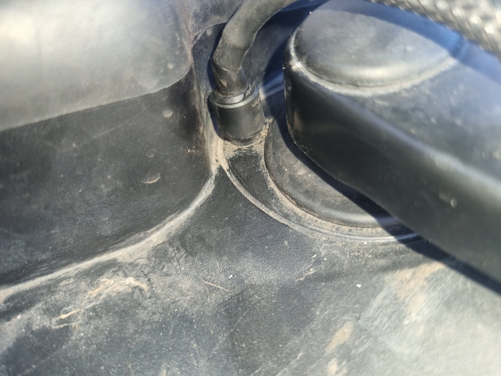

Hopefully someone can help me, I went to the garage to get a new screenwash pump. When ai got the car back pump worked, as it was flying out on the rear window, but on the windscreen, icould hear the pump but very little coming out in drivers side and nothing on passengers side.
Garage tried telling me a washer had been damaged and will need to buy full hose.

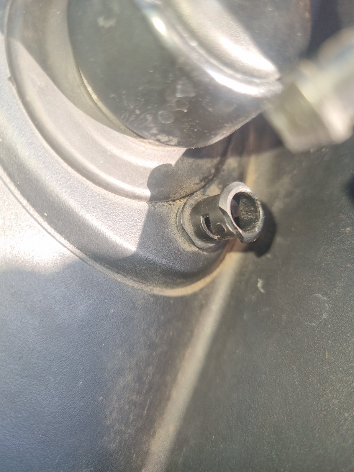

When I have looked the passengers side hose is lose at point of connection to the other hose where the wiper is. When I have looked there is a plastic clip/ locking fitting to keep this in place when it pushes in.
Any idea what this is called so I can order a new one? I have tried googling but it just comes up with the clips to hold the hose rather then to lock together

From what I can see that is a push in and twist fitting like an old light bulb bayonet. So are the pins inside the cap broken away or even worn down so they don't protrude into the socket when you twist it? If so there is a working bodge that you can do to make it work? :-D

The cap is missing on the drivers side so need it replacing. I just do not have a clue what it is called to look for a new one
