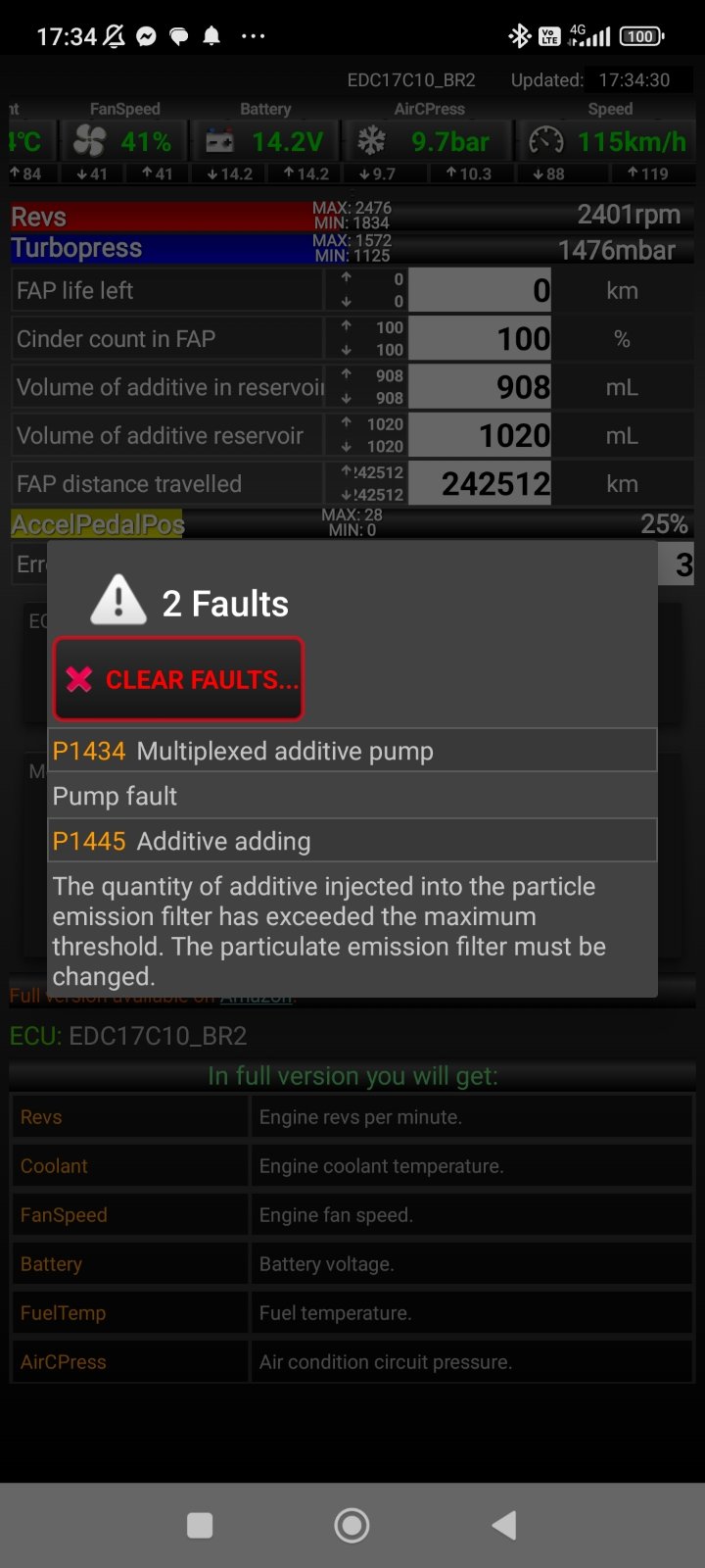

Hi,
One week ago I got message engine repair and risk of dpf filter clogging.
P1445 and P1435
Normally I drive around 60 km to work and to pick/leave my daughter at school every other weekend so my car do mostly get the chance to regen.
I have an Chinese obd2 and torque pro which didnt provide me with anything interesting except for the faultcodes.
I have also tried car scanner and FAPlite which tells me that FAP is full. Should I buy the program to get more info, the problem is my obd2 keeps losing connection to faplite all the time but not to car scanner or torque pro.
If I delete the fault they return either when turning ignition on or after 100 meters of driving.
This friday me and my friend tried to clean the dpf with Wurth dpf cleaner spray straight in the dpf by removing the top sensor and then I took the car for a drive on the highway in third out of five years for 25 minutes and drove between 3500-4000 rpm but it didnt help.
My plan now as you can see on the image is that the calculated dpf distance is 0, is to reset dpf and soot if possible and hopefully will that trigger eolys pump to work again or do you believe its faulty? My thoughts is that if ECU says dpf is full it turns off the pump🤔?
If reseting dpf and soots doesnt help and I still get fault on Eolys pump, is there any OEM number for just the pump as I have seen someone else on the forum buying just the pump on eBay.
What is the cheapest solution to reset dpf and other things in the future? Is it diagbox and do I need the full version? My car is a Citroen c4 2011, version 2 with a 1.6 hdi (NC9HP*) with vin number VF7**************[VIN obfuscated, can be read by forum staff].
Edit: I forgot to mention I added Eolys last year and it hasnt said anything about it since then.

If you've cleaned it and the differential pressure is low enough, then you can just tell it the DPF has been replaced. That will clear P1445. Whether the other code clears is to be seen!

Thanks🙂, Any tips for what I need to tell the system that its been replaced? Cheapest working solutions since I dont do any work myself on the car.
Forum Treasurer
Posts: 12513
Joined: 07 Aug 2002, 17:12
x 1457
Re: P1434 and P1445 (engine repair and risk of dpf full)
Unread post by RichardW »
It depends on the scan tool - and not all support this sort of function. You are looking for something along the lines of replacement parts - replacement of the particle filter.

I have same car but from 2013, and had same error codes, it even turned off automatic gearshifting mode and I could use only manual paddles.
Solution: Use Kingbolen Ediag Mini (or cheaper scanner with explicit DPF Reset function) and buy the DPF Reset function in the app for $20. Also add 125-250ML (I did 125ML first, but after I added a few days later, without refuelling, 125ML more + 20ML of C99 the car woke up like a sprinter horse) of Mecarun Eco 10000 Diesel to a half filled fuel tank. It will decoke the DPF quickly, even within a few days.
