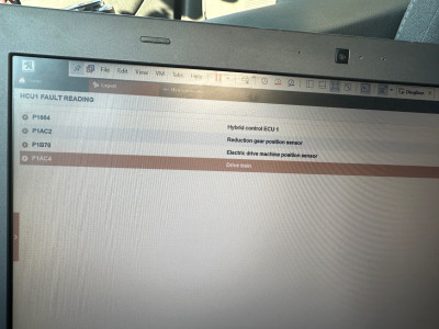

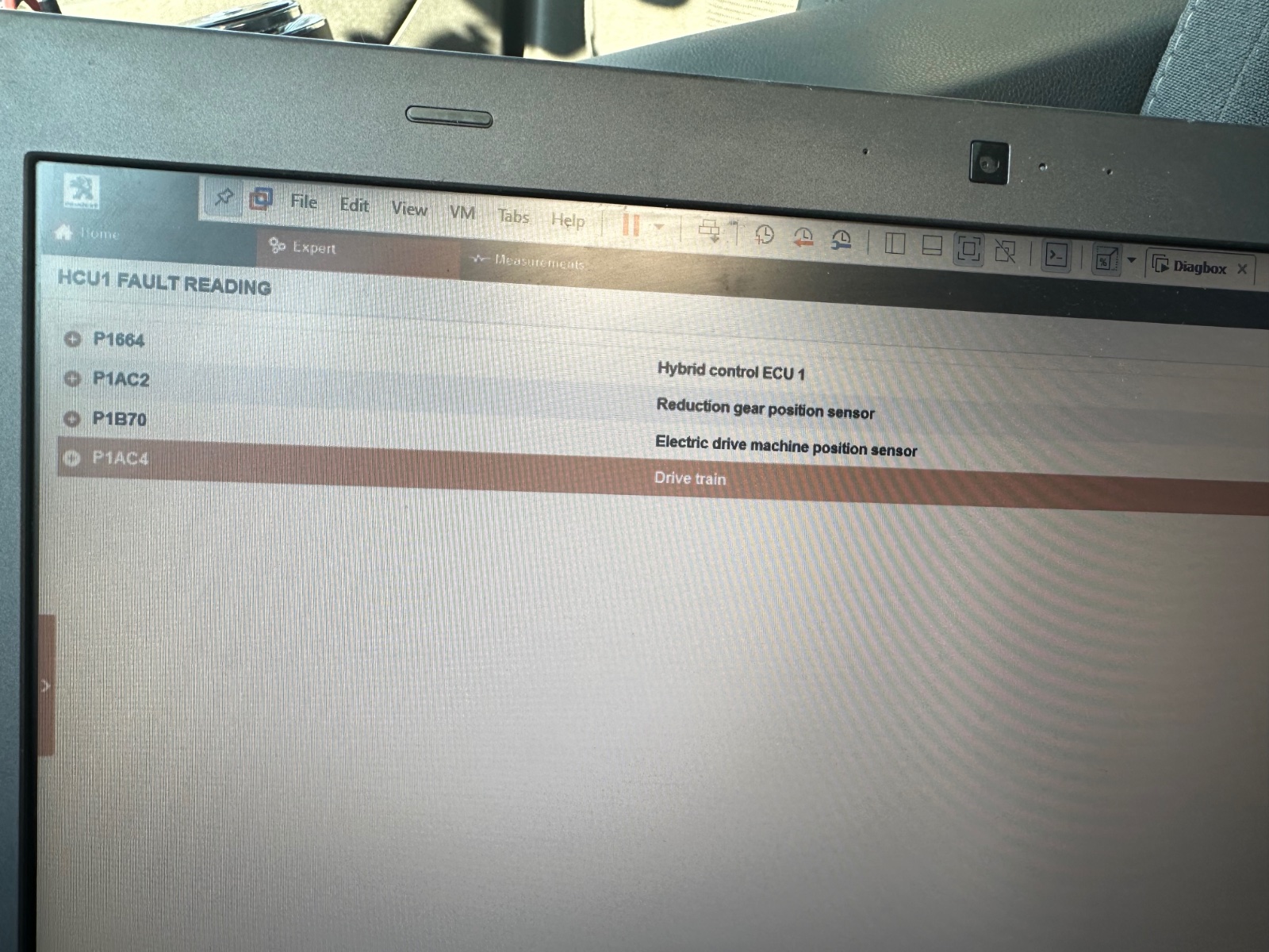

Hi I have a Peugeot 3008 hybrid 2015 and on diagbox I have fault codes attached as pdf photo codes are P1AC2- reduction gear position fault and P1B70- electric drive machine position sensor fault and P1AC4- drive train fault could these faults be because of the sensor and where is the sensor is it the sensor mounted on the electric motor differential?? Fault appears in hybrid mode when decelerating on over run as electric motor changes hybrid battery jumps out of hybrid mode!!

Sorry I attached the wrong photo on original post I have now updated the photo in this reply, do you think the repair is still new motor or possibly something to do with reduction gear position sensor or is this sensor the same one that is integrated in the electric motor!!

That's looking like a sensor problem and as that google search suggested, looks expensive. Maybe you have just found a fault these are going to suffer with.
