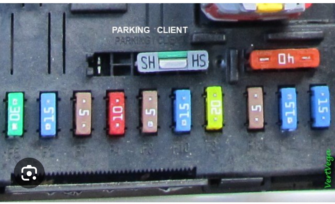

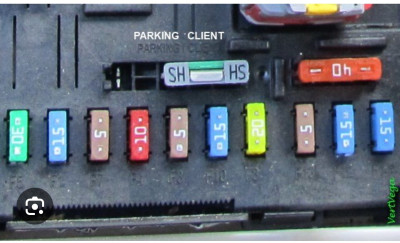

Check that the Shunt in the BSI is in the CLIENT position.

It has the standard radio fitted which works fine and the Shunt is in Client position - have also tried resetting the BSI by removing it.
