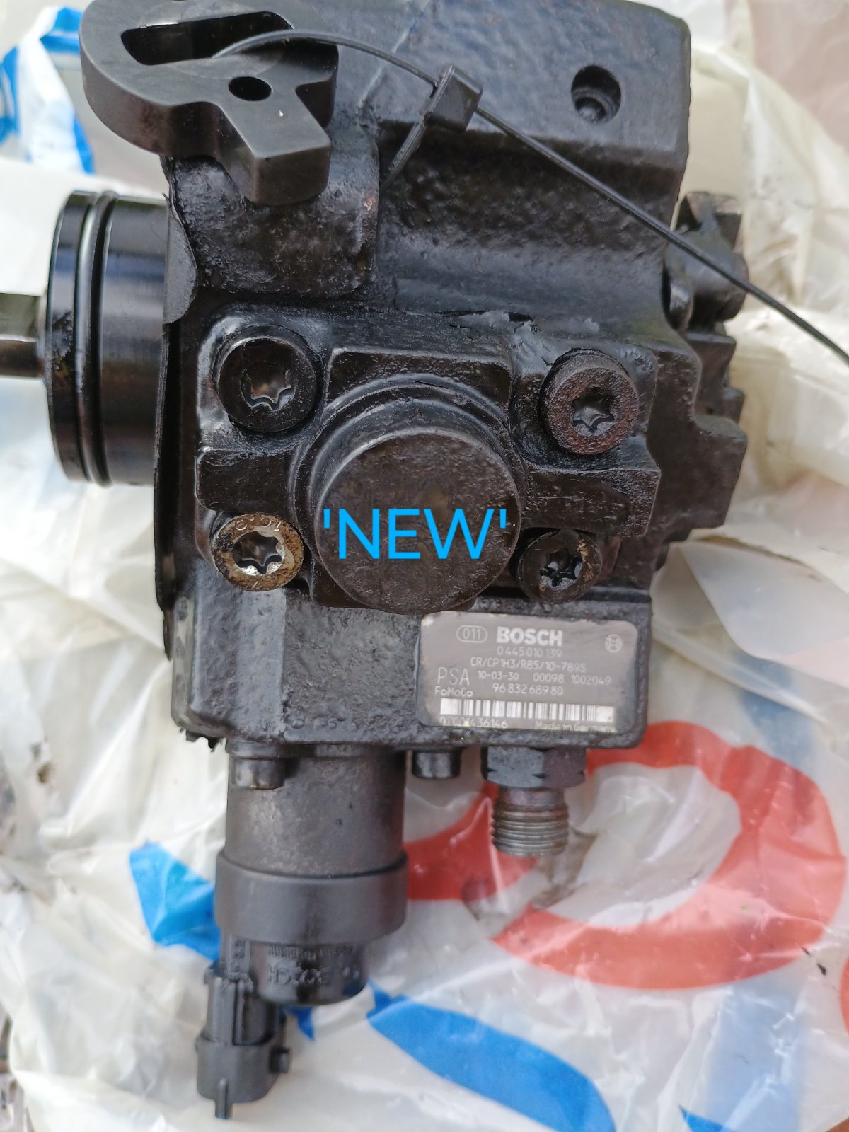

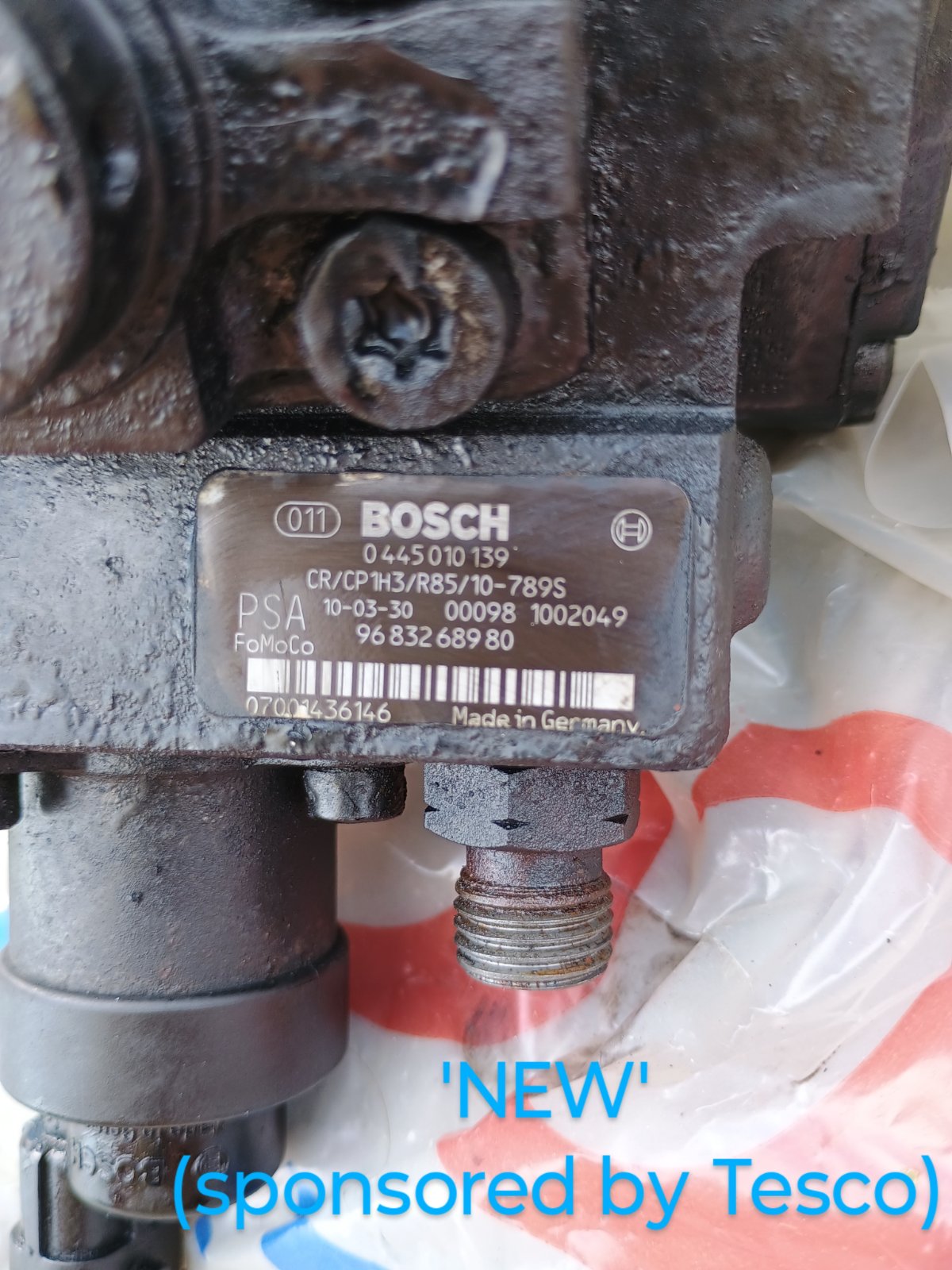

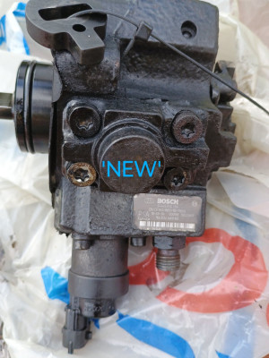

Fuel pump, ex- Land Rover, has arrived (yesterday afternoon)
Jokes about "your like a kid with a new toy at Christmas when some car bits arrive!" welcome!

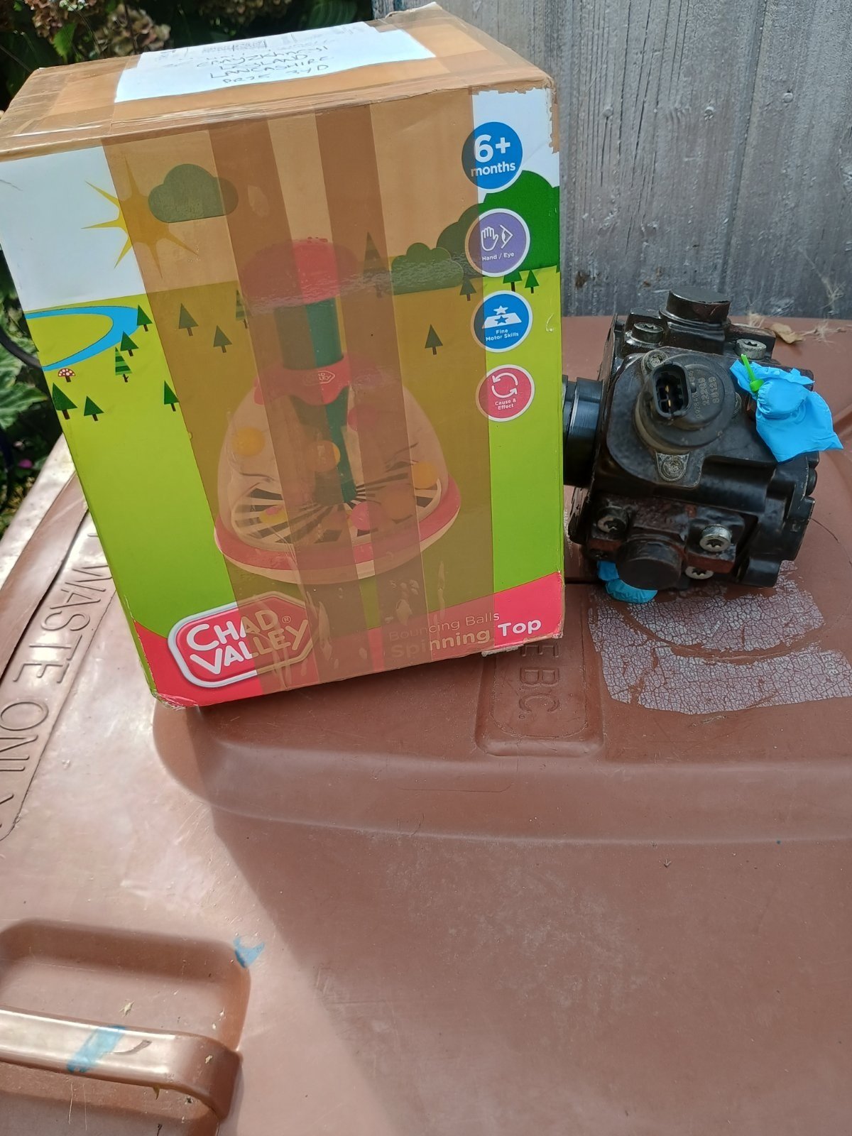

If the 6+ refers to mental age we are all screwed but some of the older participants might appreciate the exercise from using it.
Champion of Where's CitroJim
- Posts: 5308
- Joined: 25 Apr 2022, 09:03
- x 2341

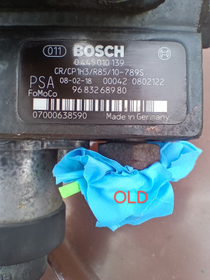

Ah, thankfully this is "6 months plus" so I've just about exceeded the threshold of competency for this - able to sit up unaided etcRp0thejester wrote: 08 Aug 2025, 17:38 If the 6+ refers to mental age we are all screwed but some of the older participants might appreciate the exercise from using it.

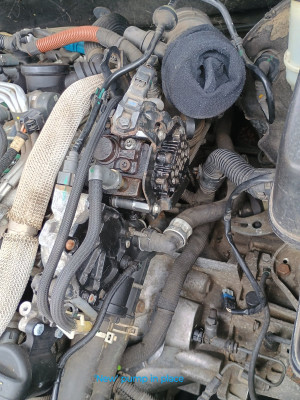

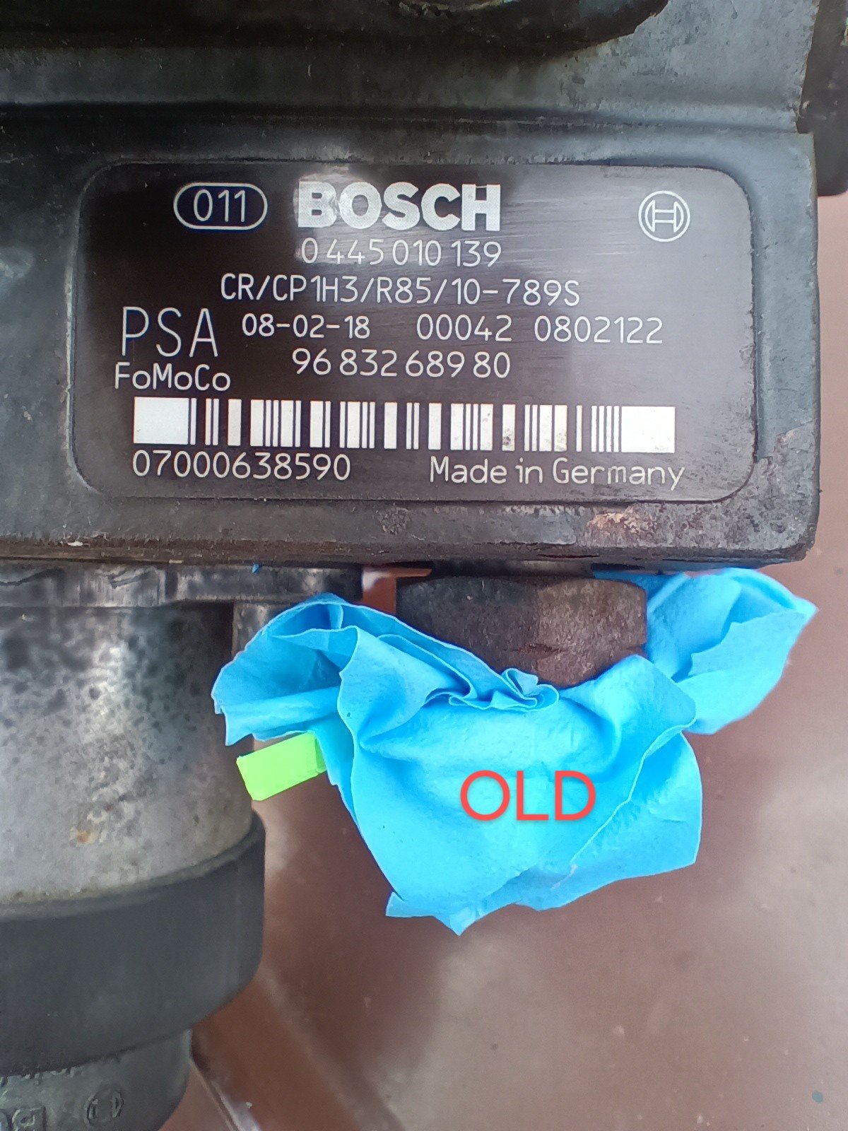

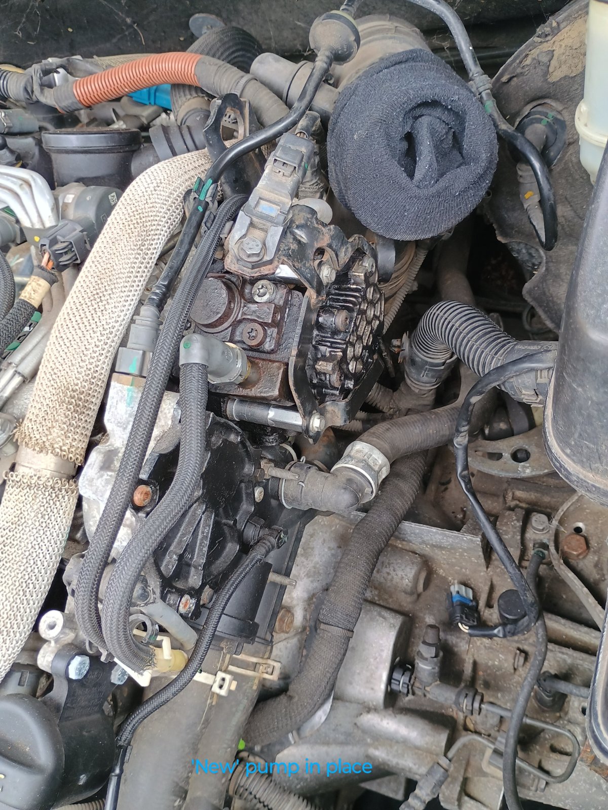

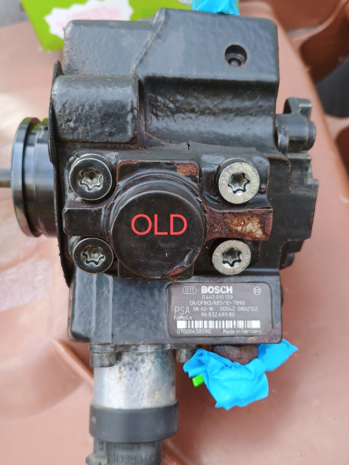

Sadly the 'new' pump has demonstrated this isn't what's behind the C5 non-starting. Performance with the new pump is identical: a repeatable "cough" but no more than a cough. Bloody thing.
Head scratching (and something to eat) is next.
Oh, and fur future reference: (accidentally) leaving the pump's high pressure fuel output connection only finger tight will not allow meaningful fuel pressure to build, but will allow it to piddle instead!
