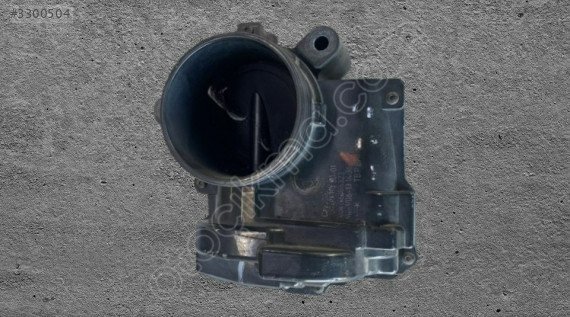

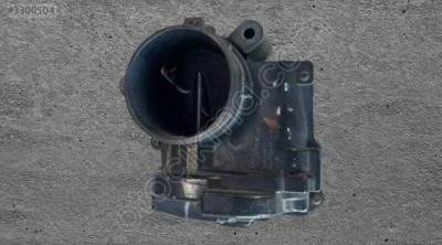

It's to late to take a photo but there is something like a butterfly
I have attached something off the web that's from a 1.6HDI
EGR been blanked, MAF new and MAP working compression good, turbo boost correct but white smoke and revs responding slowly.

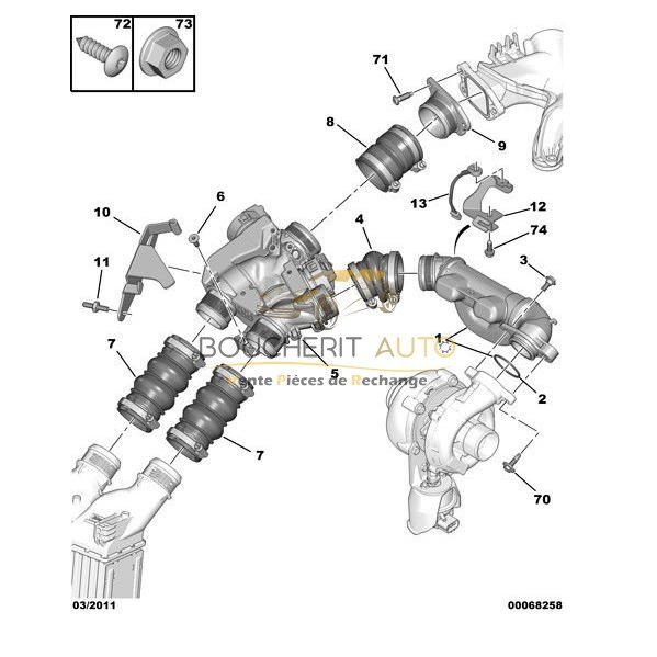

RichardW wrote: 05 Aug 2025, 20:15 There's no throttle butterfly on a diesel as such - they run effectively at WOT all the time. There might be an intake butterfly / doseur valve used for EGR control / DPF. What are you troubleshooting?
the doeur value you mention is shown on 5 below and thats thing with the butterfly
Now on https://www.berlingoforum.com/thread-27715.html this wonderful forum that defies all attempts to register at they explain that it bypasses the intercooler when cold.
