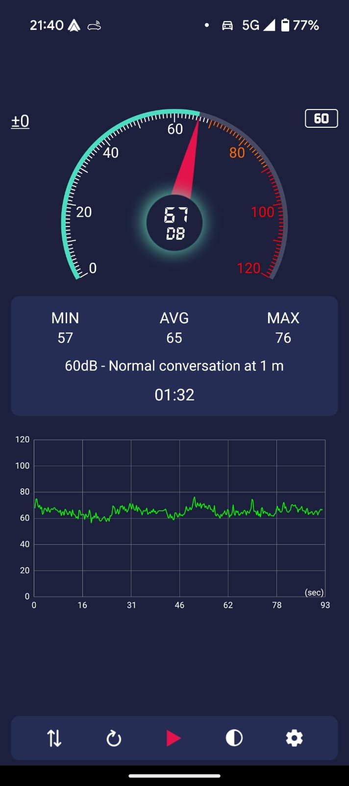

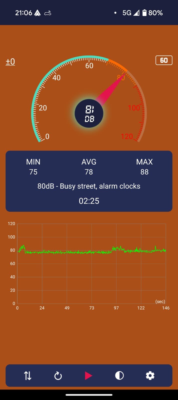

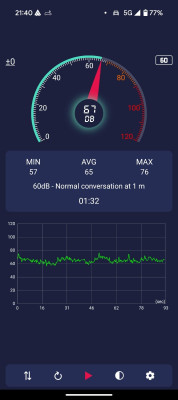

After getting my new car I always want to make it quieter. I've just been out tonight and sound tested it on 2 routes, I hold the phone in my left hand.
1) A drive at a steady 45mph in the centre lane of a 50mph road. Max Esave on. Average 78Db.
2) A few laps at the end of a tesco car park travelling at 10mph, electric mode. Average DB 65Db.
Tomorrow I'll start sound deadening the car and I'll see where I get to. I won't retest until I've finished the job, and when I've got the car mats it hasn't got now.
It's all a bit relative rather than actual but I'm hoping for quite large gains when I retest. It is worth noting the Db scale is logarithmic so 10Db higher from any level is actually doubling the sound. On that basis maybe low 70's and low 60's would be a reasonable expectation.

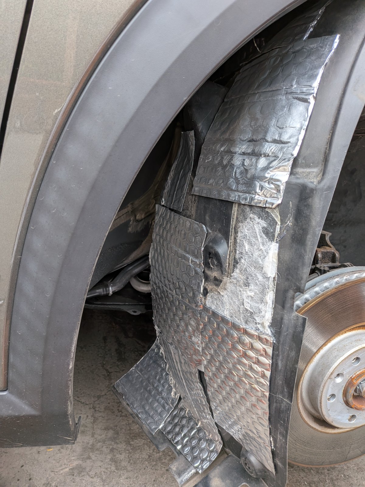

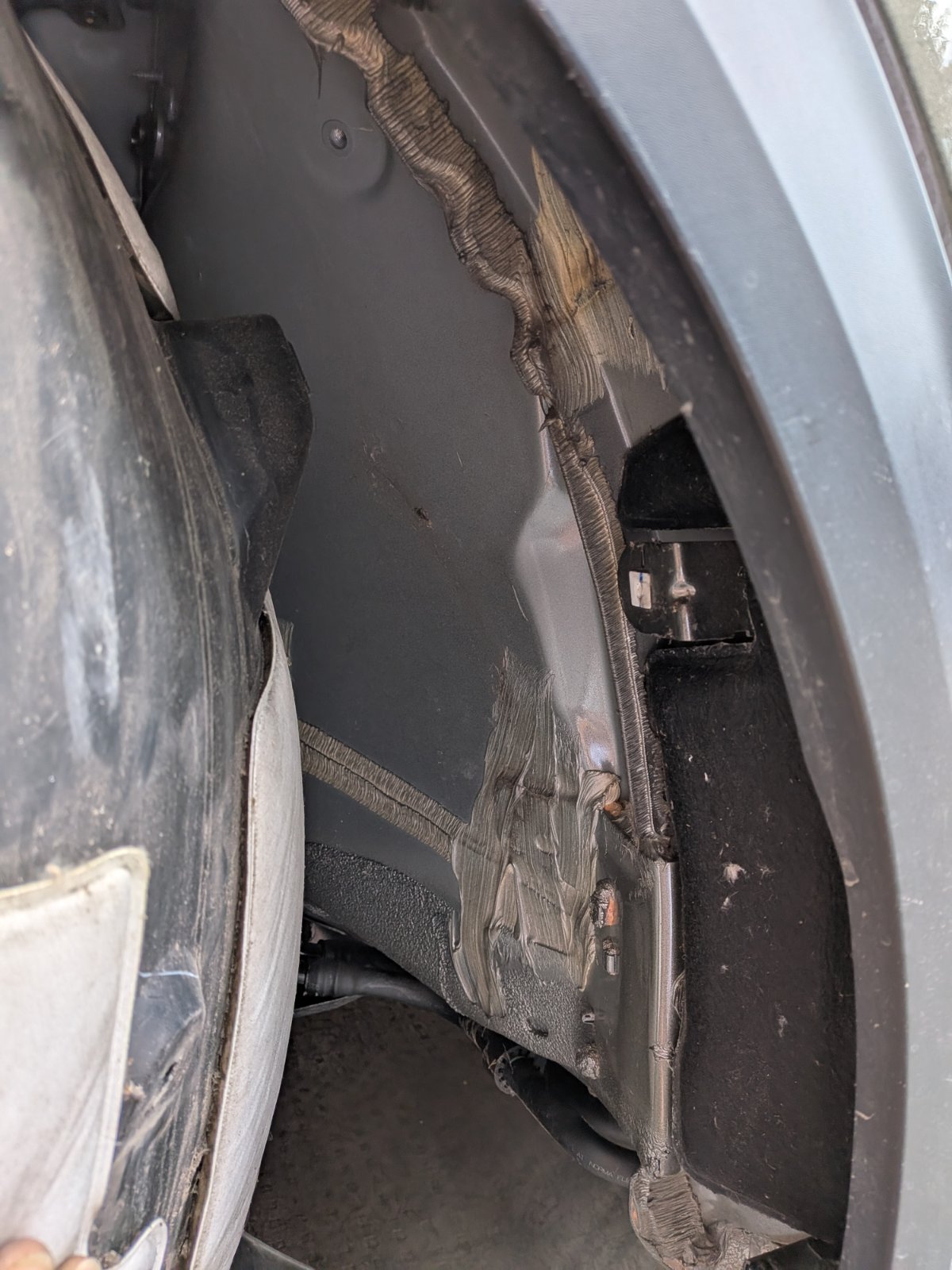

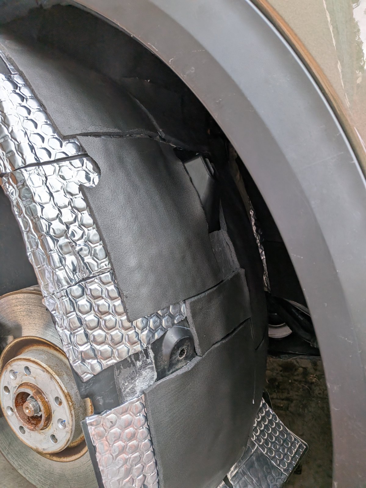

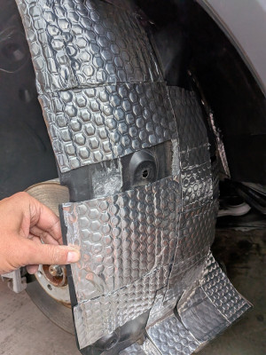

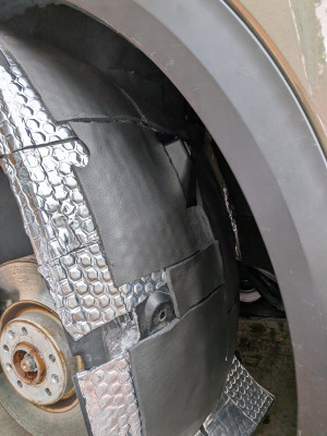

Did the front today at a leisurely pace, took about 4 hrs. There is a balancing act between putting too much in and then you can't affix the plastic wheel well back.
Hardly anything in there apart from very light cotton tampon type stuff when I looked, I just ripped em all off.
The rears are a lot easier, will do those tomorrow. Then it's into the easy stuff.
Random pics below. By the time I put it all back together there was dodomat shiny stuff on both the liners and body with closed cell foam on top. Some screws were hard to get back in but that tells me it's snug which is what I want.

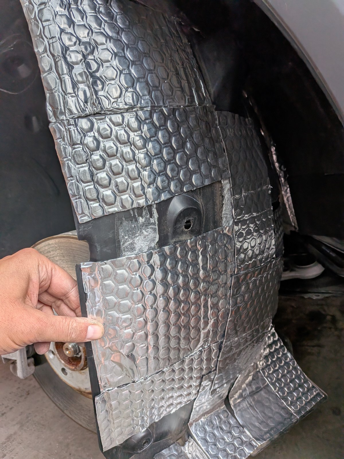

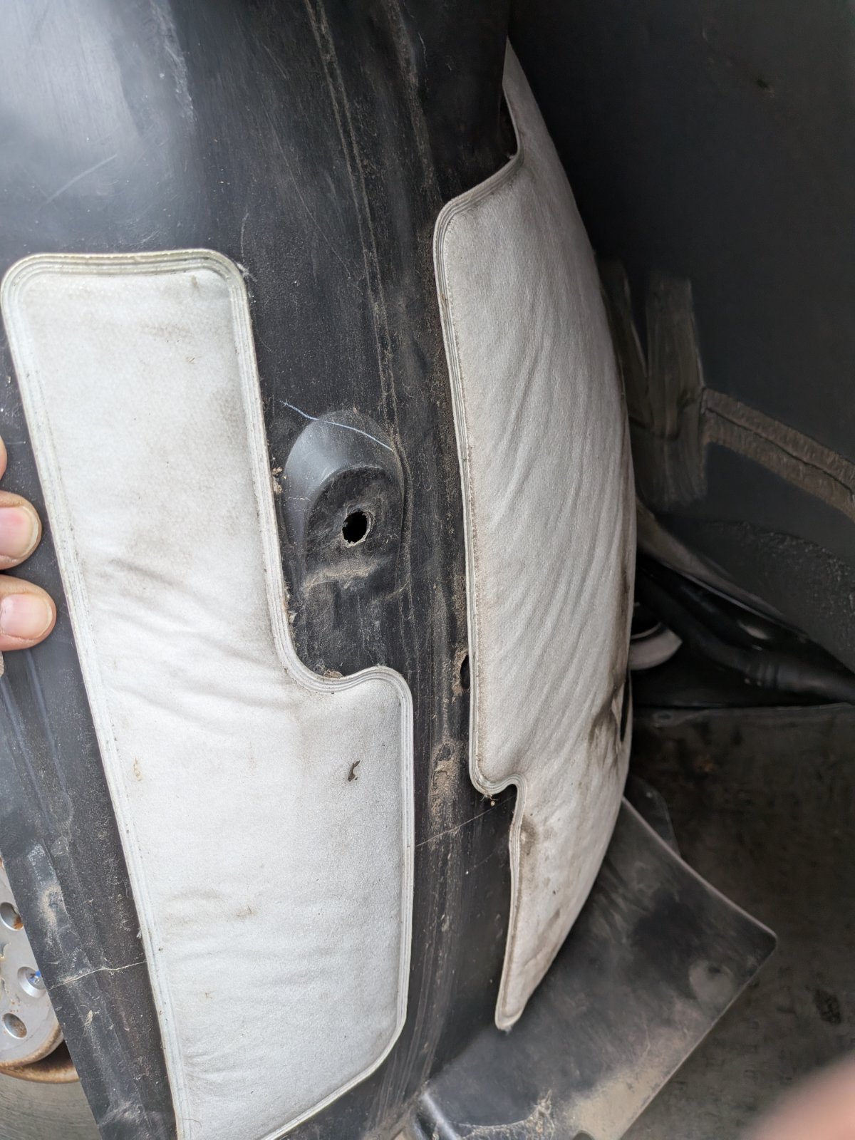

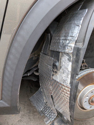

Did one of the rear wheel wells today, took a long time.Nothing in there at all sound deadening wise. In some places I put in 2 to 3 layers of dodomat plus 2 layers of foam on top
Used up probably the same amount on one rear wheel as I did on both the fronts yesterday. It's all gone now so will order some more.
When I'm done I can't wait to see what the difference is.

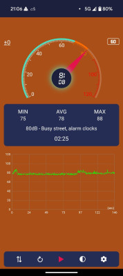

Tried it tonight with just 3 wheels done.
Compared to both original examples the Db meter read 1 less. This is subjective to a degree because of the rounding element. The tesco car park may have just dropped from 64.6 (rounded to 65) to 64.4 (rounded to 64, almost nothing. Conversely it could be 65.4 rounded to 63.6 which could be almost 2. The 46 mph route was reading 77 but I left it too late, hit a rough patch and it rose back to 78.
I'll just take it as 1Db.
The road noise still seems to be in the floor. I think the boot will make a big difference when I get onto that.
Going off the comments on here I'd be delighted if I could get to 62Db from an original 65Db.

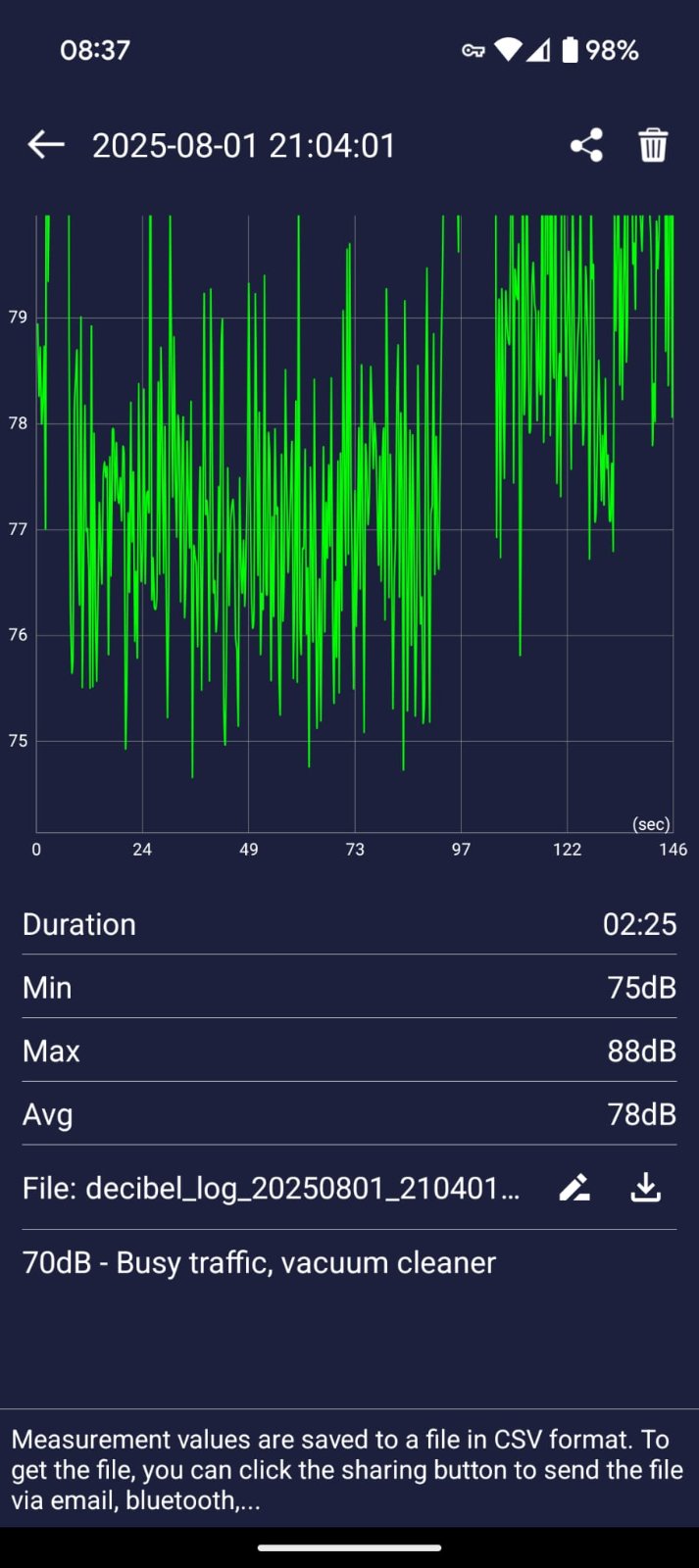

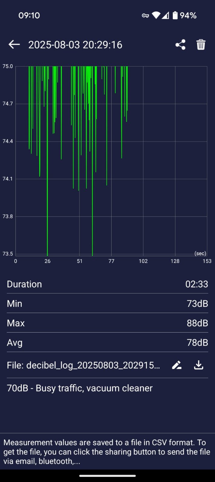

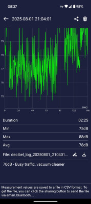

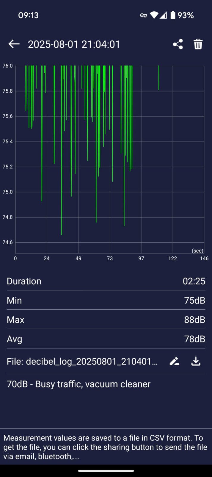

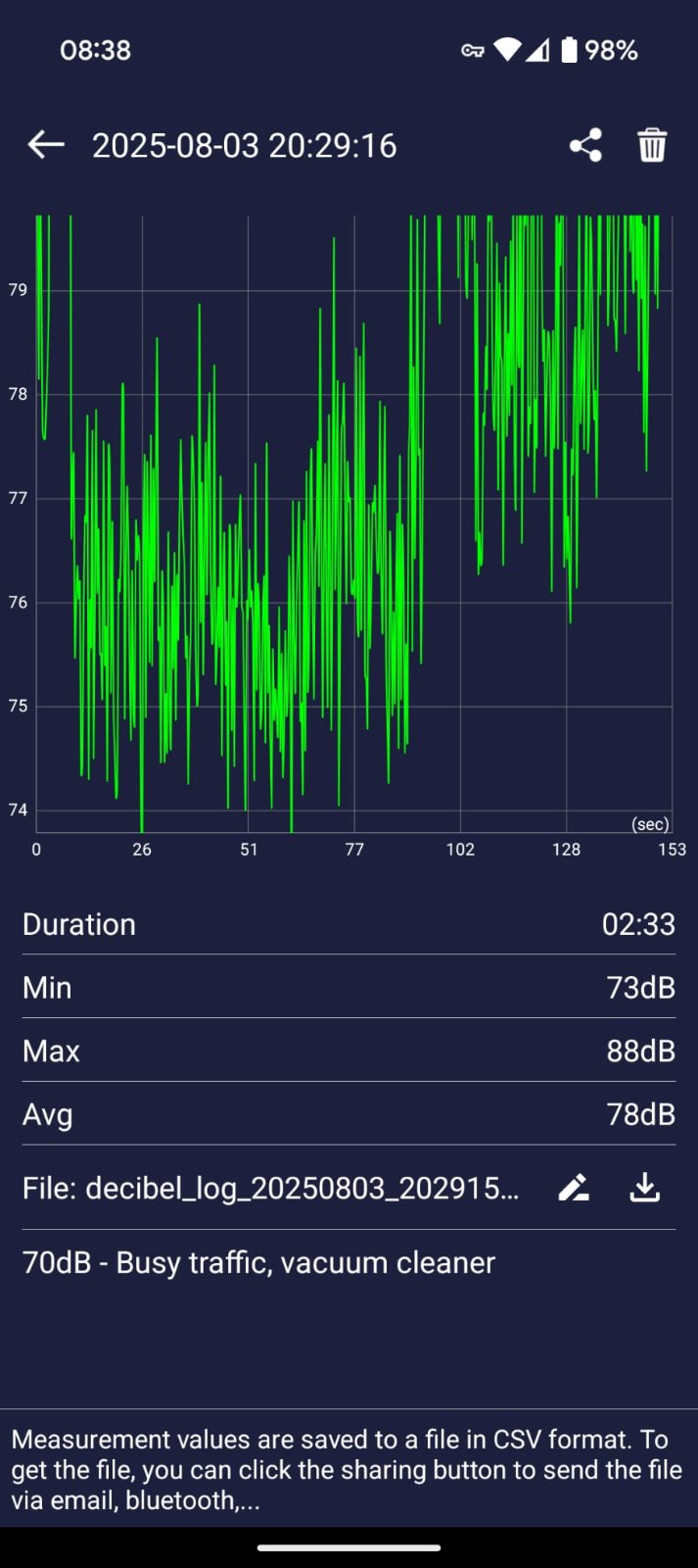

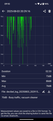

I've managed to get more precise detail via the app graphs and it's given me greater clarity. I'd have hated to have done what I have so far for a miniscule gain.
On the 45mph route there is a range from about 10 seconds to 95 seconds, so give or take a minute and a half where the readings are quite flat. I can't get actual readings but i can eyeball the graphs. There is a clear drop in the readings, the original over this range was centred around 77 (ish) and now its around 76 (ish), so we could say a 1Db drop. Top level estimate.
However I've then had a good look in the lower range 74.5 to 76 original and 73.5 to 75 new. Whichever of these shows "more green" adjusts the original 1Db up or down. After eyeballing them I can't really ascertain which is the winner so I'll stick with my original 1Db improvement, say a range of 0.9-1.1,
