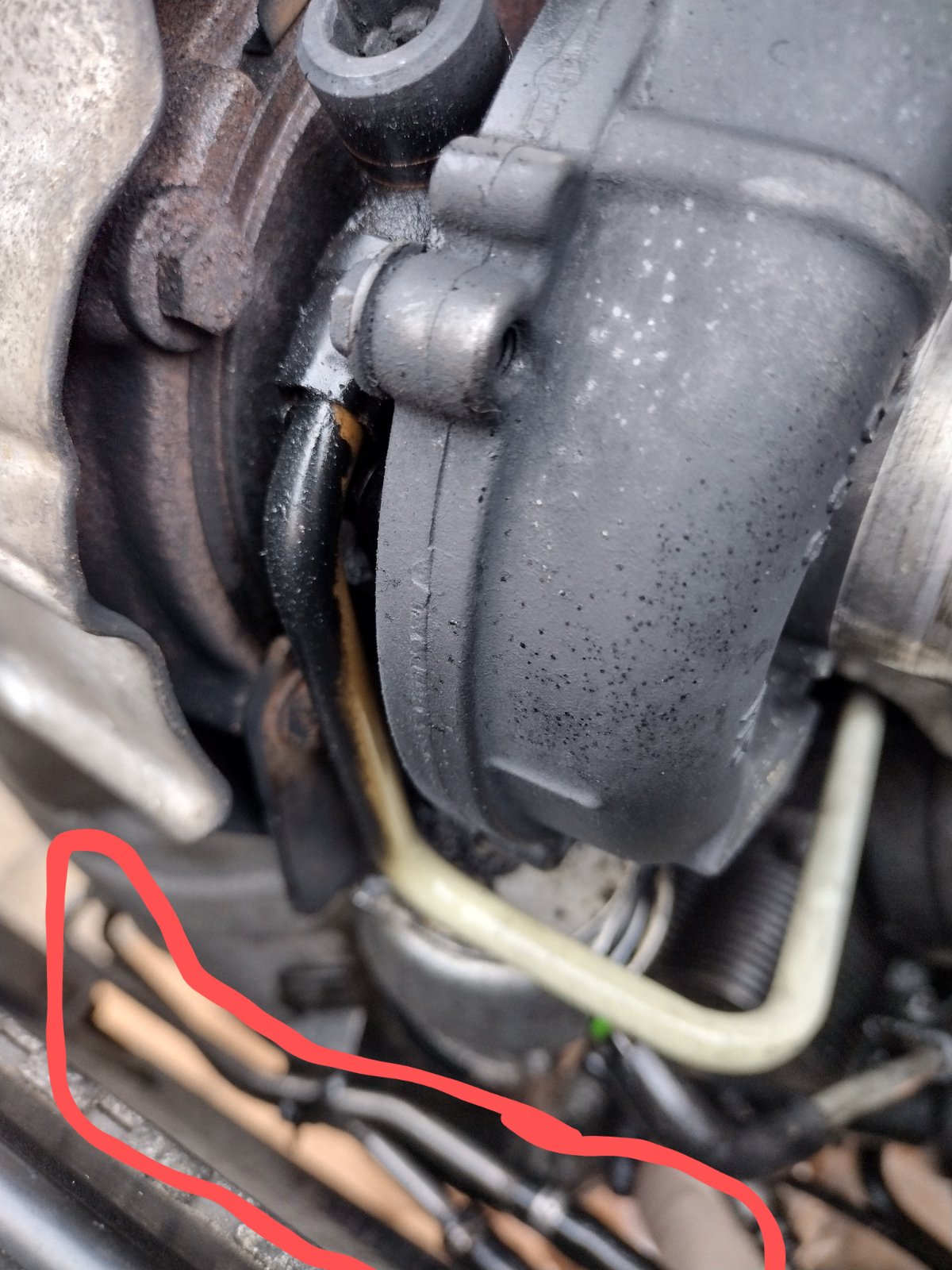

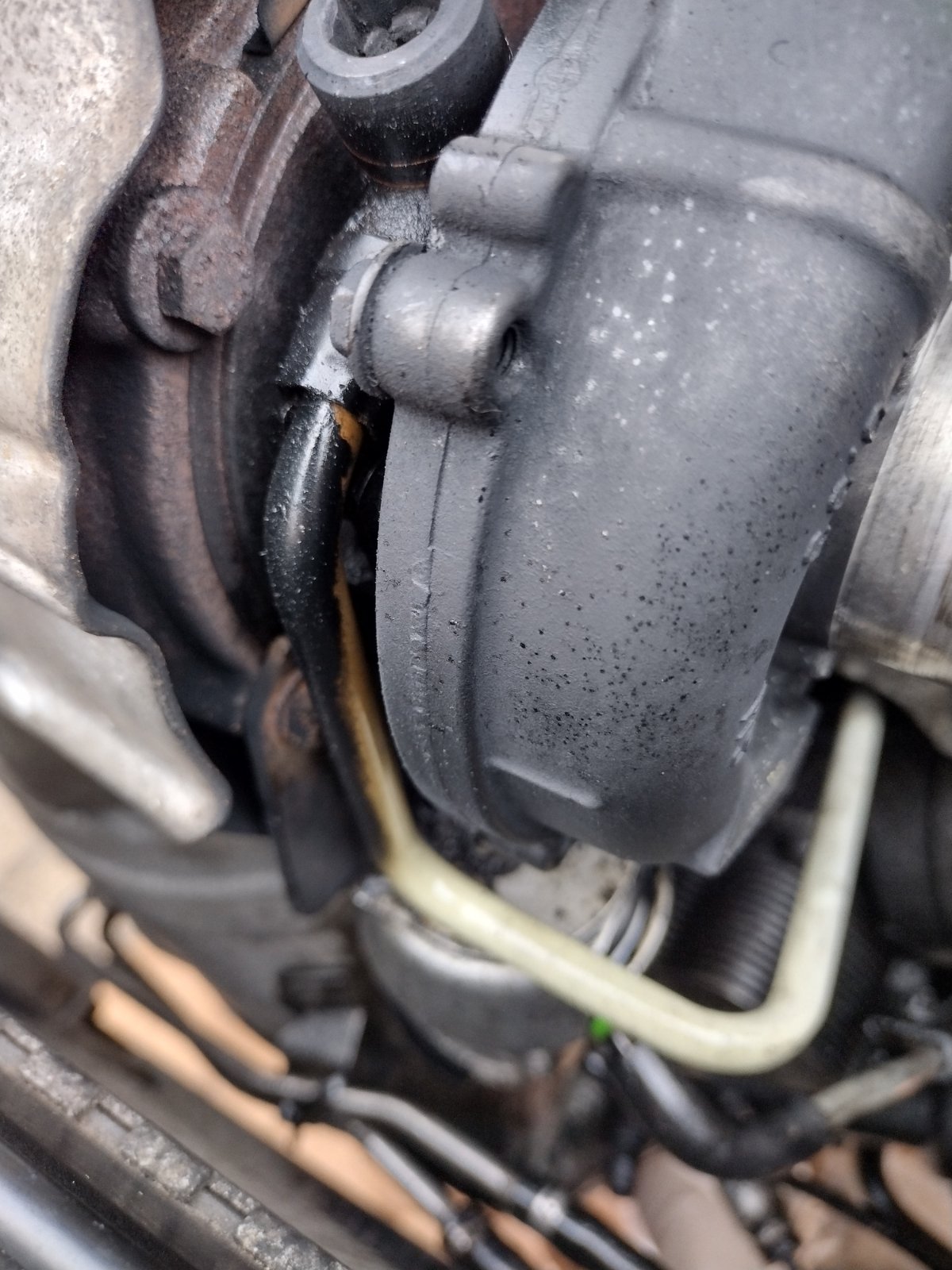

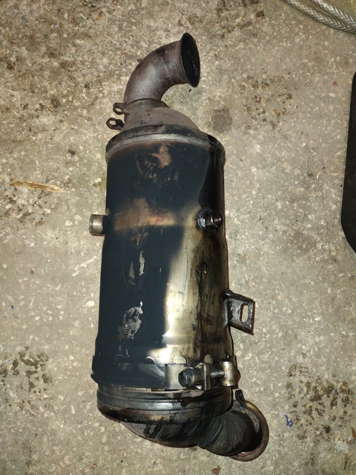

A couple of photos:
How sooty the 206 dpf was,
The two sensing pipes (unfortunately blurred) in the background - these only present if you have a DPF

Re: DV6TED4 turbo exhaust leak
Marked up image

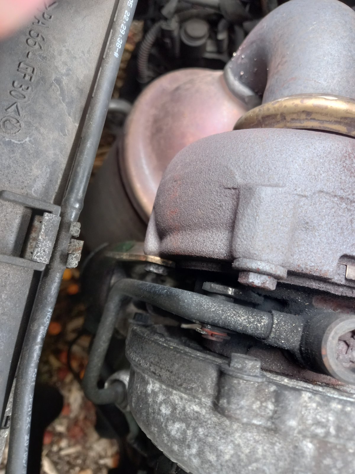

Thanks for uploading the pics Matt.
Here's my turbo.
Don't think I have the pipes so I guess its non-DPF? But not sure 100%.
Here's my turbo.
I don't think so from that picture, but could be hiding well - if your camera was maybe 25-50 towards the back of the car looking straight down the front is be sure.xsara92 wrote: 03 Aug 2025, 15:16 Don't think I have the pipes so I guess its non-DPF? But not sure 100%.
However another question that night give confirmation:
Have you removed the big heat shield (that covers turbo and all down that front section) ?
As if you have, then you would have to have unscrewed the DPF connection to get the heat shield out the way - I'm 99% sure the pipes reach through the heat shield itself
