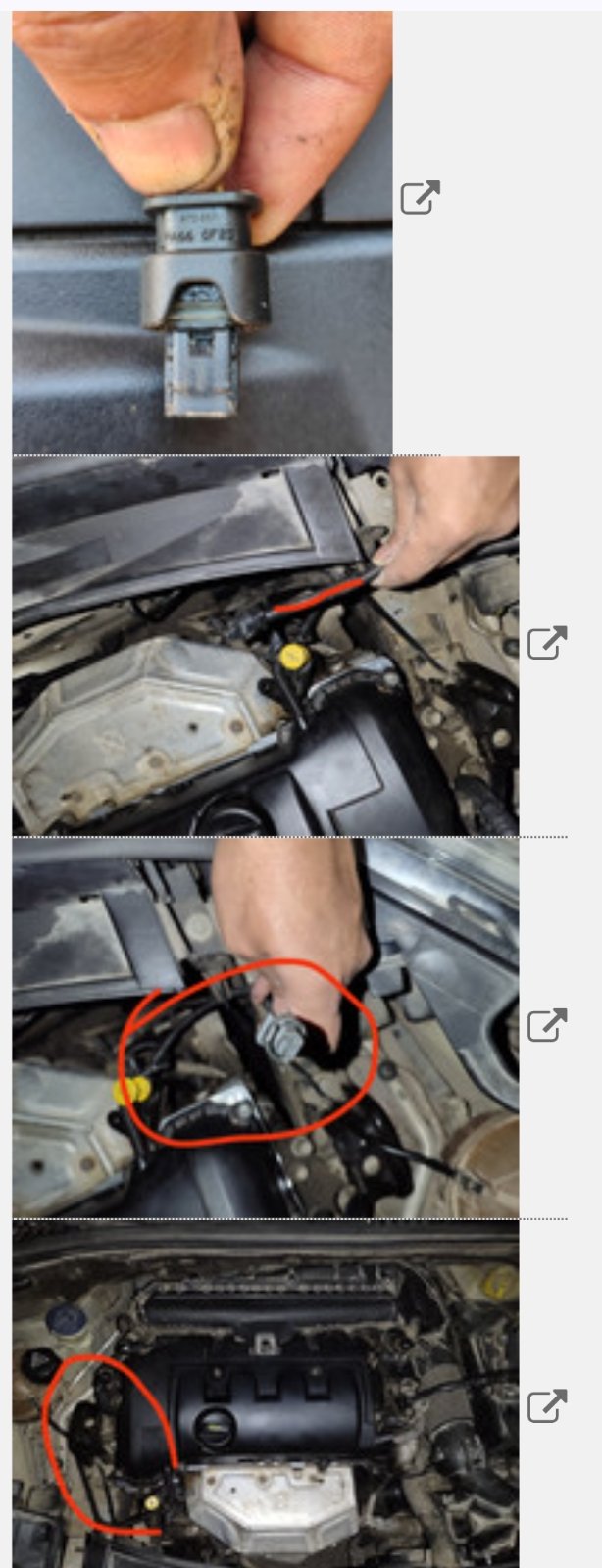

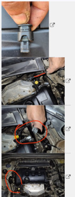

Hi
I can't find where this connector came loose from.
It's part of the wiring harness for the ignition coils.
The connector has two wires – red and white.
I think it should be near the accessory belt.
Any idea?
Thx
Citroen c3 2012, 1.6 petrol. 5fs

Pure guess work but I'd look for a temperature sensor in the block or a rail pressure sensor. Hopefully someone with better knowledge will be along soon :)

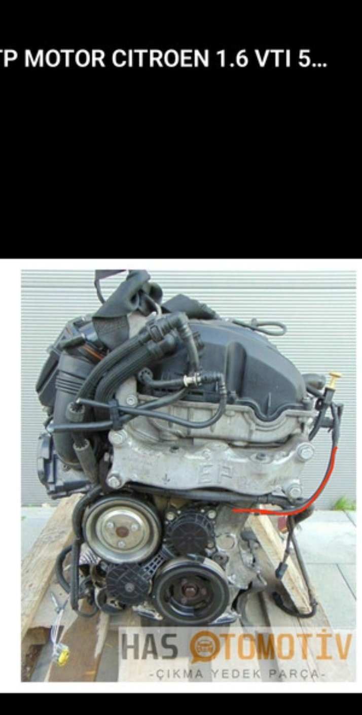

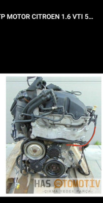

I found a picture online — it seems like this connector goes toward the tensioner, but I'm not sure
