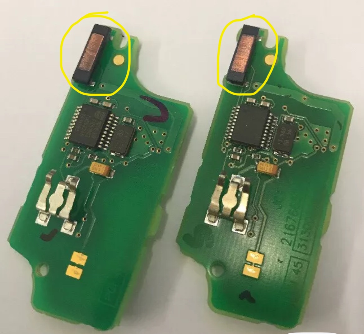

Re: All keys lost mode, cant re-link remote
Yes, but just to be clear the bit circled in yellow is not the chip, there is no info stored on this, its just basically an antenna. You would need to replace one of the multi leg chips (probably a PCF7941). I have never replaced the Citroen ones ( as its not worth the hassle & cheap universal remotes are far superior to the originals) but i have replaced the Fiat ones & the chips come with some form of coding on them, a blank chip may not work without some kind of pre coding on it first.shezza wrote: 24 Jul 2025, 08:32
