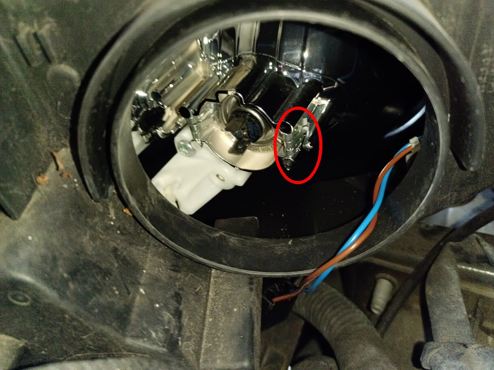

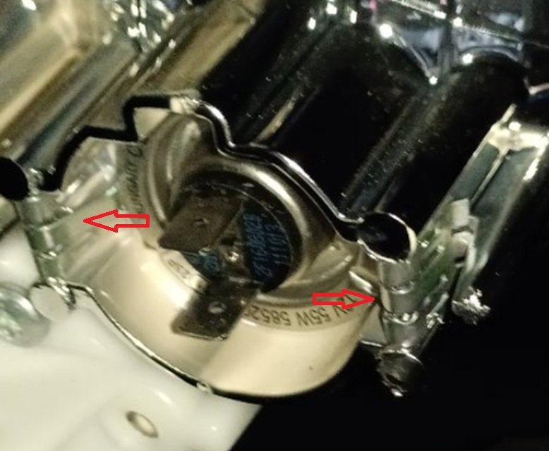

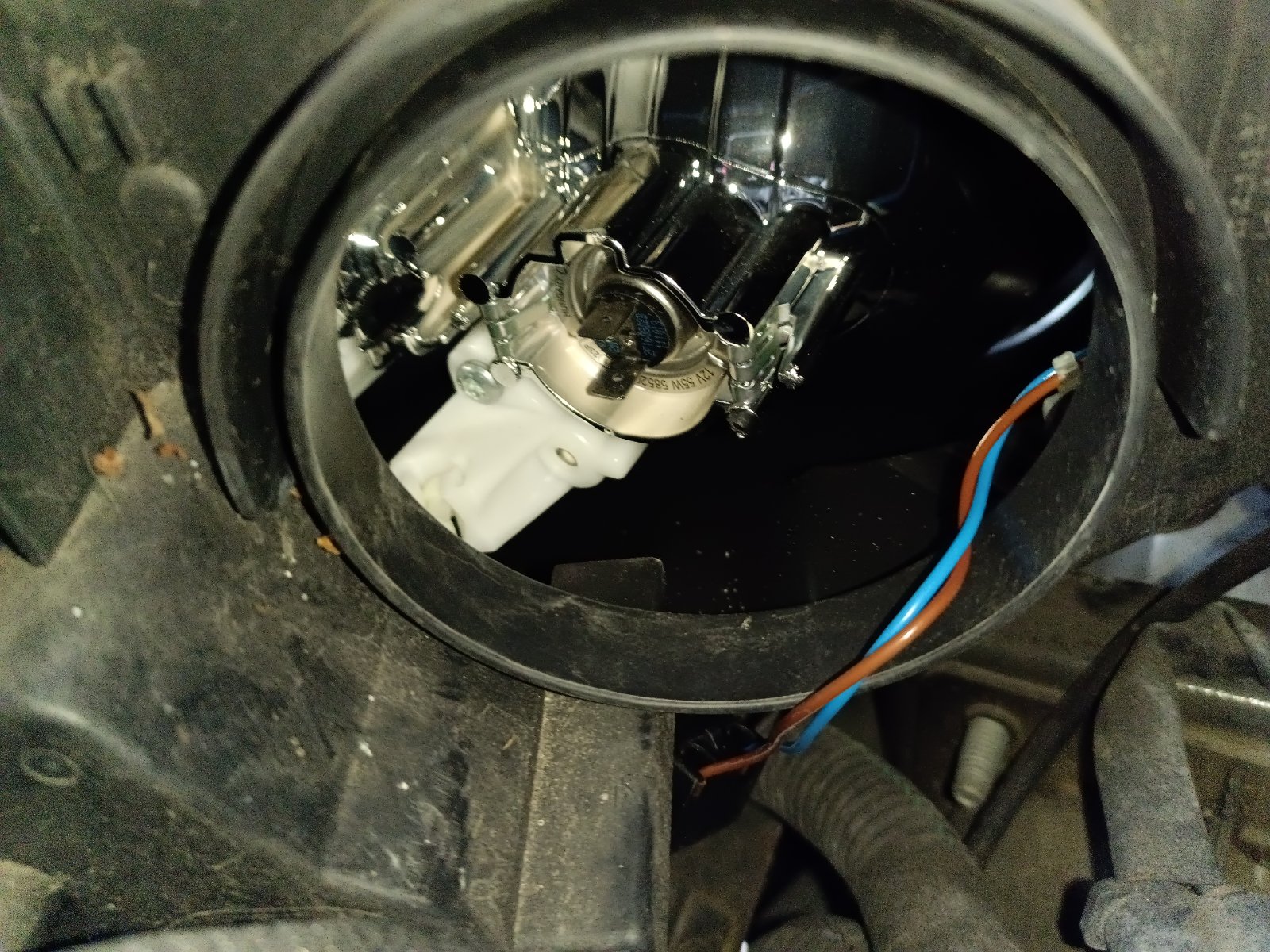

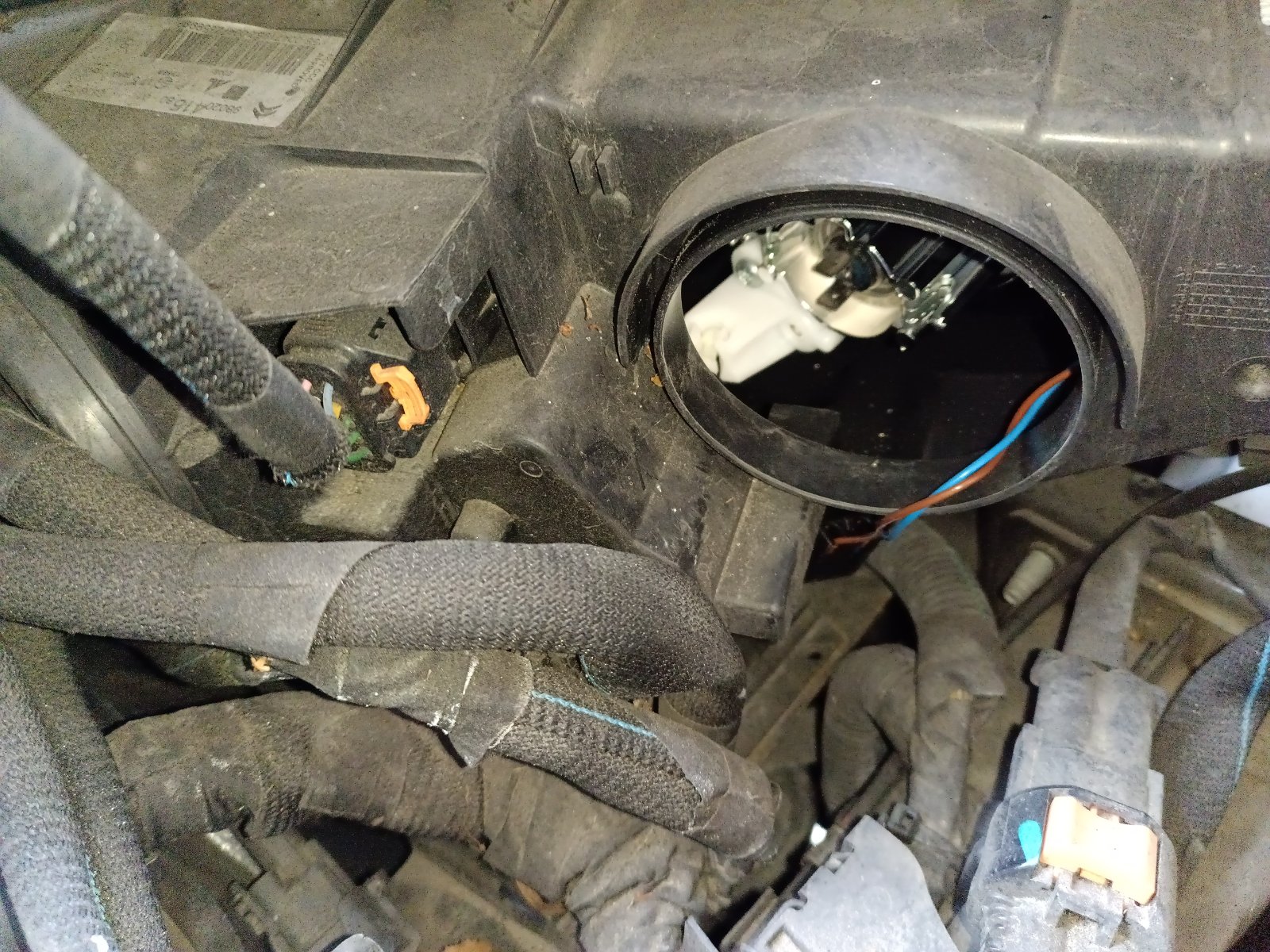

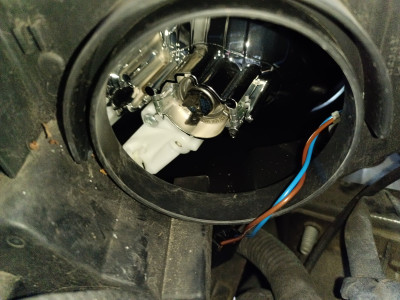

My car details are on my profile here it is a 2017 c4 Grand Picasso I have attached pictures of the dipped beam and the assembly structure and I can't work out how to remove this bulb
it's extremely difficult and tricky can't find any videos online that actually match the pictures attached please can you help send me a link give me some instructions anything thank you

Thank you for the videos I had looked at them before however none of them have the structure surrounding the light bulb and that I have
I looked in the manual I've looked online I've looked through multiple YouTube videos and I simply can't find a single one with that structure as shown in my pictures
Can't work out where the clips are they look like they're on the sides and recessed at the very bizarre assembly not intuitive at all

It looks like these are sort of spring clips that hold the lamp in (same on other side). Can they be prized out ?

Studying your picture I would say you need to hold the terminals with one hand, push in the clip as arrowed and ease that side of the bulb out. Then maybe swap hands and push the same clip on the other side to fully release the bulb. The new bulb will push in and the clips lock it in place I THINK
