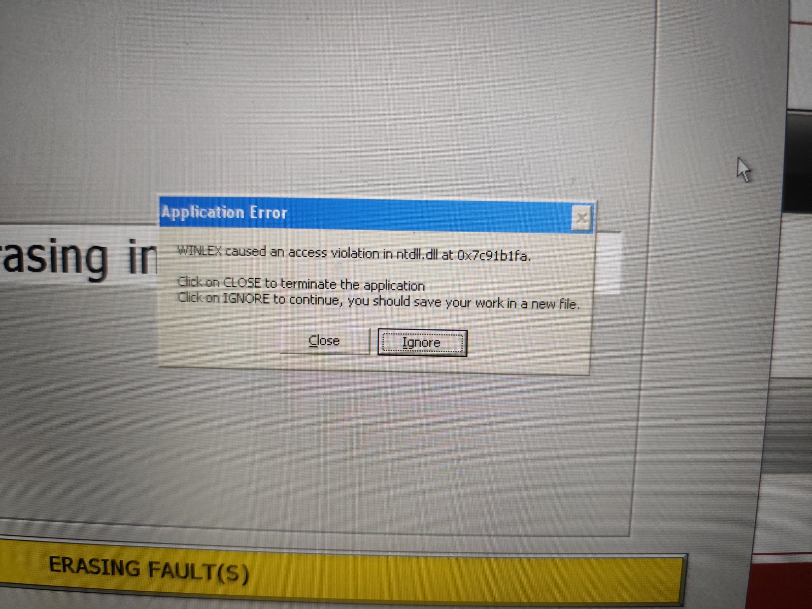

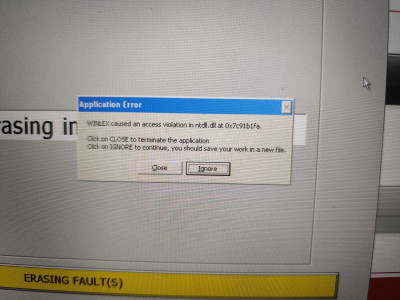

Unfortunately my Lexia keeps crashing. It's quite annoying since I wanted to try key pairing there to see if I get the fob working. I'm afraid to to try it now, if it crashes mid-pairing. It already crashed yesterday while reading the cd-player info, which resulted in me being unable to turn the cd-player off!
