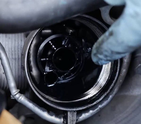

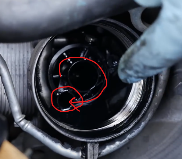

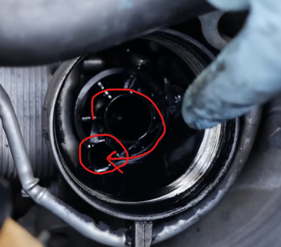

But is it actually necessary to line it up?
I think the inner part of the filter housing is designed to catch the nipple while it is rotating with the cap. If you try and see there is like half moon barrier where the hole is (attached picture.. I tried to find the best one i could). And while the nipple is spinning it stops the filter rotation and only the cap is spinning pushing the filter nipple inside the hole.
I think it would be a big engineering oversight by PSA if it wouldn't be the case, making it extremely easy to make a crucial mistake on a part that is regularly changed
Also, lets say, nipple didnt go into hole.. what are the signs of that? does it always show low pressure warning or not?

But what are your reasons for filter first? To line up the nipple?
but from the pictures i attached isn't made to catch the filter in the correct position while spinning. also probably less risk braking the nipple
