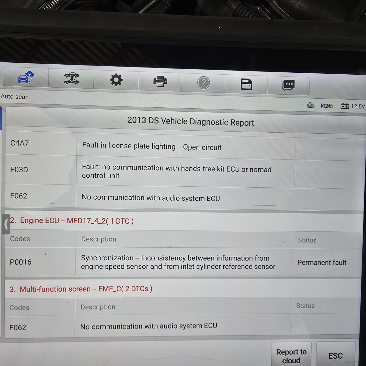

Sorry I seem to be writing a book #-o well I am now driving waiting to see if trips again and it did but now I am taking photos of the codes so this post might get me suggestions as I move forward.
Code P0016 no limp mode driving very well, see image:

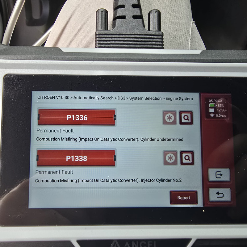

I have updates, the reader did read POO16 alongside P1336 and P1338, due to the airbags I have not been driving since my last posts, as today was not to hot I went out and changed the camshaft position sensor, my engine light had NOT been cleared after showing POO16 - P1336 - P1338 but when the engine was started the engine light went off and scanner showed no codes, after about 10 mins running the engine, I gave it some revs and the engine light tripped again, on reading the codes it only showed one of the 3 which was P1006.
I reset code and and turned it on again and decided to make a engine running video again and a exhaust with revs video, was quite a lot of smoke which went away after some time, no engine light, I maybe had it running 3 hours as I was doing live tests, some of which I will post here later and also and cam shot of the alternator belt as some has suggested that they can hear it is loose from the video I made above.
More info to follow when I sort the files out.
Anyone have any ideas regarding all this so far?
