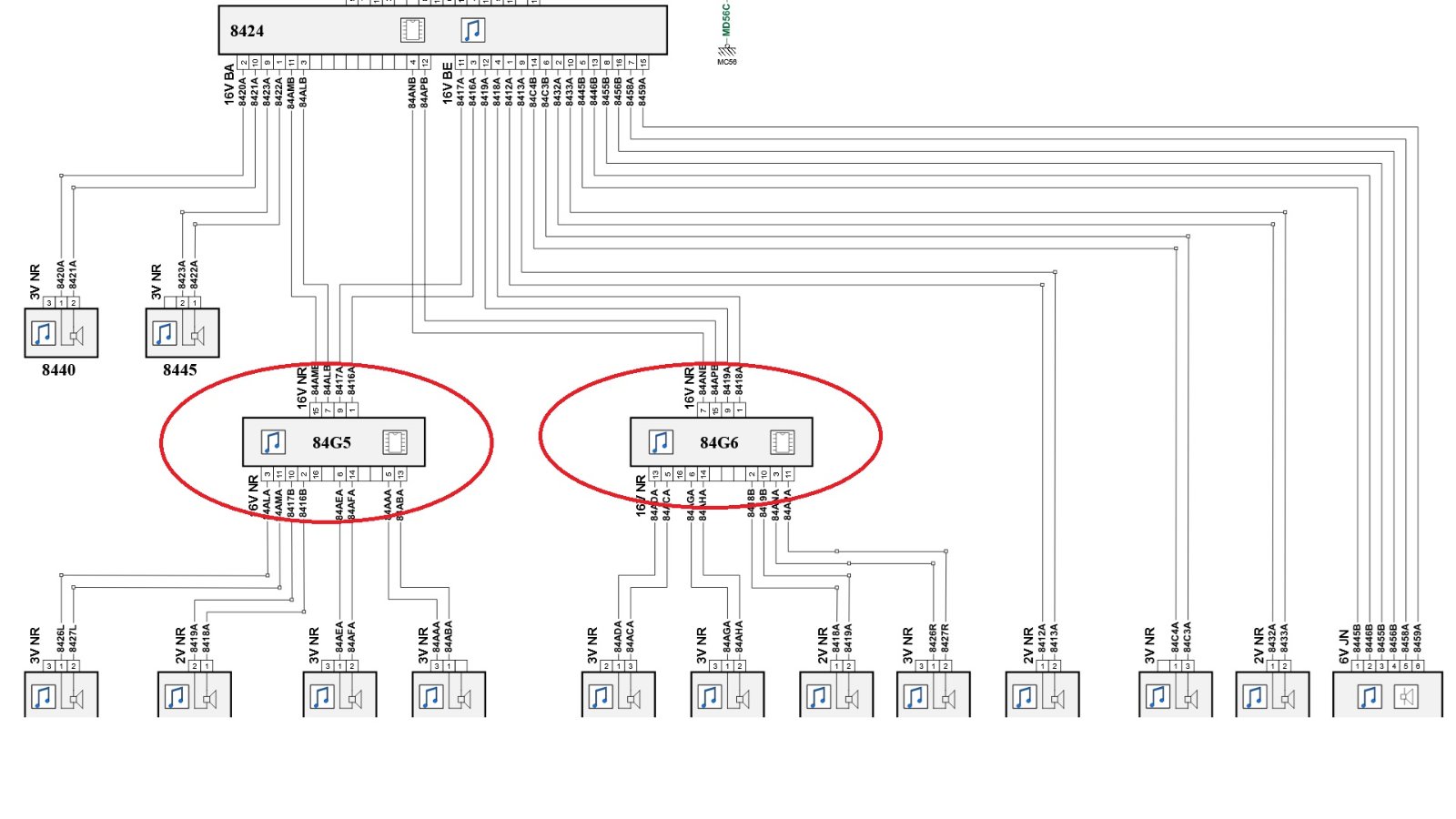

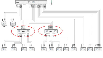

Update:
I managed to access the servicebox schematics from my reactivated account :)
I have a question: what is the part number of these filters for the rear door speakers and surroud - number on the schematic 84G5 and 84G6.
OK, I've got it: 9820441580.
