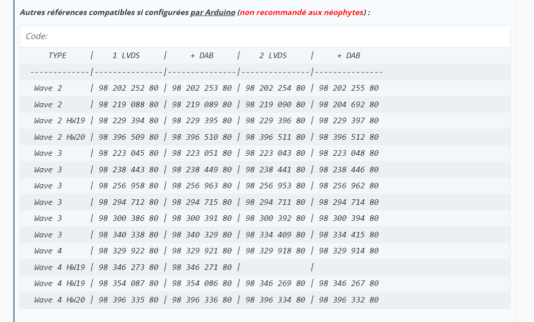

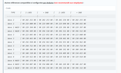

Can you Plz Someone Explain the differences between the NAC Wave2: 9821908880 (analog); 9821908980 (DAB+) compared to the one i have order (9820469280) (except the dual lvds)
MacSlavko
Posts: 132
Joined: 17 Aug 2017, 23:39
x 32
Re: RT6 to NAC (Connected NAV) Upgrade
Unread post by MacSlavko »
Seems you already know what you’ve asked for:
9821908880 is basic, analog NAC Wave2
9821908980 is the same but with DAB+
9820469280 is the best option; DAB+ and dual LVDS. Possibly with a little more RAM due to handling two screens (touchscreen and Cirocco)…
