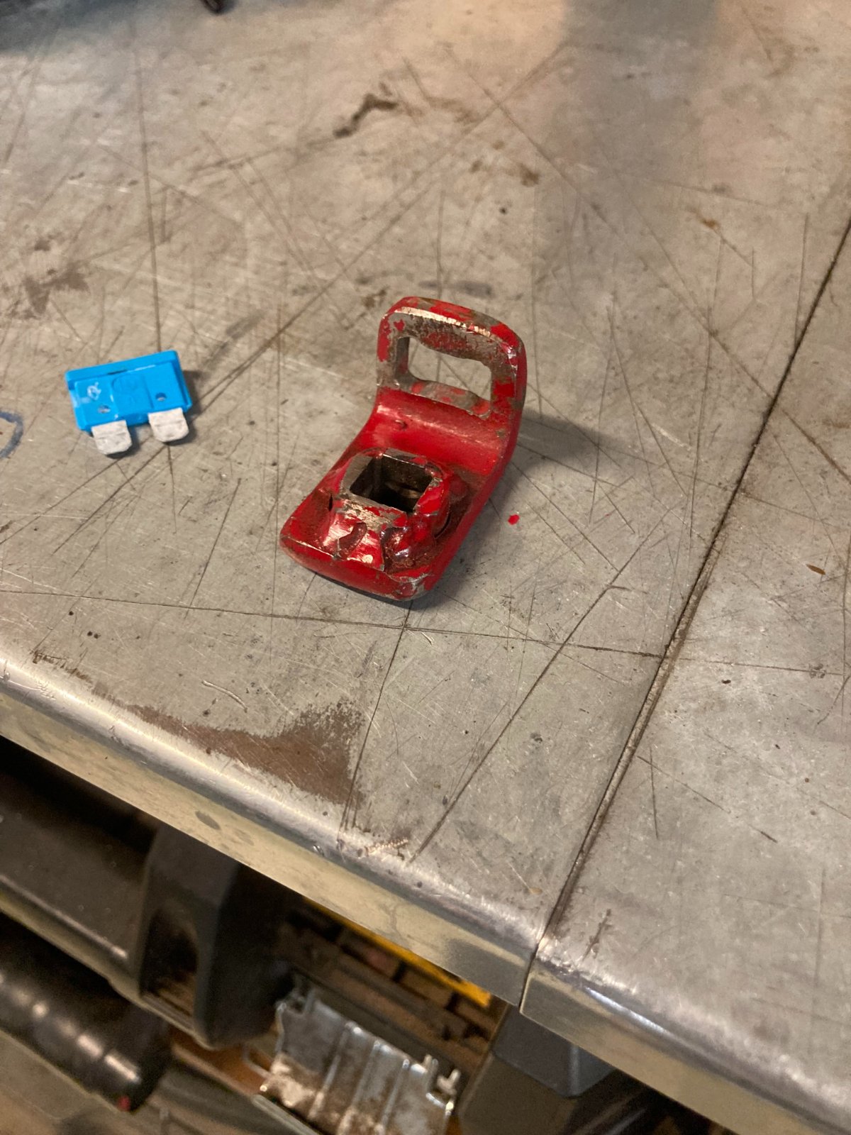

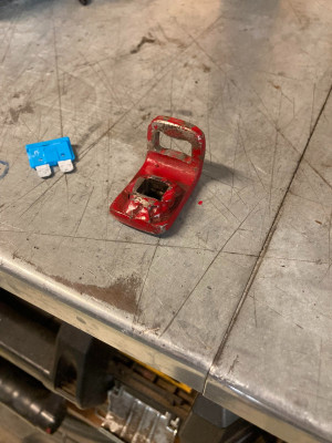

I made this years ago, works on most of them. When you have the tension off there is a hole for a locking pin, about 4mm dia
