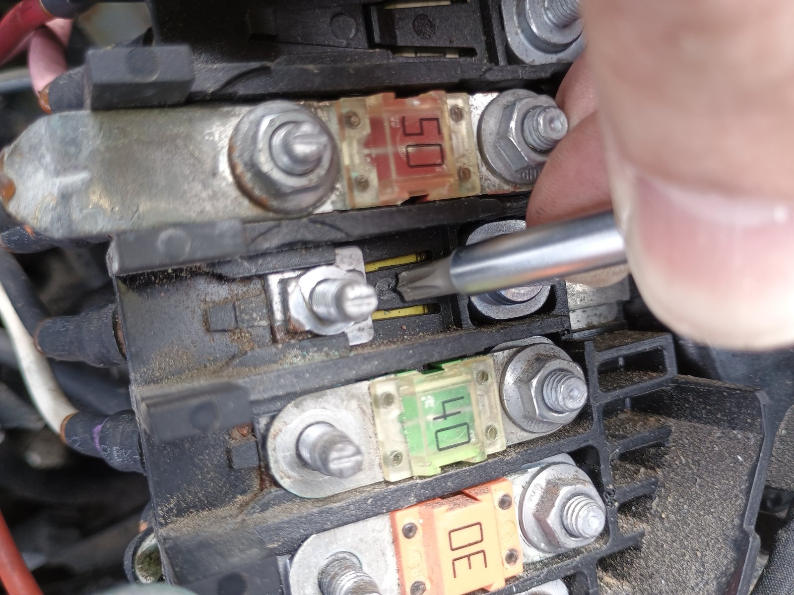

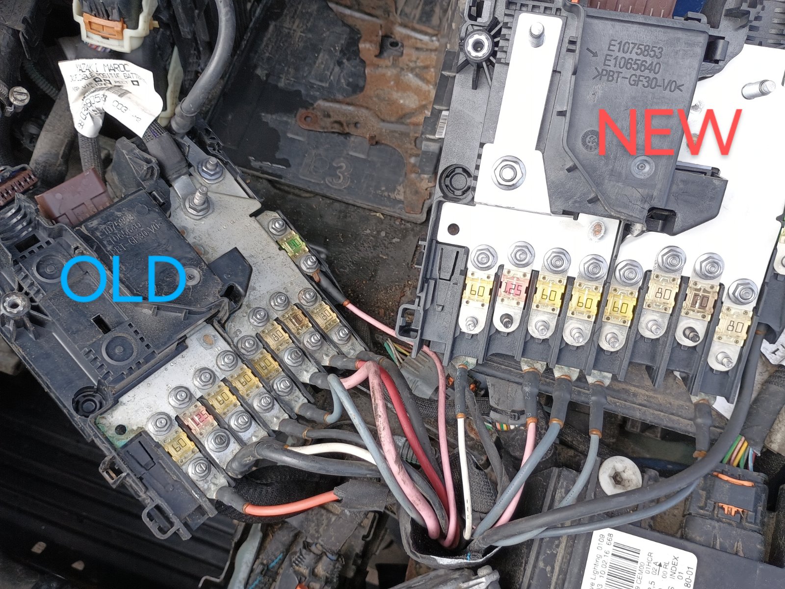

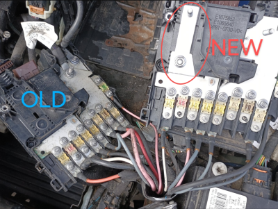

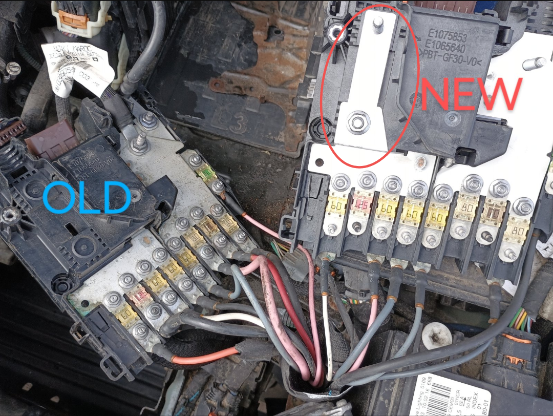

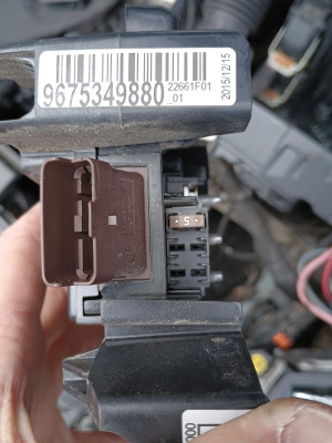

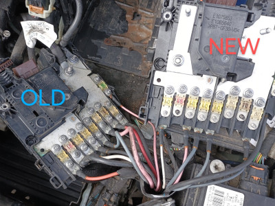

A few differences between the BPGA units as pictured above.
Terminals can be unclipped fairly easily: So all made to match the old one fairly easily.
The extra high current connection I'm surprised I'd not spotted until now!

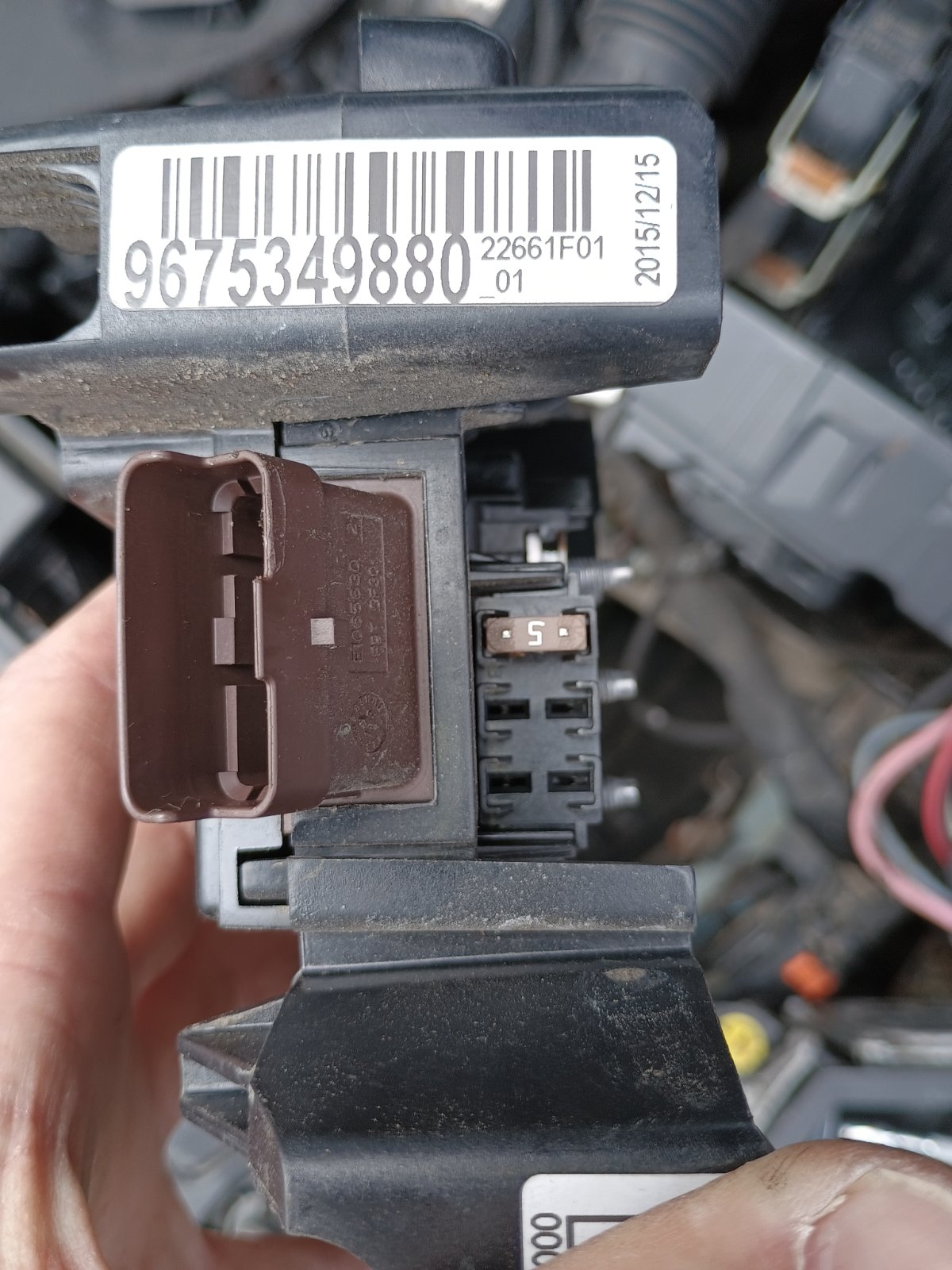

Also nearly missed this fairly hidden 5 amp micro fuse:

MattBLancs wrote: 15 Jun 2025, 12:36 The extra high current connection I'm surprised I'd not spotted until now
- Posts: 20974
- x 8068
So is that high voltage connection entirely missing from the old one Matt, or had it got wrecked etc?

Nope, missing and looking very much like it's never been present - though plastic moulding suits provision of it. I guess between the different part numbers there's changes like that over the basic design.mickthemaverick wrote: 15 Jun 2025, 15:04 So is that high voltage connection entirely missing from the old one Matt, or had it got wrecked etc?

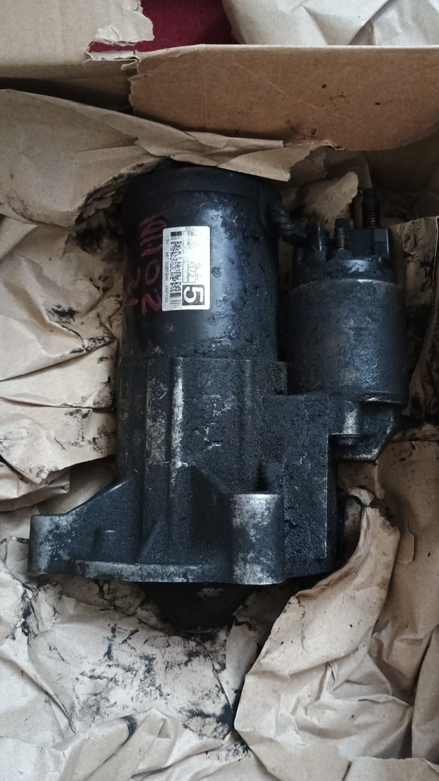

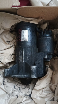

This arrived whilst I was away

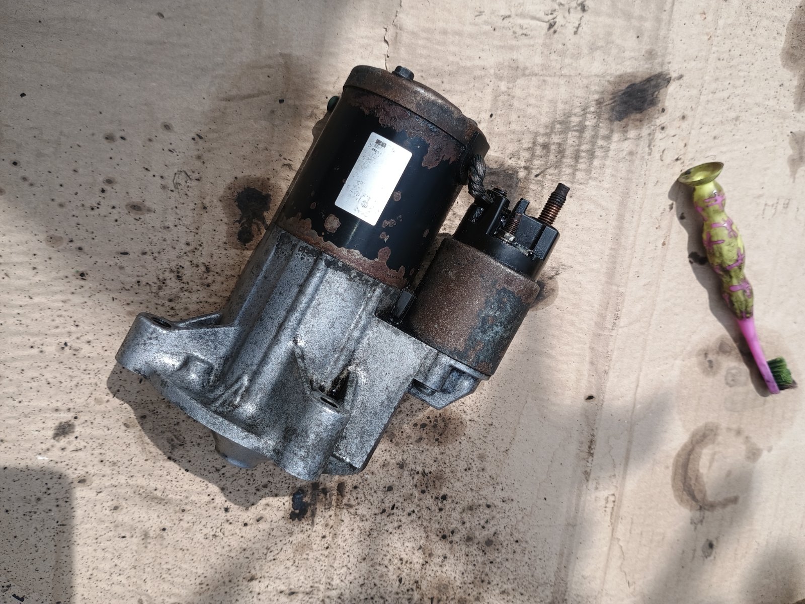

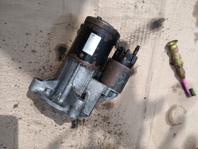

Via jump leads and a short piece of mains cable, "new" motor tested: all fine.
So given a scrub with an old toothbrush and some diesel. Said diesel from a jam jar - drained from fuel filter housing (and buried the junk in the garage) so long ago I can't recall which car it was from!
Looking better:
Looking better:
- x 2941
toothbrush returned to the bathroom?

Oh no, my boys need much encouragement for teeth brushing as it is, strong overtones of grime and diesel definitely wouldn't help there
