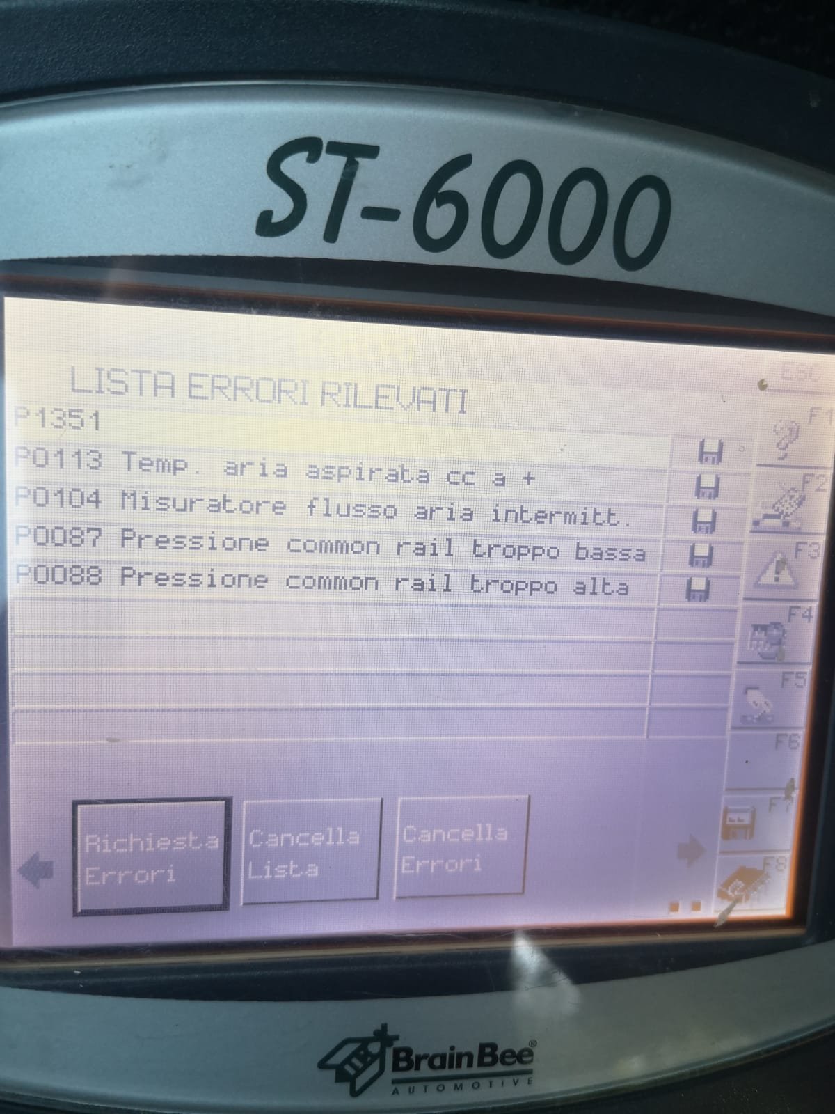

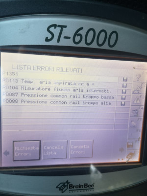

I don't have Lexia but the day after I got hold of a oldish diag tool and got these codes:
P0113 Intake air temperature too high
P0104 Intermittent MAF sensor signal
P0087 Common rail pressure too low
P0088 Common rail pressure too high

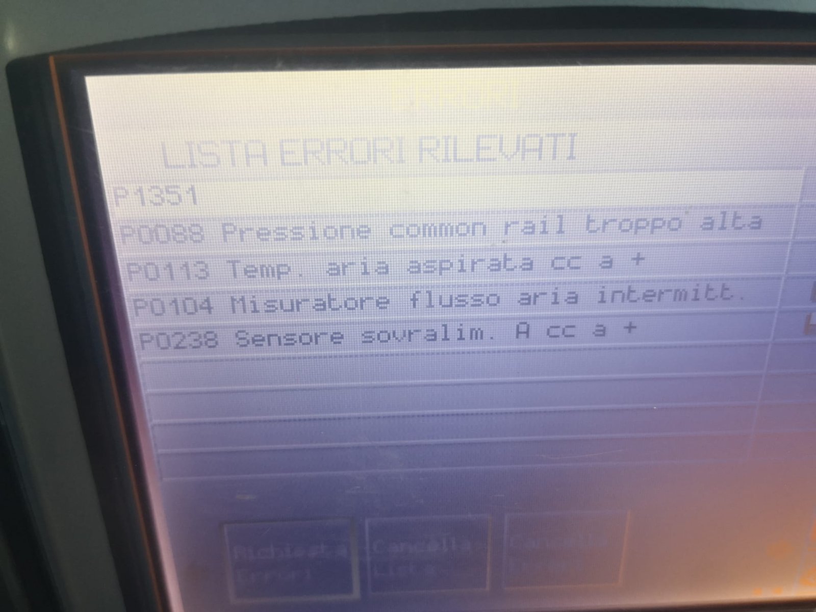

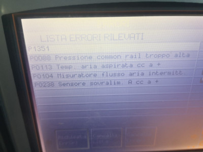

As first action I put back the old MAF sensor which was working fine, then cleaned the air temp sensor with carb cleaner, cleared all errors and tried to restart. Lo and behold it fired up instantly. After about three minutes idling I gave it some revs and it died again. So much for having solved the Problem. This time the codes were the following:
P0238 Turbocharger Boost Sensor A Circuit High
After that it would not start anymore.
