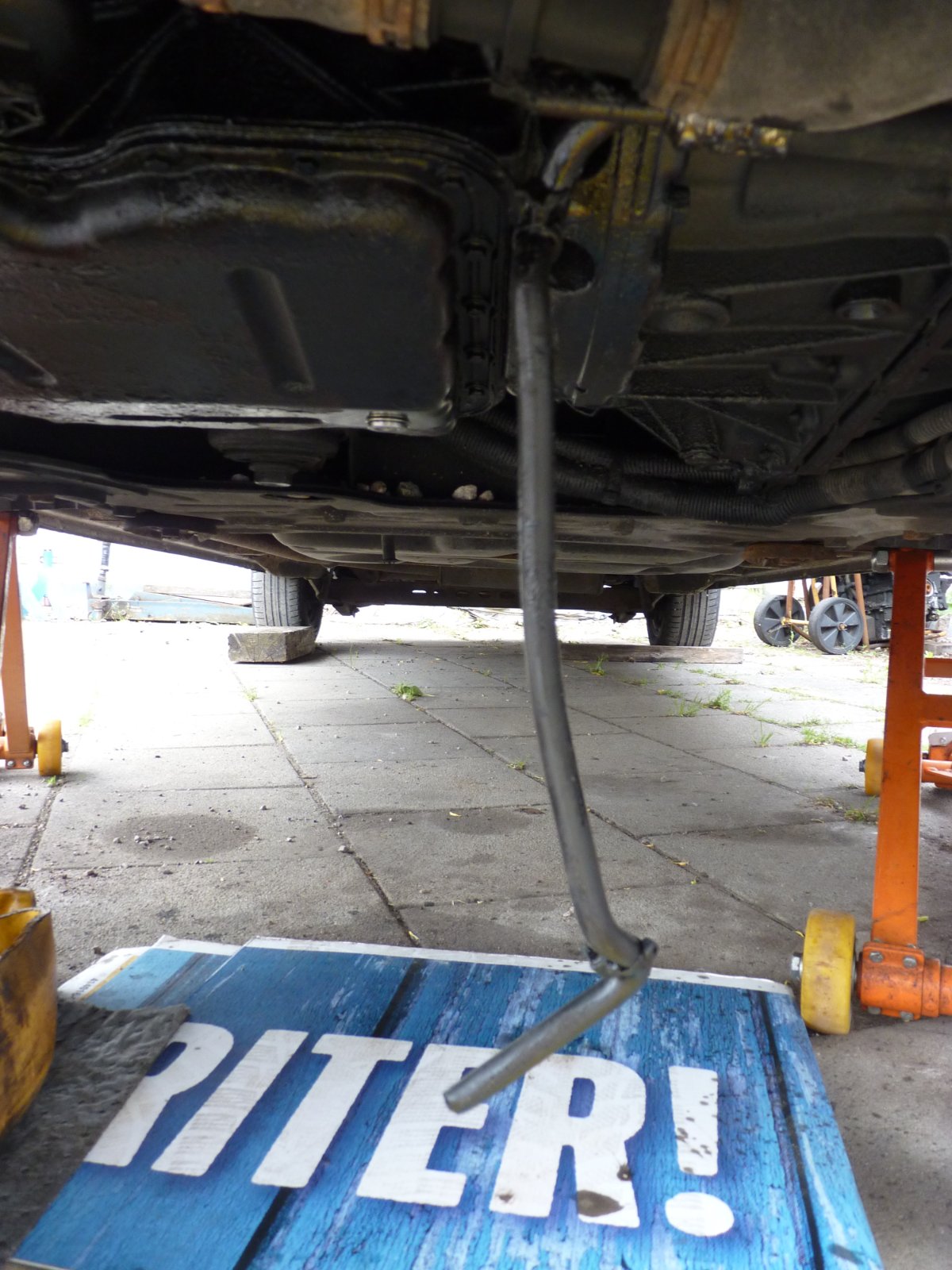

Van needs lot of work. When i went under, I saw the engine tray broke and this hose hanging out. And cannot find for the world of me - where its supposed to be attached to. And French manufacturers arnt very helpfull with their drawings.
Pictures of the hose.
The engine is soooo oily and everything is so black that I cannot see anything. Its also possible that the hose or pipe, its supposed to be attached to, is missing. It looks like he has driven or more likely reversed into something, the engine undercover was hanging down in the rear as well.

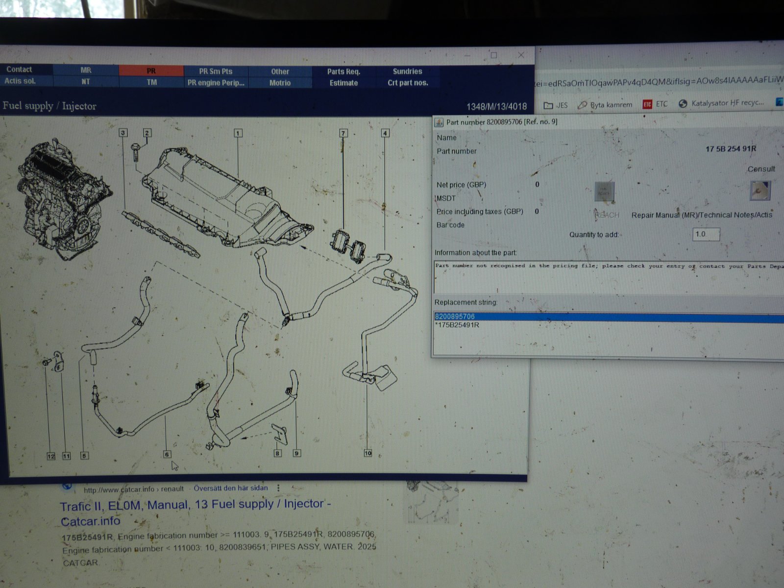

I THINK the hose in question is the one with number 9 - perhaps could be number 6.
Where do the attach to, on the rear???

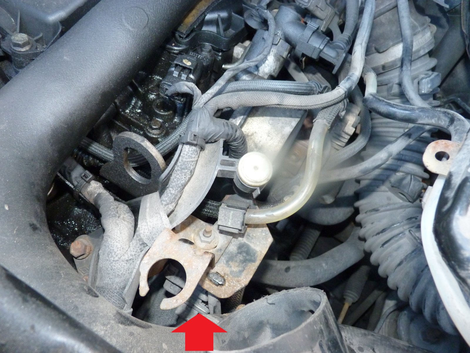

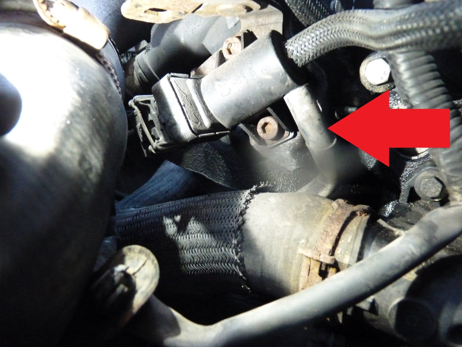

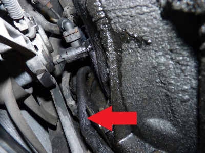

Here is where the other end goes. Not easy to get on camera, but you get an idea. First pic, where its located, just under the gearbox breathing tube. Second pic pointing on which hose is the one in question:

Found a Youtube video with oil change on same engine - its just a breathing hose and doesnt go anywhere =)
