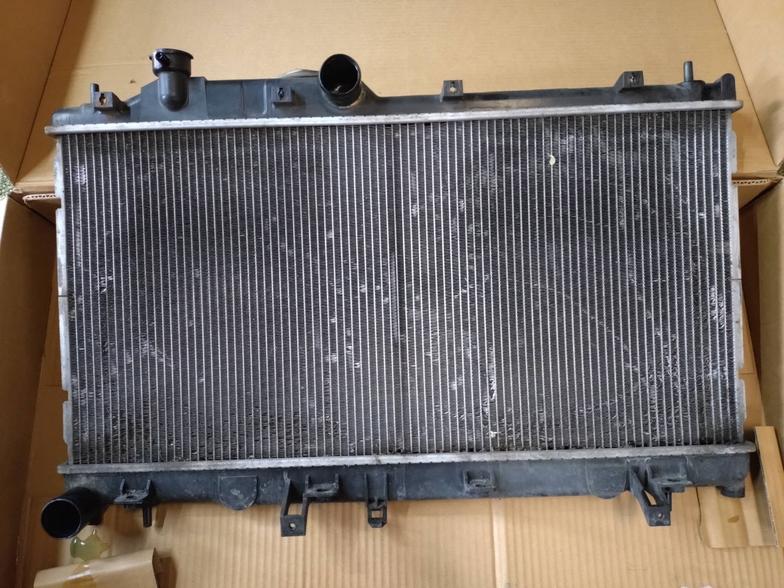

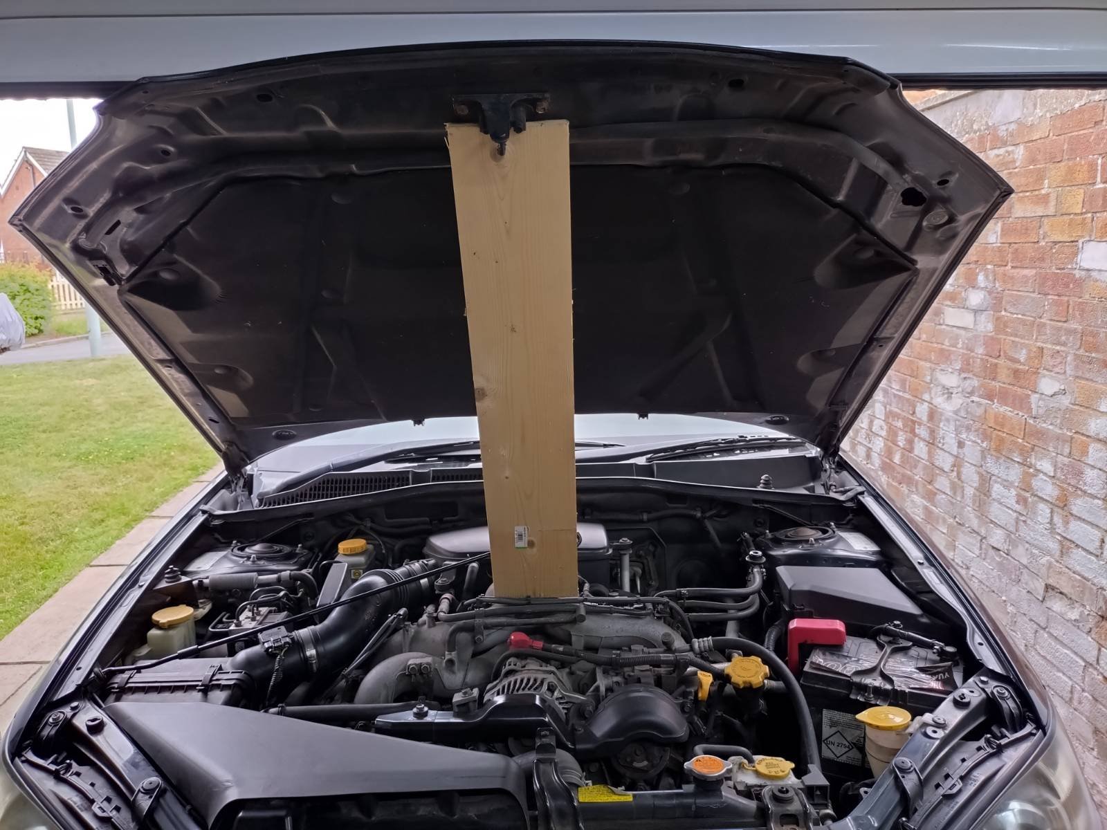

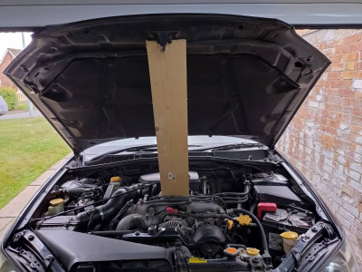

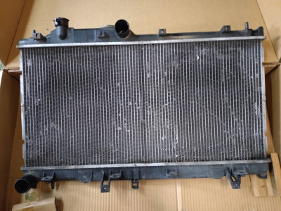

This morning dawned bright and cheery so I decided to do the cooling system and power steering hose on the Subaru. I started with the best of intentions to use the camera but I'm afraid after the first few my fingers were too yucky to use it so only limited pics I'm afraid.
Having put the car on the ramps making it fairly level with the back up my sloping drive the first problem hit me straight away!! I had positioned the ramps further out than I normally do and as a result, once mounted, there was not enough clearance to open the bonnet as normal and use its stay so a bit of improvisation came into play:

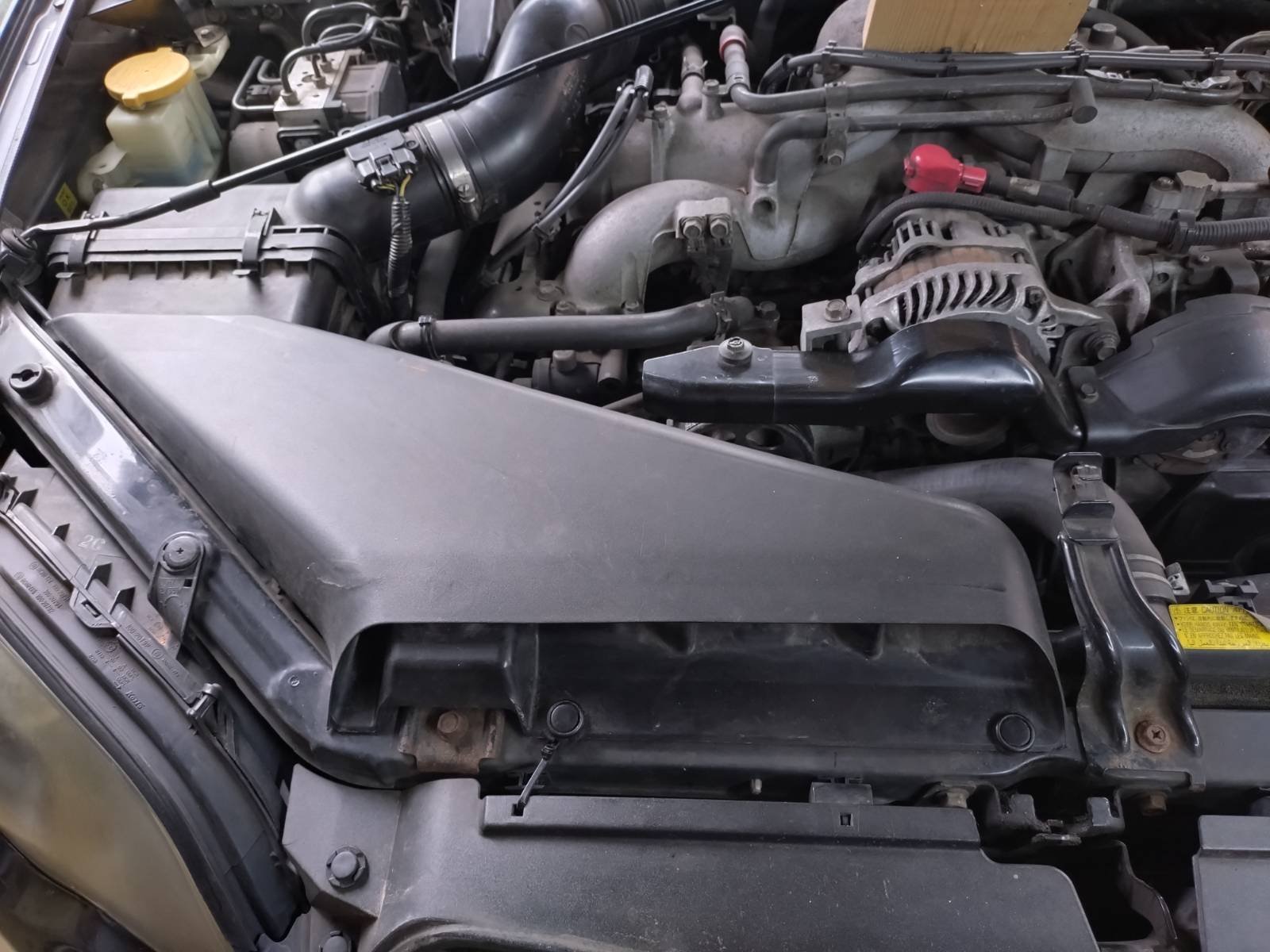

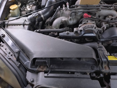

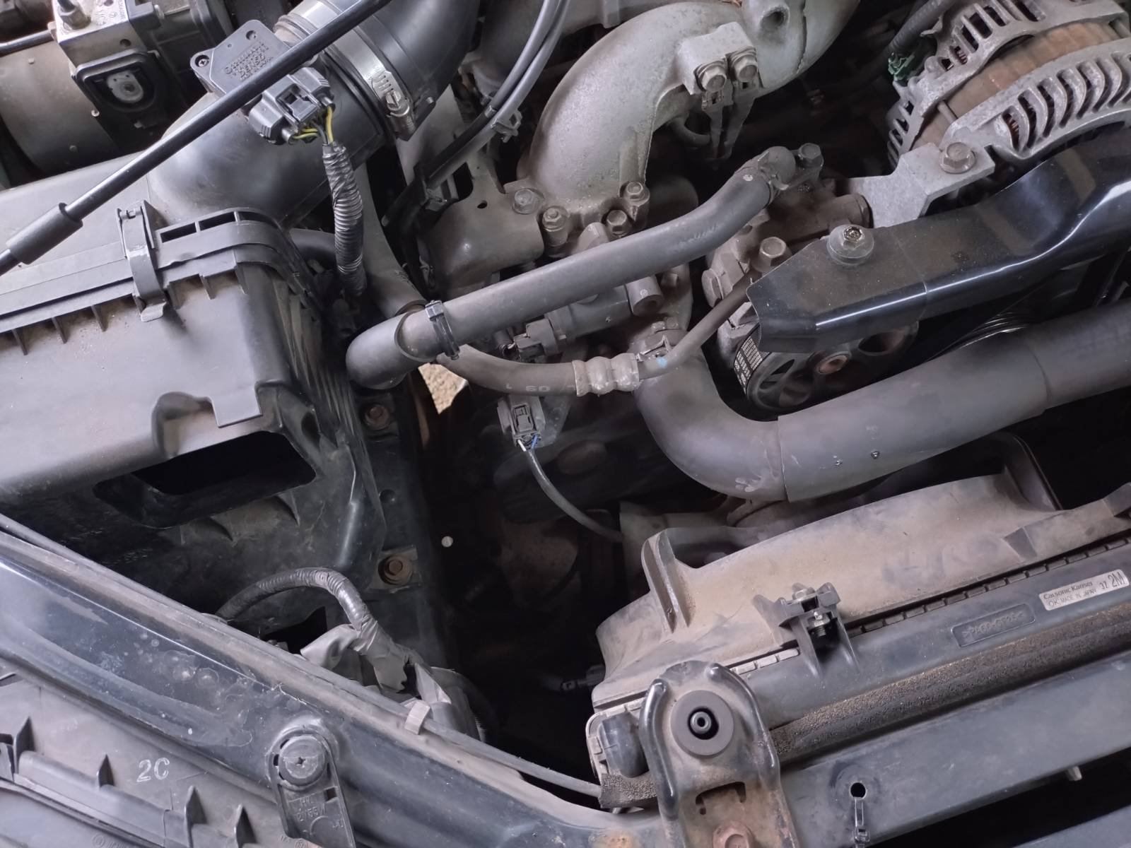

Once secure the first job was to remove the air intake chute:

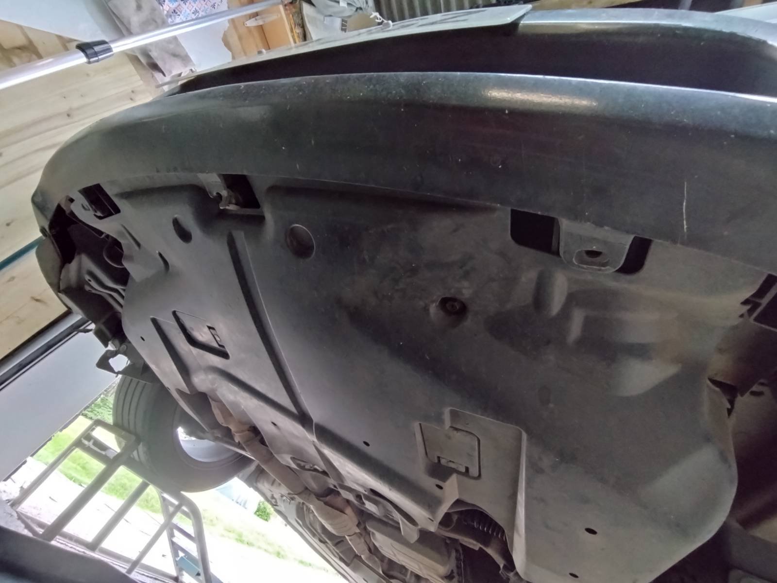

Then under the car to remove the under shield:

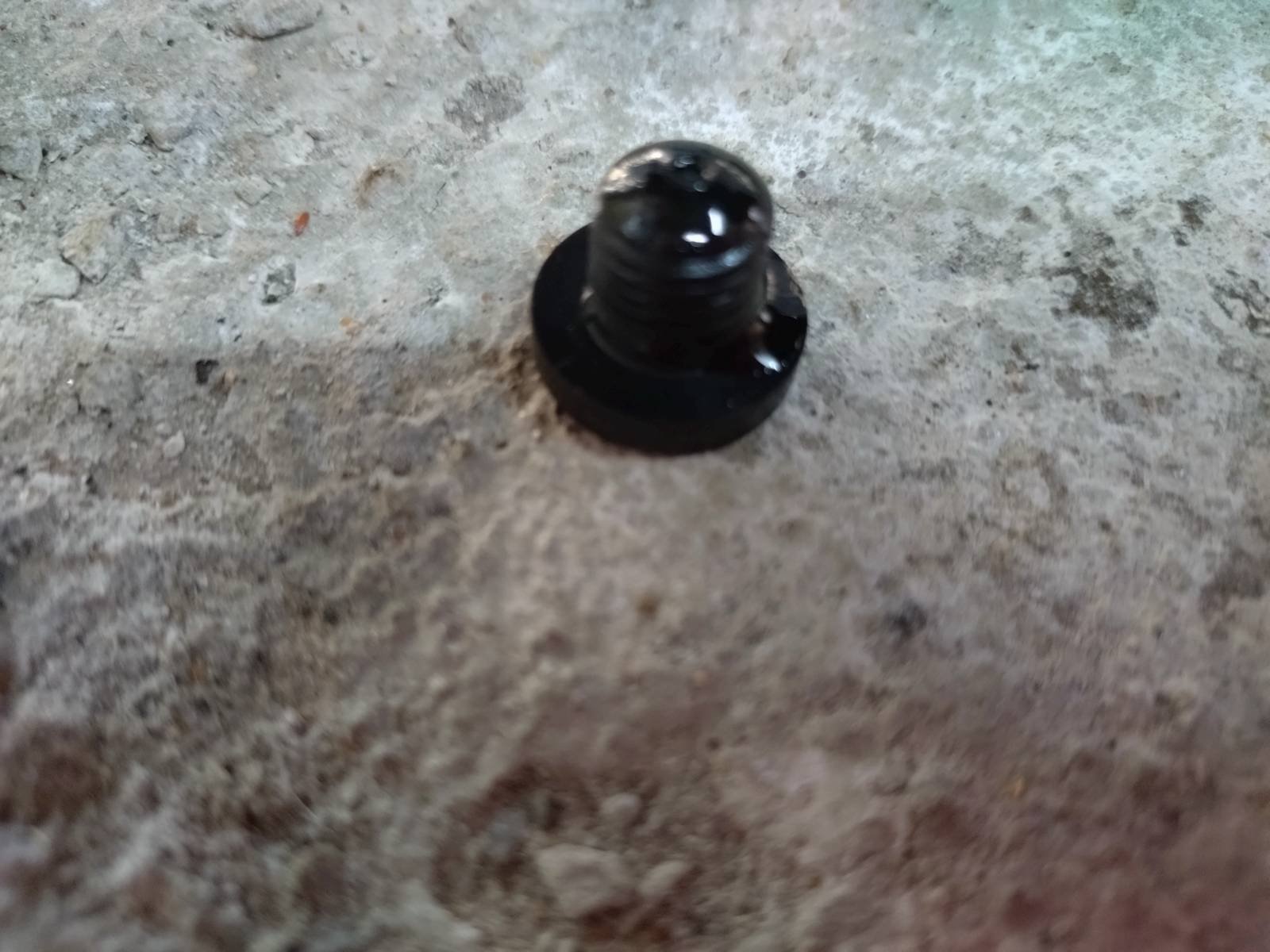

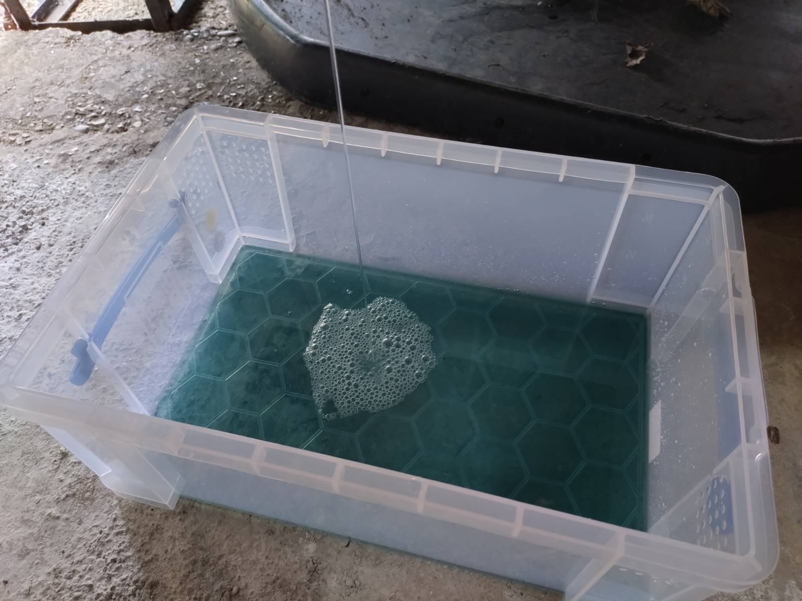

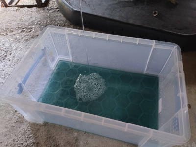

Next job was to drain the coolant, made very easy and clean by the inclusion of the radiator drain plug. Once removed a very steady and straight flow into the box ready for reuse if ok. As you can see it is indeed very clean still since the replacement during the timing belt job at 120000 miles. I am very pleased with that and it confirms why I didn't want to use a sealant to cure the radiator weep.

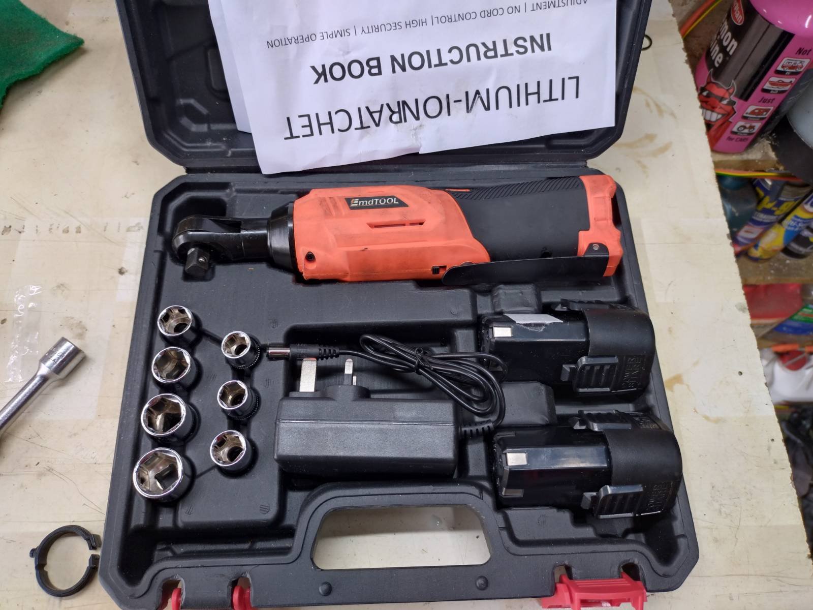

At this point I decided it was time to give my new battery ratchet a good workout and use it for the rest of the job:
I have to say it performed brilliantly especially on the new hose clips which I had bought oversize so they needed a good winding down to size. A simple task with the battery tool.

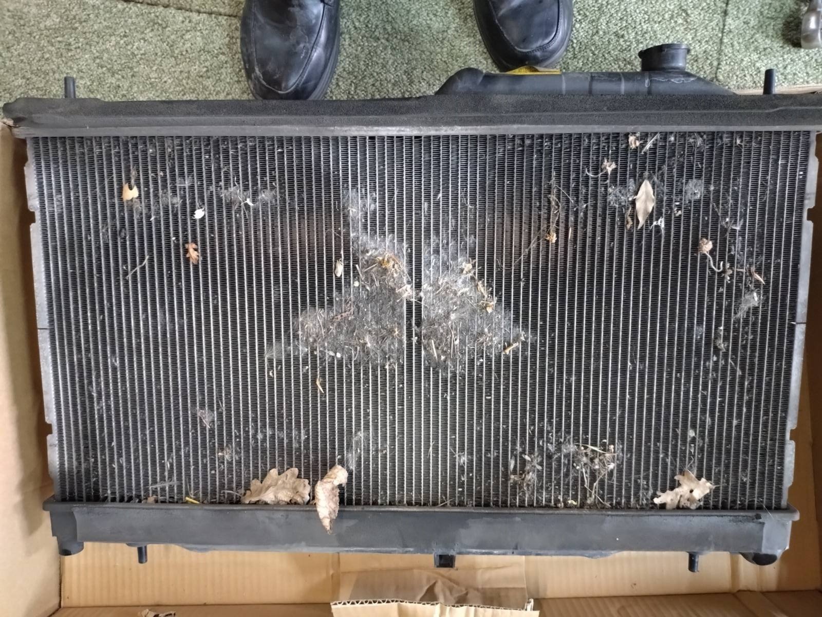

Next job was to remove the top and bottom hoses, no pictures but not really necessary. That done I unplugged the two fans and removed the radiator braces from the top of the radiator and lifted out the radiator and fan assembly complete.

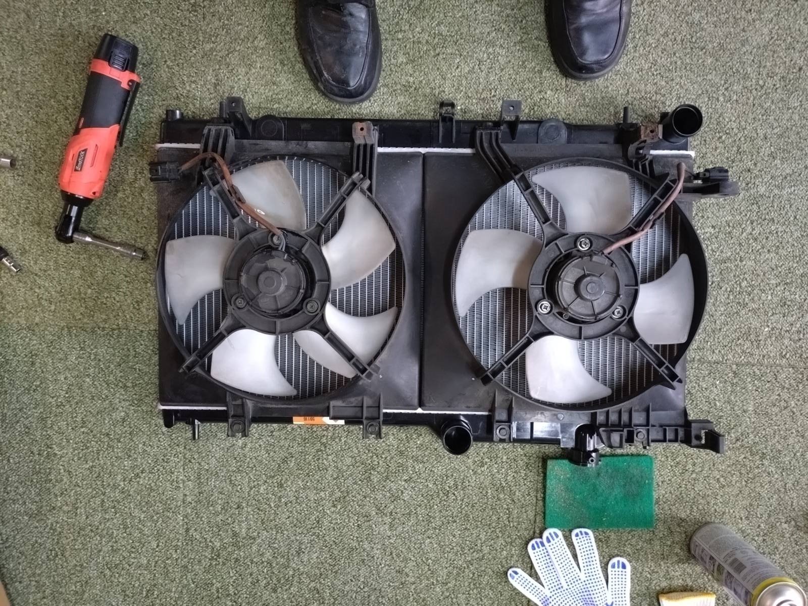

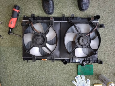

It was then a simple job to swap the two fans from old to new:

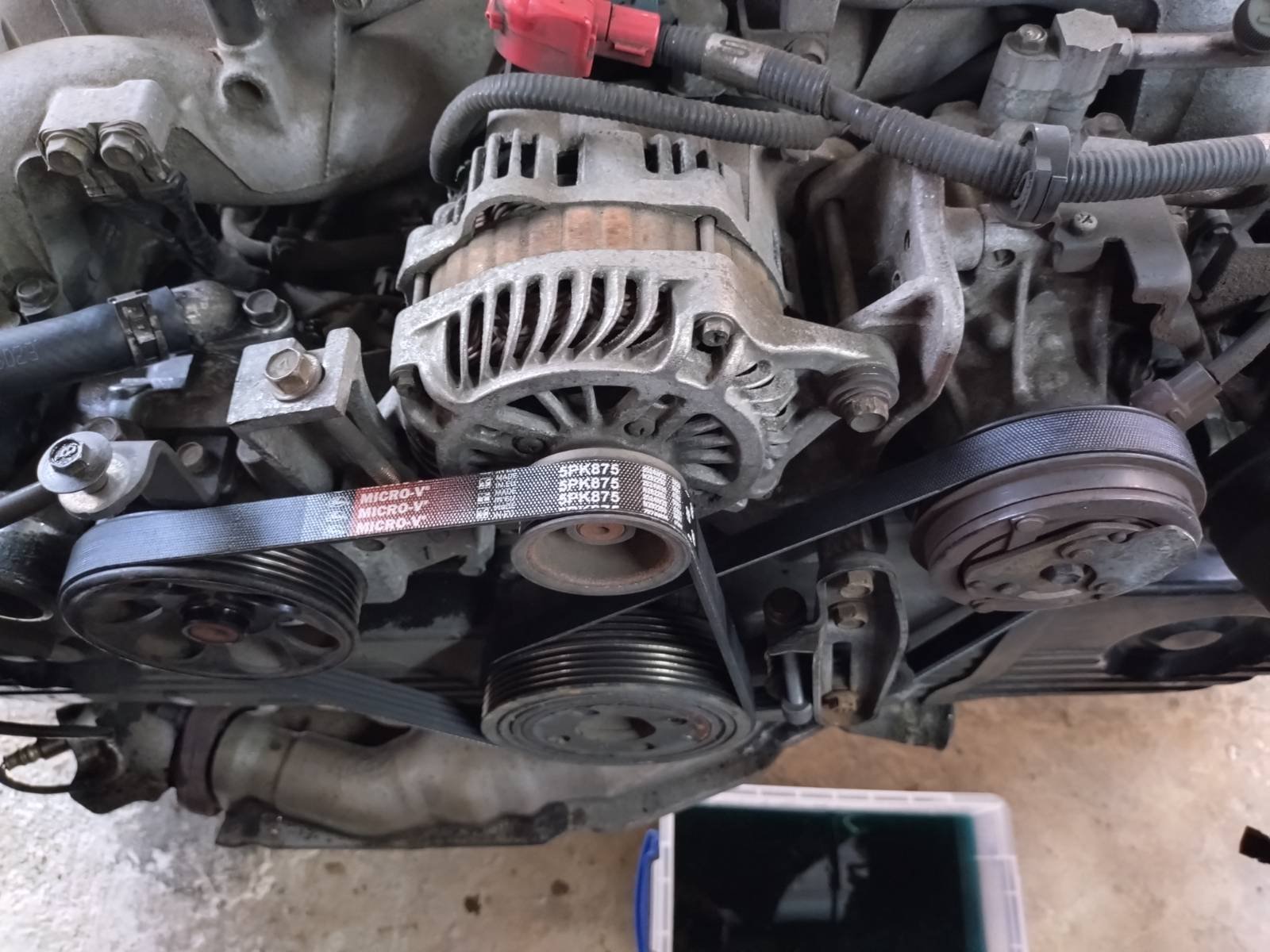

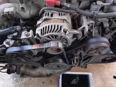

Turning my attention to the engine again I released the bolt adjusters fitted to both auxiliary belts and removed the old belts which are in fact still in good condition so have gone into the emergency stock box. I then fitted both new belts and adjusted them back to the correct tensions.

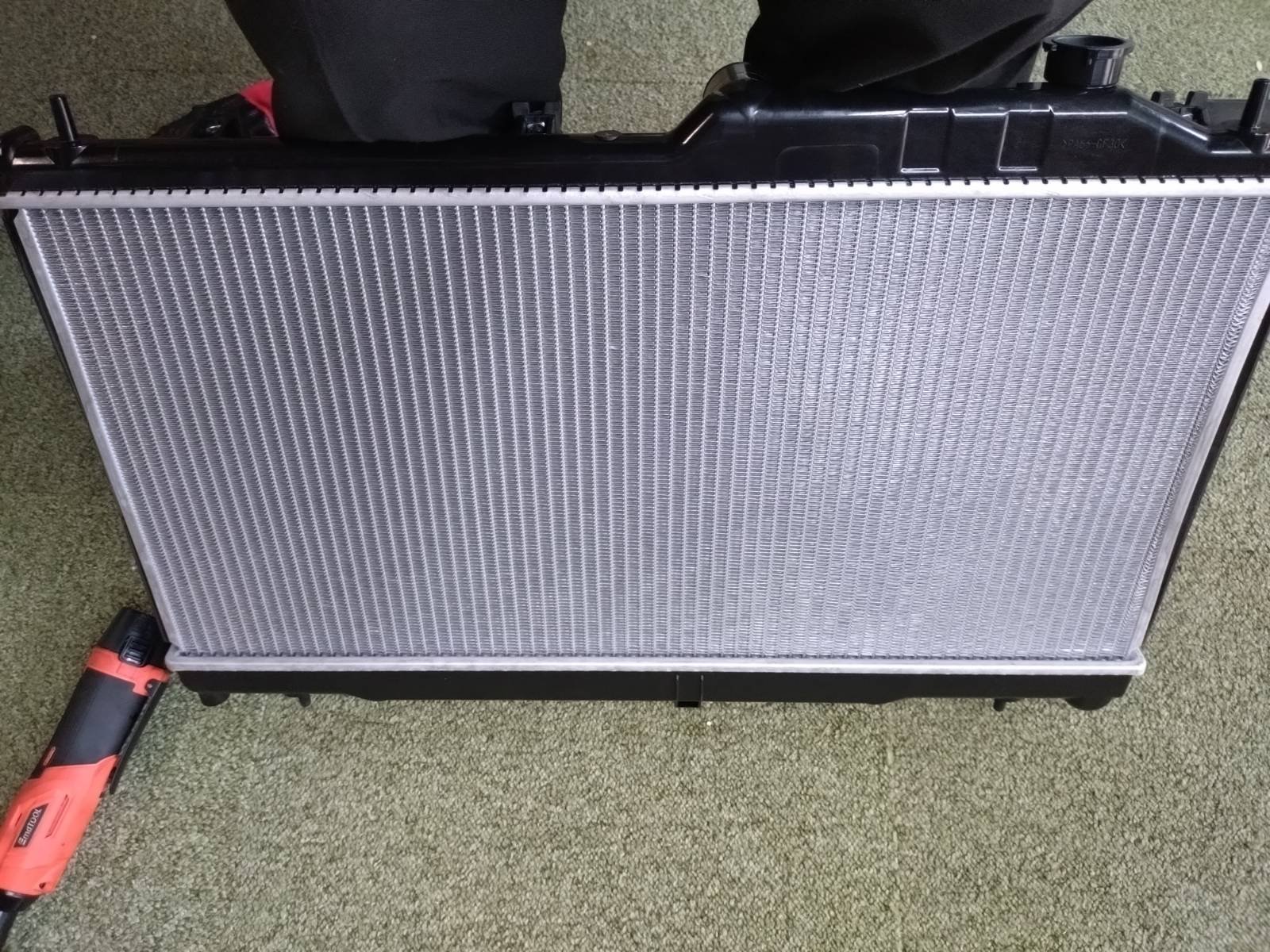

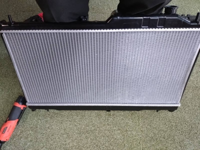

Then it was simply a matter of sliding the new radiator and fan assembly into place and tightening the mounts. Then I released the mounts and slid it back out having forgotten to replace the thermostat while the radiator was out!
The thermostat was then replaced and the cap refitted following a good clean of the hose connector surface to ensure a good seal with the new hose. I then put the radiator assembly back in again and fitted the top mounts. I felt the new radiator top pins were a tad lose inside the rubber bush mounts so I added a couple of O rings to the pegs to make them more snug. I then plugged back in the two fans, fitted the new bottom and top hoses and then refilled the system ready for bleeding once I had dealt with the power steering.
The power steering suction hose clamps came off both ends with no difficulty at all and I disconnected the pump end first to drain the oil into a container and thus empty the reservoir. Once drained I removed the hose and then undid the pump end connector to replace the O ring inside. That done I put it all back together with the new hose and clips and refilled the reservoir ready for bleeding once I got the car off the ramps.
Penultimate job was to refit the air intake chute and then run the engine up to temperature with the heater on full and my bleeding funnel installed to allow all the air to bubble out. After 6 minutes of running both fans switched in, good news, and then a few minutes more until there was no air bubbles at all. Switch off, insert funnel plug into the funnel and then remove from the radiator and return the contents to the coolant can. Top up the overflow bottle to the correct level and the job is done.
During the running I had been underneath to check all places for leaks and it was fine so the last job there was to refit the undertray. Having done that I reversed the car off the ramps and then gave it 4 cycles of lock to lock to bleed the power steering. The reservoir level dropped a tad below normal so a quick top up there and the work was done.
I took the car out for a test drive and everything worked perfectly and it actually felt a tad quieter all round!! Called into our recycling centre to offload the old parts and packaging and then came home to write this!! Happy days!!

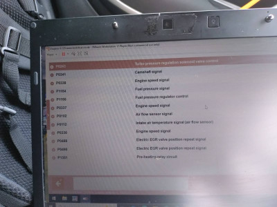

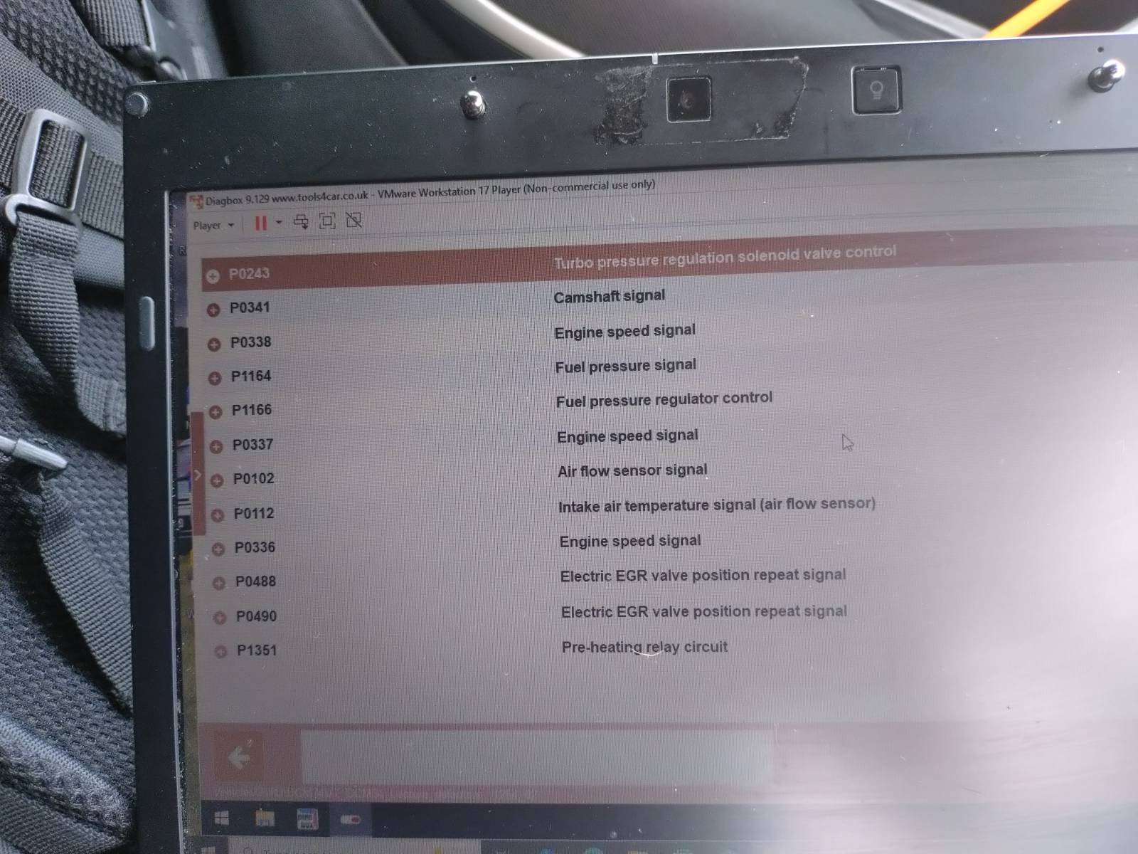

A diagnostic session followed which produced this fault list:

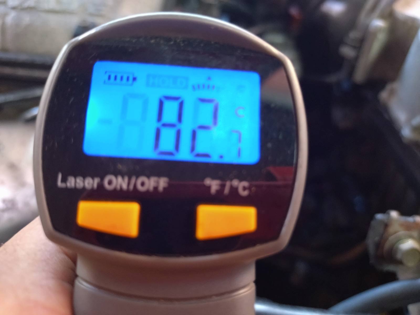

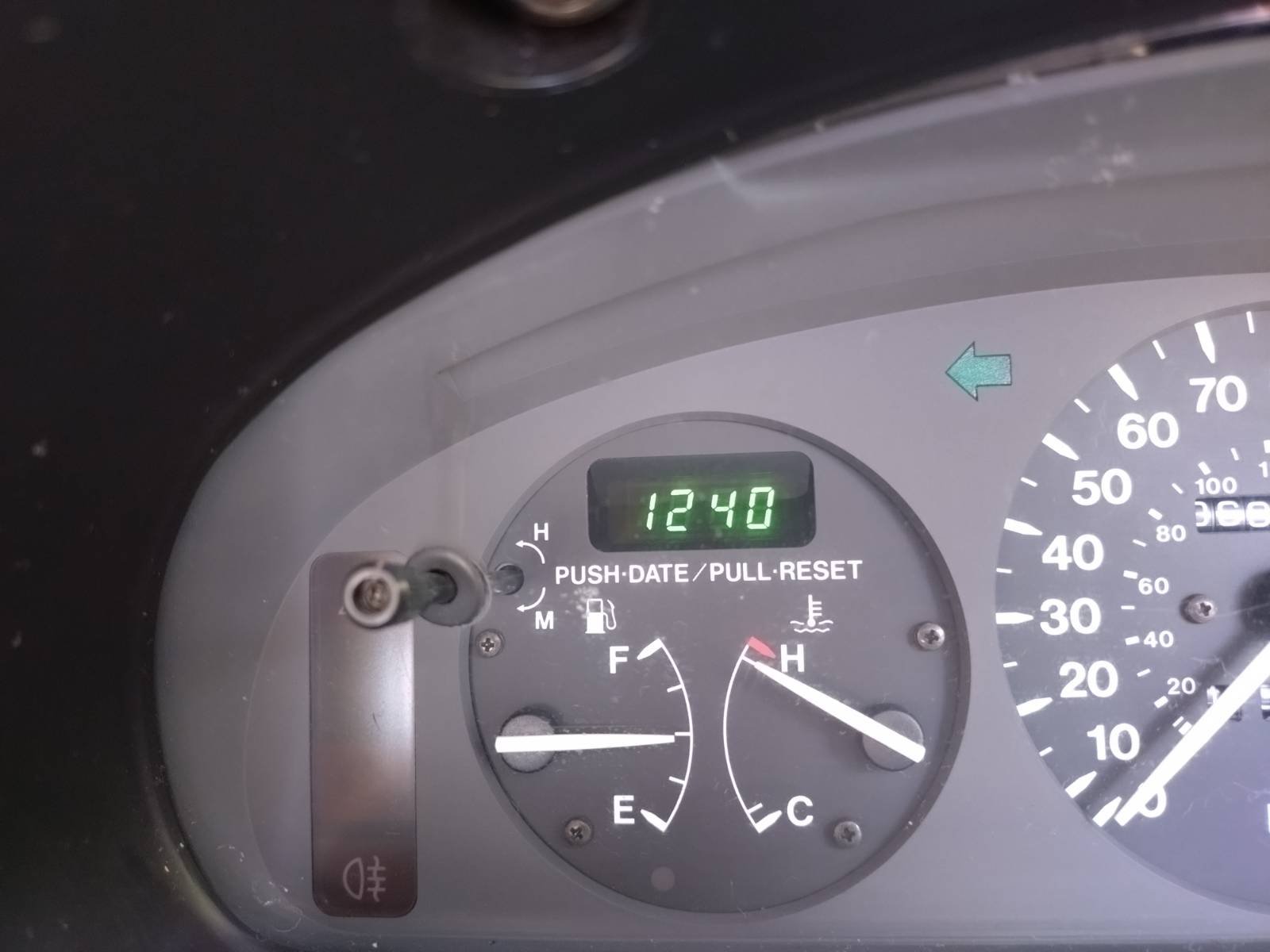

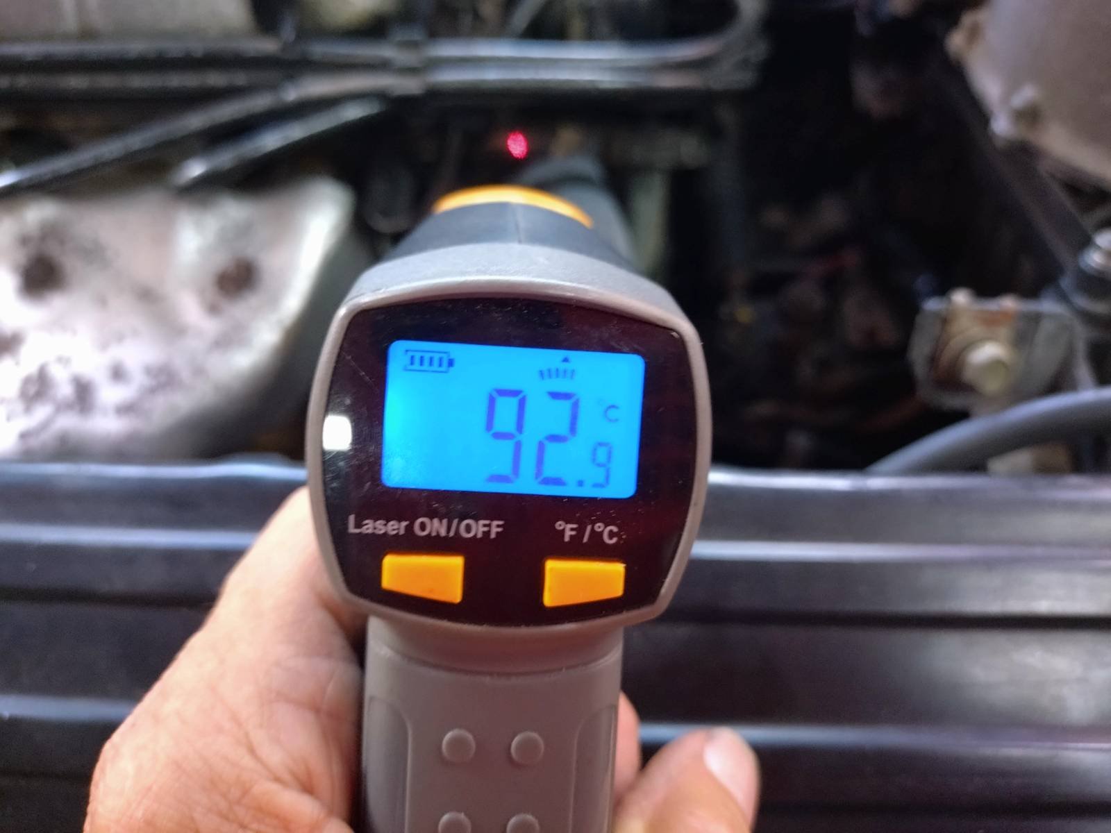

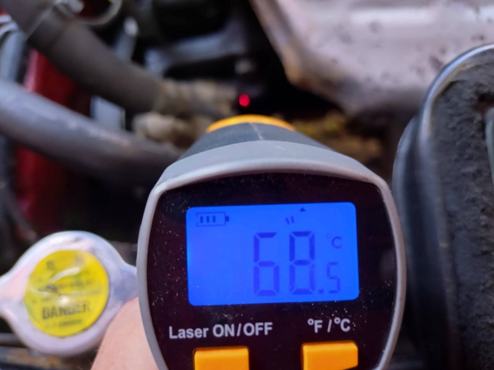

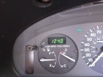

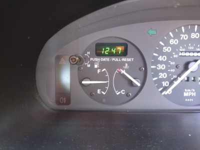

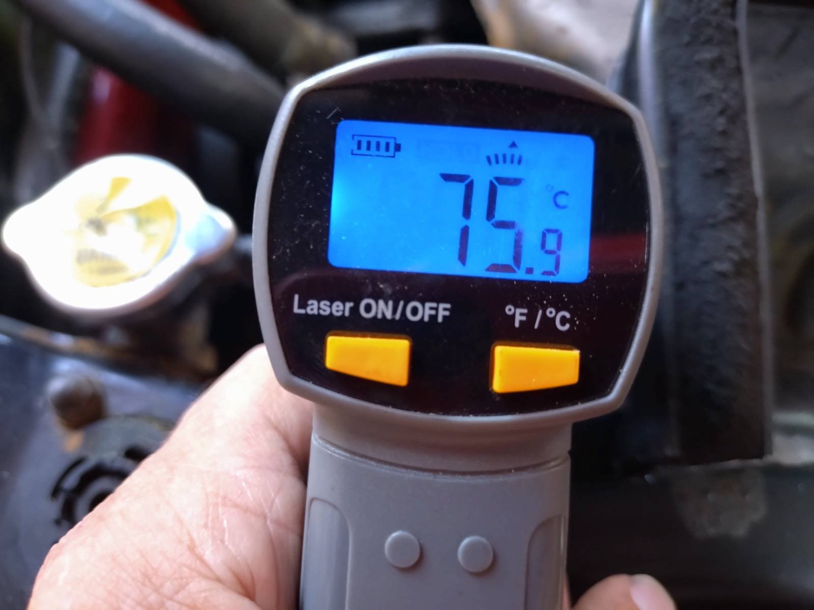

I ran the engine and the fan cut in and I watched the temperature guage, after 5 minutes I saw it head for the extreme and so I took the actual temperatue readings of the thermostat housing and the bottom hose connector metal pipe:

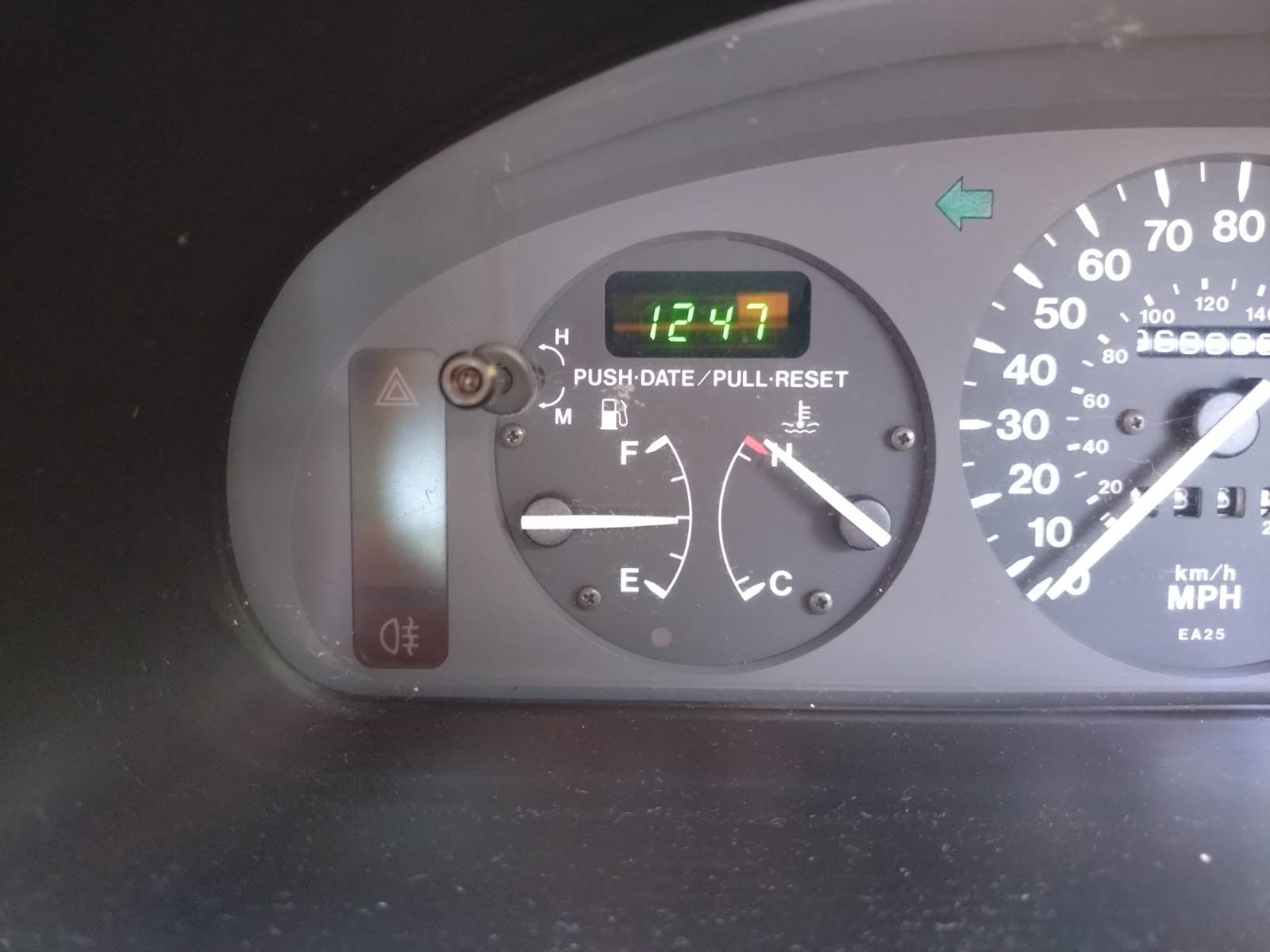

A bit mystified I ran the engine for another couple of minutes, with the fan running and generating a decent airflow, :
So all that leads me to think that the guage sensor has got its knickers in a twist so my next move is to replace it. If you have any other suggestions please feel free!!
