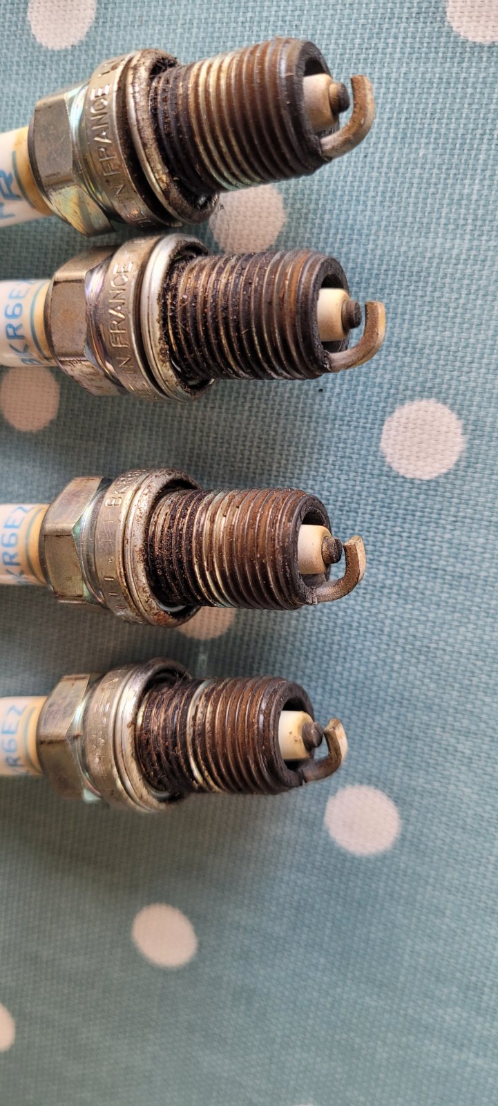

The plugs didnt really look like a rich mixture (they looked fine - ill attach a picture for others to comment on).
