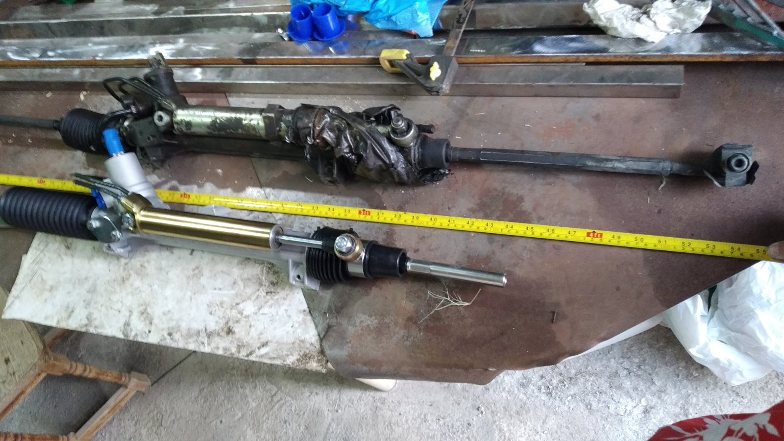

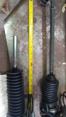

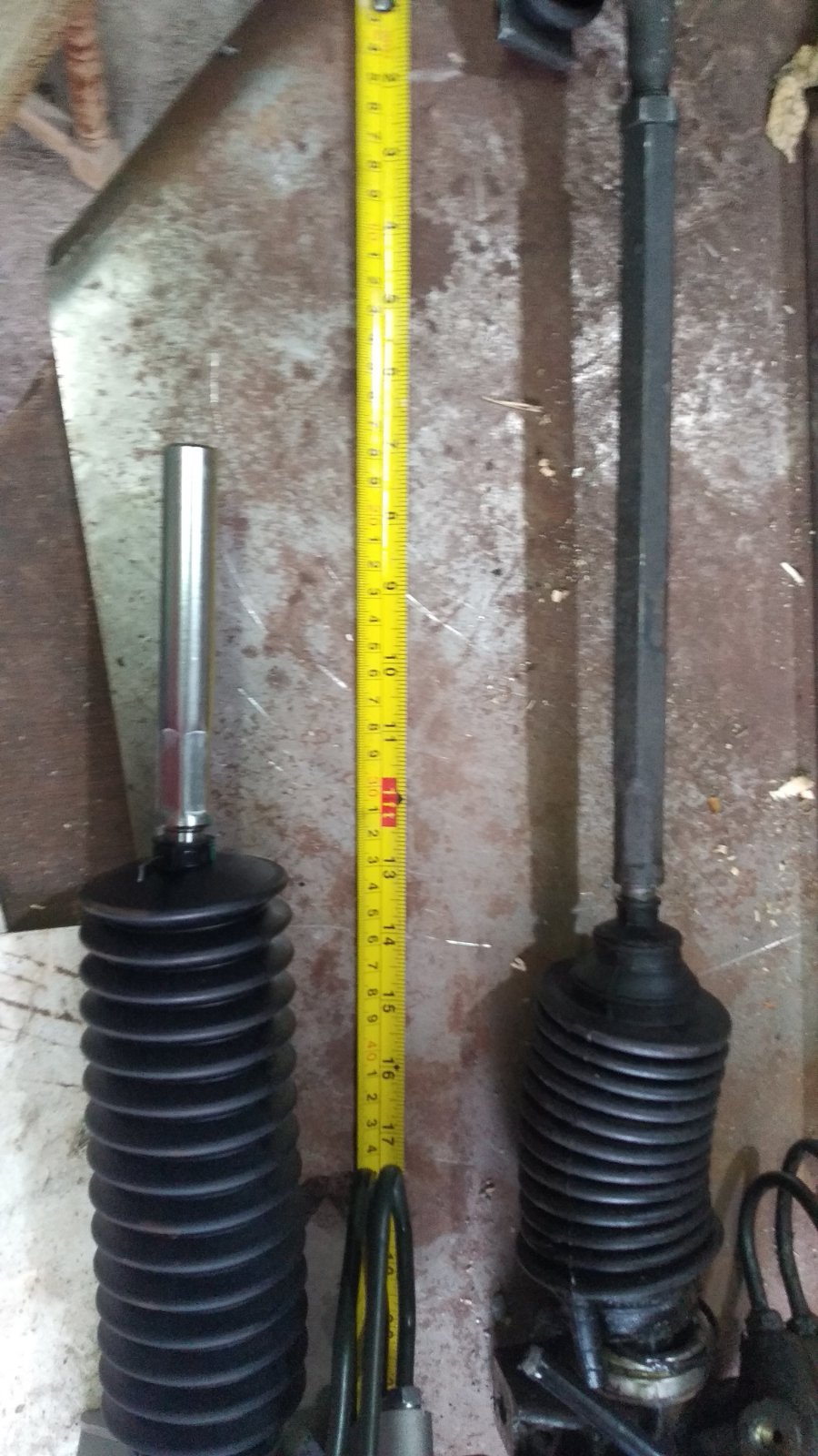

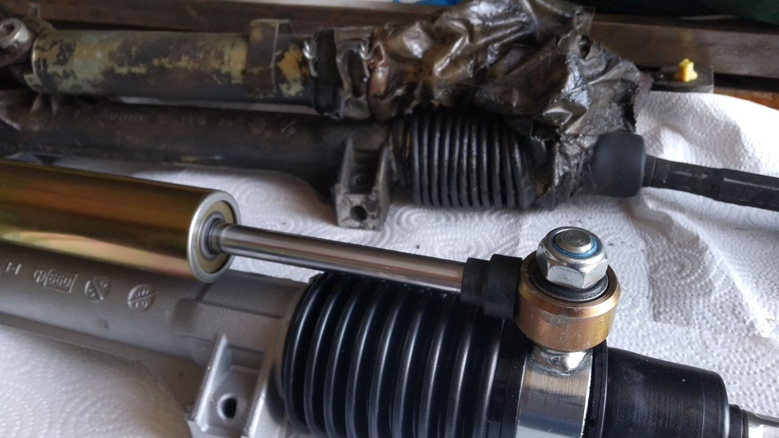

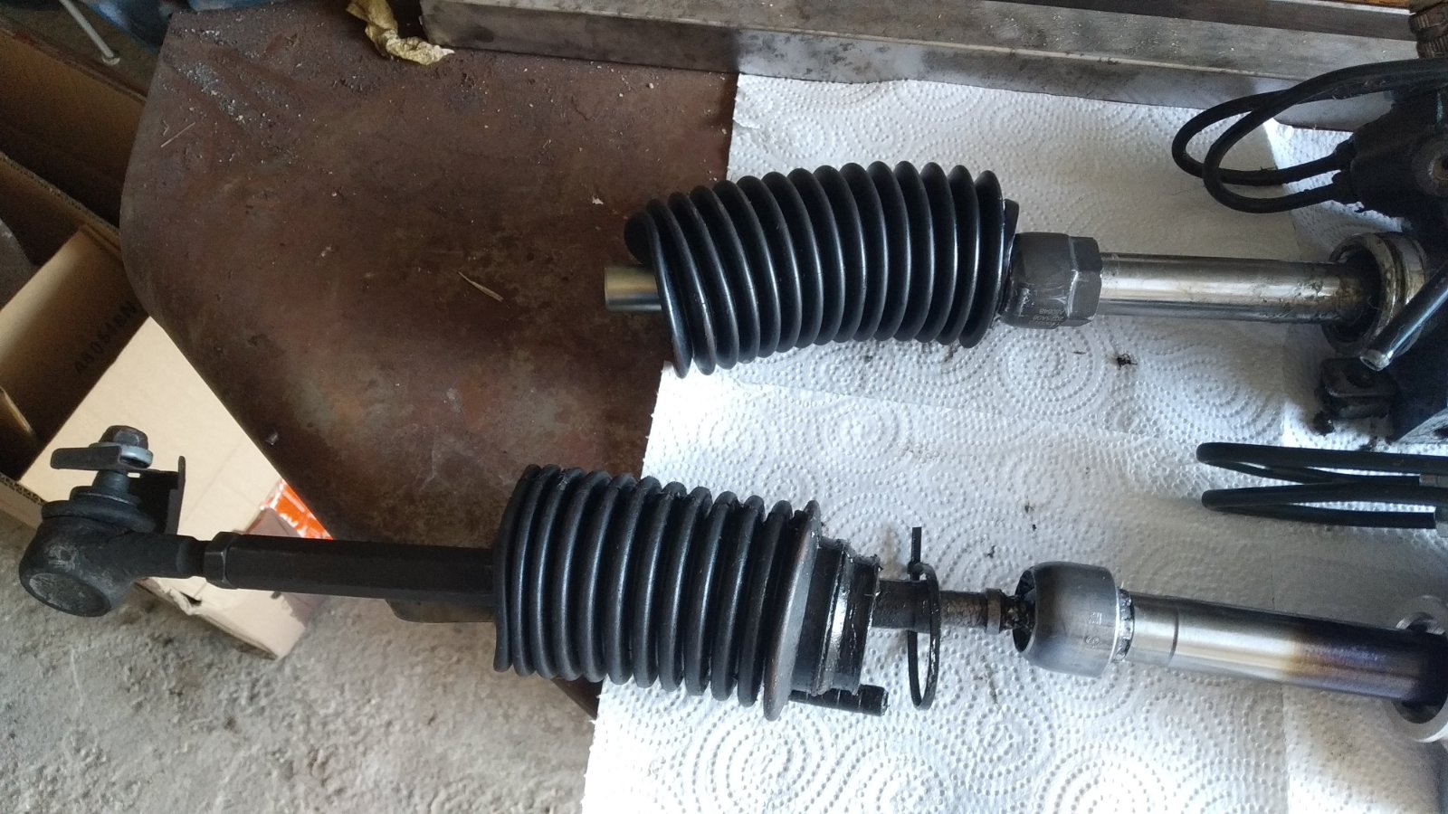

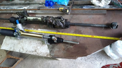

Aaargghh. New rack has arrived, quite quickly. Far too short though, several cms short of the track rod ends. And no way to tighten track rod ends up, originally rack has nut shaped end (new one is just round). Was I supposed to buy longer rods? Also there's an extra mounting point in the middle of the rack.

That's really bizarre Jaf :? Do Autodoc have suitable long Track Rod Ends to fit this style of rack?

It all seems rather odd. Does it look as if the rack will mount correctly?
It is also interesting that there was a RHD rack in stock in Germany.
If compatible, I would fit a pair of standard length rack ends.

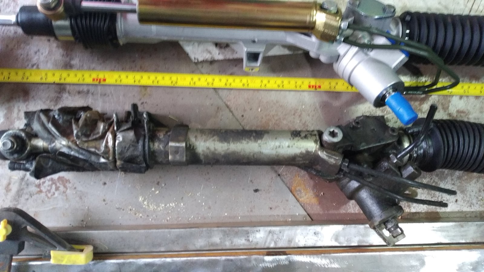

Good news... I took the easier side old track rod off and then carefully took off the new one. They exchange fine! So I could fit some nice, new track rods.

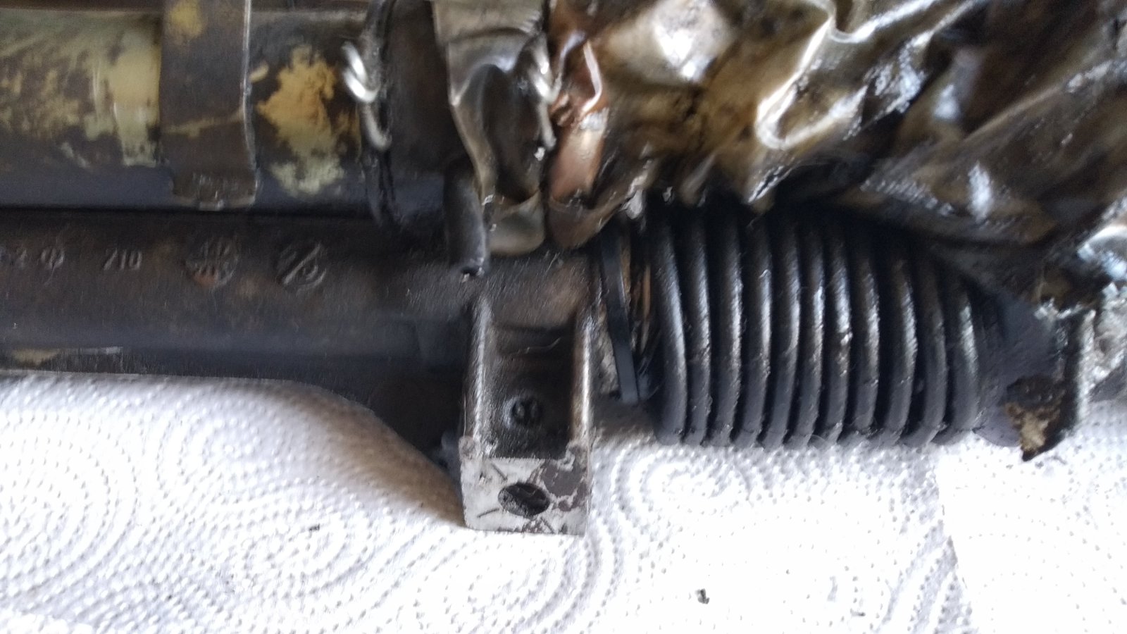

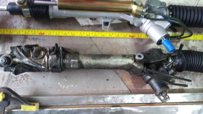

Bad news ... spotted a breather on the old rack that I'd forgotten about, on the ram. I'm thinking car needs that breather?
Arrrggghh!

Don't worry about the 'Breather' Jaf, it's the leakage return for the original style of ram and is not needed on the different design of the new ram. Just block off the pipe else LHM will drip from it...
Good to see the track rods will swap over and will allow you to go ahead with the new rack :D
